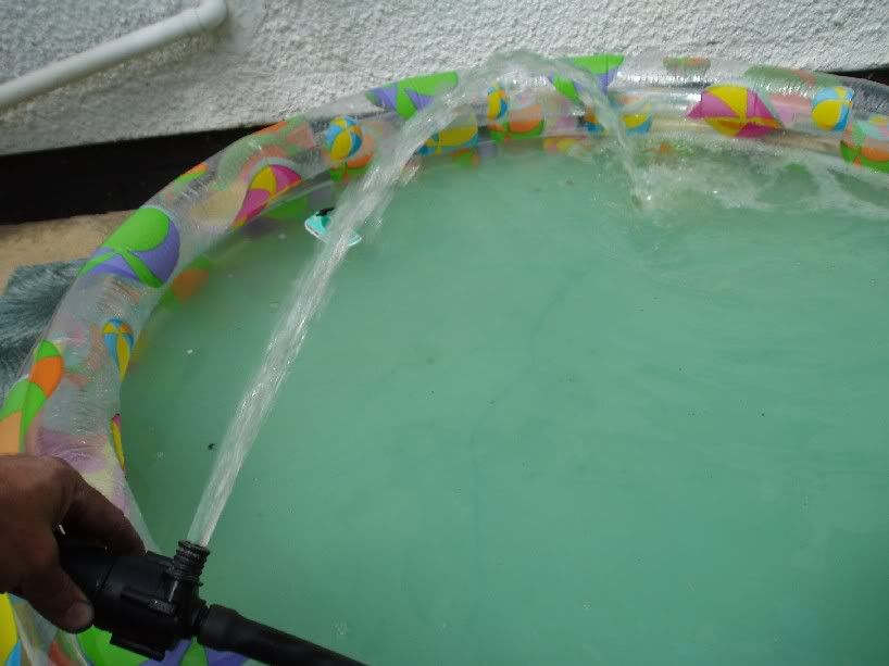

Wasn't Jon Flanigan using a heater pump from a Renault savanna that was running 28 L /min (unrestricted) with good results?
Yeah he was, somewhere there was a pic of him shooting water into a paddling pool with it
Im trying to find out what the flow rate of the one that i previously tried was
It was enough to keep it cool on idle, but when giving it some beans it couldnt cope at all
It was a merc one wasn't it? If so Andre tested one at 20 L/min?
Is this the pic you were after? *wink*
Edited by matty on 26th Dec, 2007.
thats the pic
And yes it was a merc one, ive been looking on tinternet at it to find the part no.
