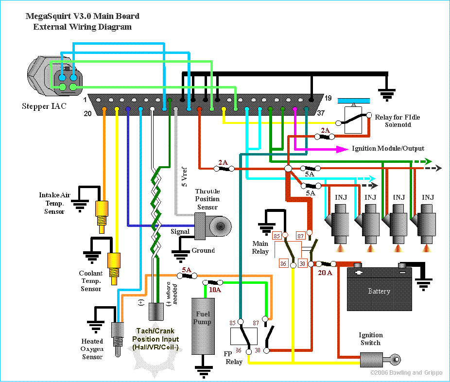

Both the VB921s are in the box and come out through the DB37 connector.
I've fitted an extra wire to connect SPR4 directly to the DB37 pin as recommended:
Edited by Paul S on 23rd Feb, 2008.
