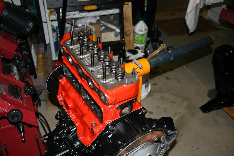

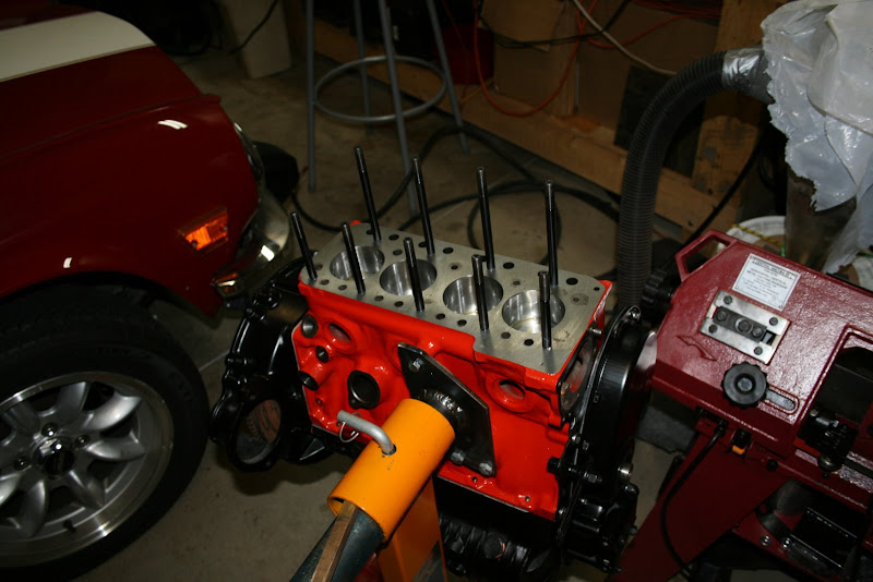

Got a bit more work done.

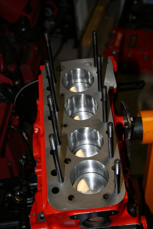

ARP studs installed.
Head installed.
Rockers were cleaned up, installed and head torqued.

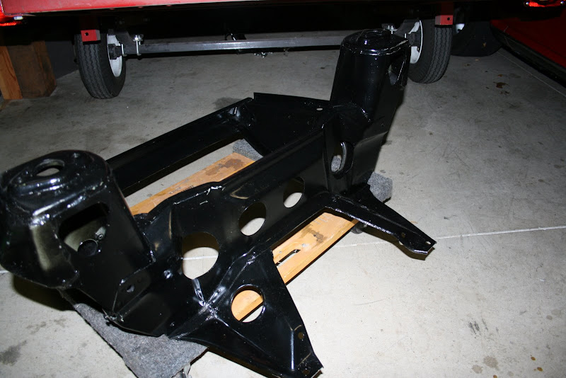

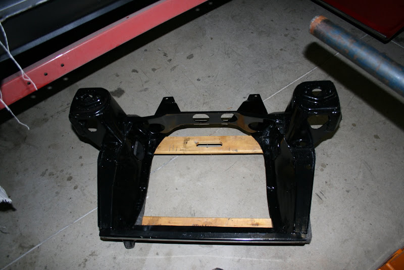

Front subframe is all painted and ready for the engine.

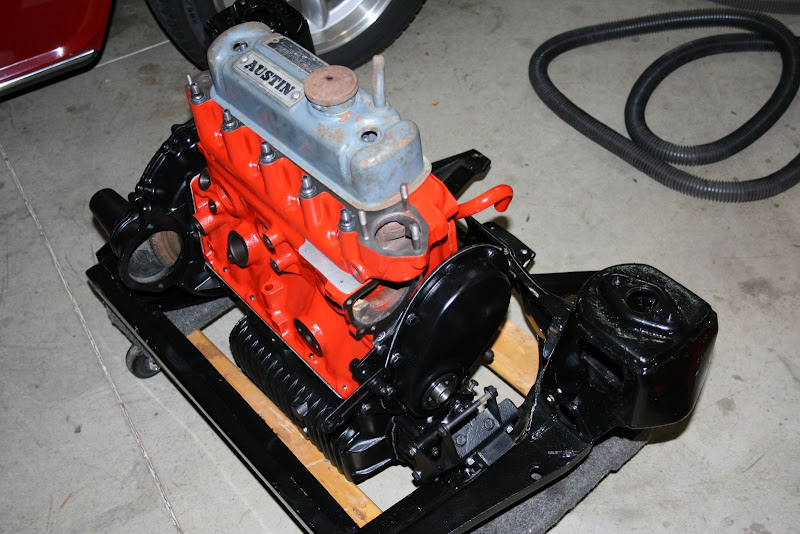

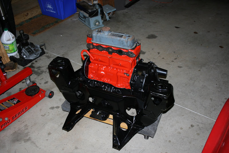

Time to remove from the stand.
Mounted in the front subframe. I decided to leave the valve cover gray for Vegard *wink*

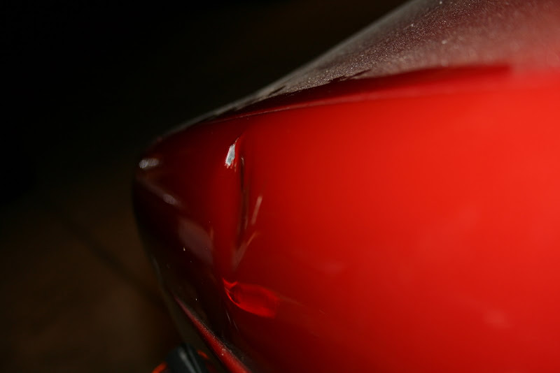

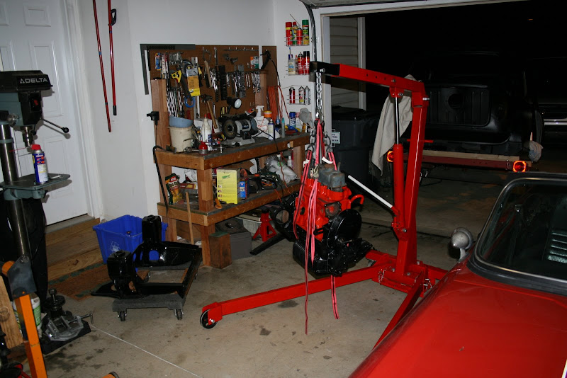

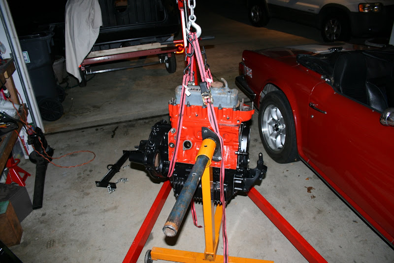

Overall I was pretty happy with the night, felt like I am making progress -- then CATASTROPHE! As I was folding the engine hoist up it tipped backward and crashed to the floor. One of the legs kissed the rear fender of my TR6! I guess it is just one more excuse to redo that one after the Mini *frown*
I also tried to put the freeze plugs in tonight, now that the engine stand is not blocking the holes -- they are a hair too small, meaning they fit perfectly into the block without any force. Has anyone ever encountered that? I am going to try a flatten them out a bit, to try to make the diameter slightly larger tomorrow.
