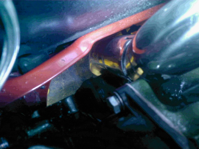

How tight? A nuns chuff? Got one of jasons heat shields here somewhere too, will give me an extra mm or 2
Shane
Pretty much a nuns chuff yeah - my plenum had actually started tapping the bulkhead before I swapped to solid engine mounts!

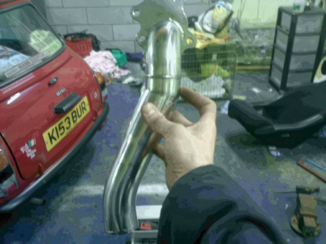

I use std length steadies, std subby etc and its tight but fits.
My downpipe had to be cut and shut a lot! i need to tidy it up when it comes out next month for a few bits of work.

No bat I dont have one, now going to go try fitting the carb and plenum less the steady and see what happens.

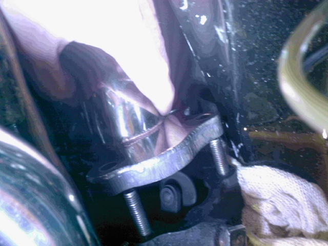

sorry mate no, because cut along the weld and add a bit more of a wedge out.
also i shortened the turbo elbow and the down pipe to get it further up so the curve was closer to the floor pan.
I'll get some pics in a few weeks when it comes out. it needs some more work really.
shane
2646 Posts
Member #: 1246
Lowestoft, Suffolk.
I started chopping the down pipe about last nite, decided to wait till my exhaust turns up, so Ive got a point to work to, but I have had the same thought to what you have just mentioned, so at least i know im on the right lines. You can see by how far the studs are out when the set in the down pipe is where it needs to be to clear the pot that there needs to be an adjustment to the elbow.

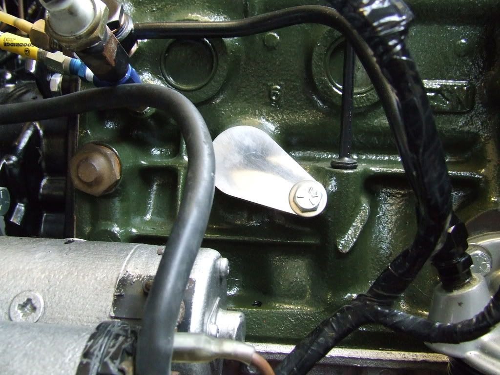

Progree has ground to a hault this week due to waiting for so many parts, some finally arrived so heres the update.

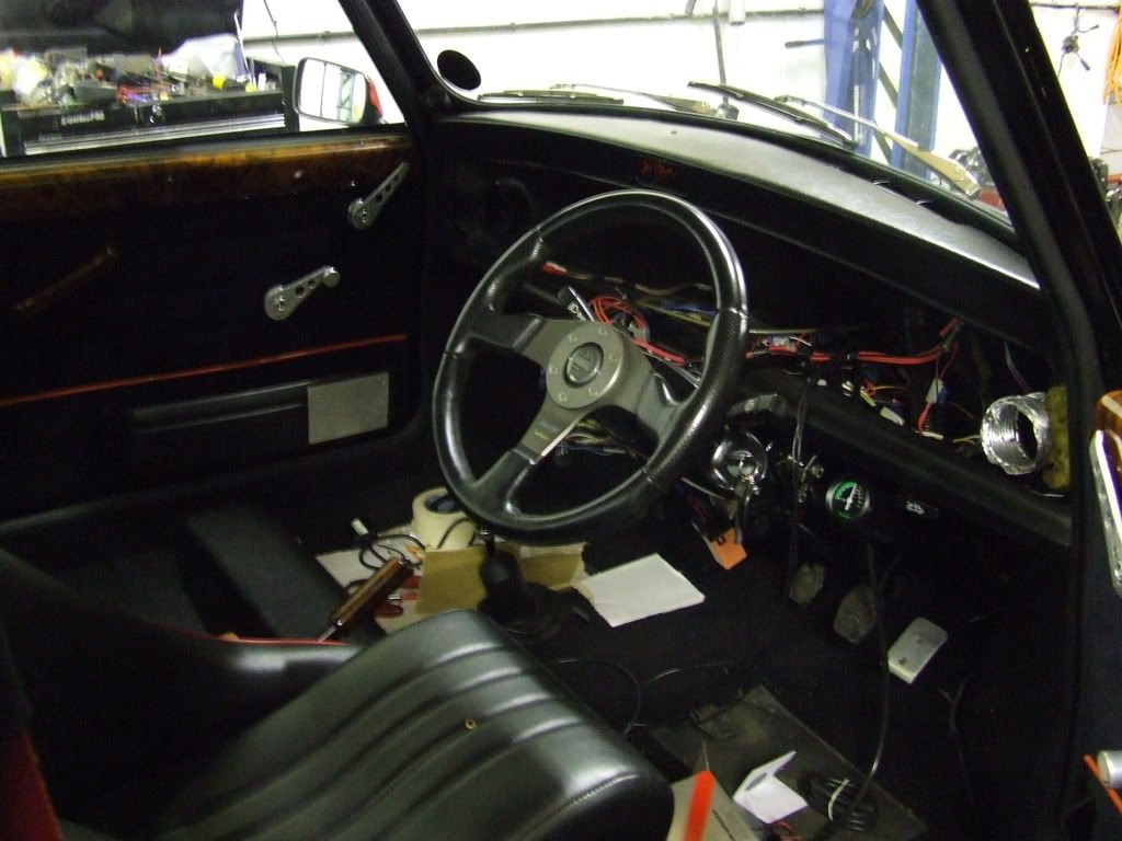

Coil pack bracket made up and fitted ever slave cylinder, will have to rethink this when I finally do the pre verto conversion, but will do fo now.
MJ cables nearly all in, just need to decide where the lives are coming from, and mount the edis etc.

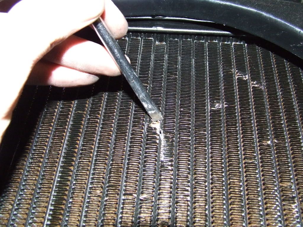

To top my eve off I managed to convert a brand new unused minispares 2core rad into scrap by dropping a grille on it, not happy!!

ouch, nasty about the rad and poo about parts! im waiting on parts too, 2 weeks now :( over than that mate looks top notch!!
shane
2646 Posts
Member #: 1246
Lowestoft, Suffolk.
If the rad and a few parts take their time and thats the worst that happens then im doin well. Just getting worried im running ut of time!
Shane
no way of repairing the rad?
I'm suprised yo managed to knacker the rad that easily, the tube are fairly sturdy.
shane
2646 Posts
Member #: 1246
Lowestoft, Suffolk.
I wish there was, its well pierced, got stuffed by a raggy sharp edge, wouldnt mind if it had been used, lol
Shane
send it back and say it was damaged by the courier?...
shane
2646 Posts
Member #: 1246
Lowestoft, Suffolk.
Lmao, now theres an idea, can imagine the conversation now, "can you explain Mr pearce why you have sent a radiator back that you purchased over a year ago and have had painted, claiming it was damaged by our currior?" Shame it wasnt that easy, I built the engine up last winter, and bought it then, shame, lol

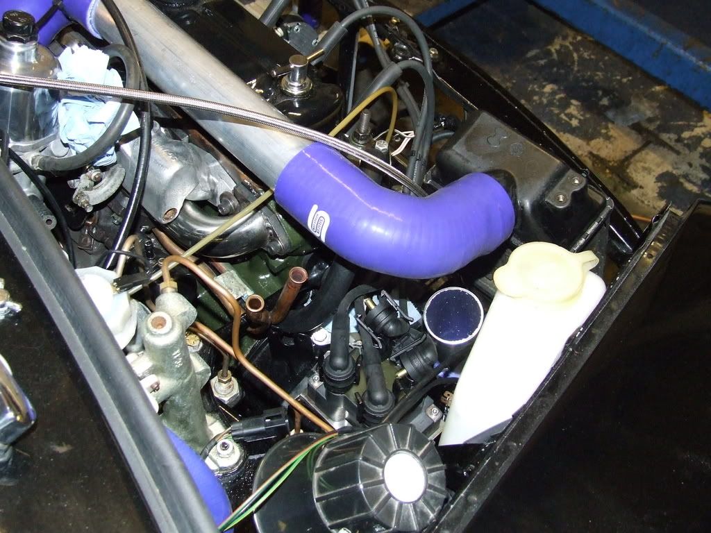

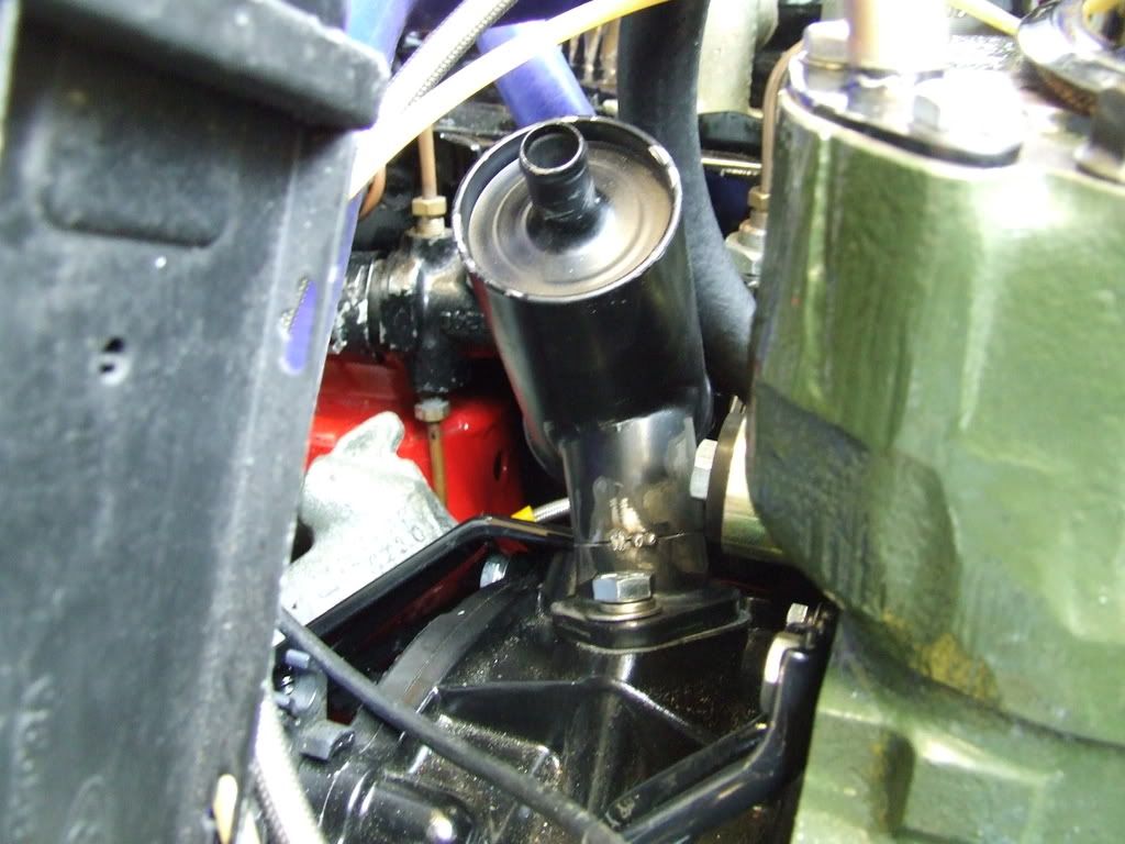

Had the last two days off, and have spent the afternoons playing with the car, and progress is as follows.

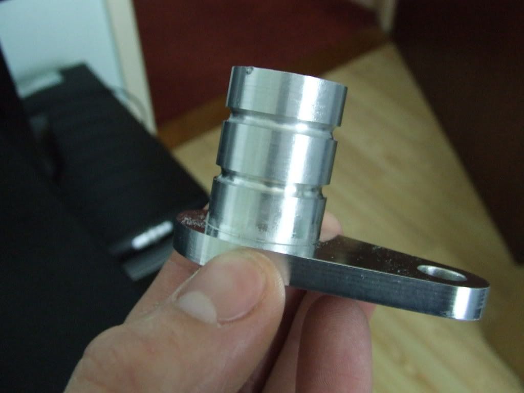

A birthday prezzy off one of my mates, fits a treat and is nice and shiney!

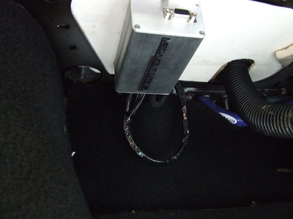

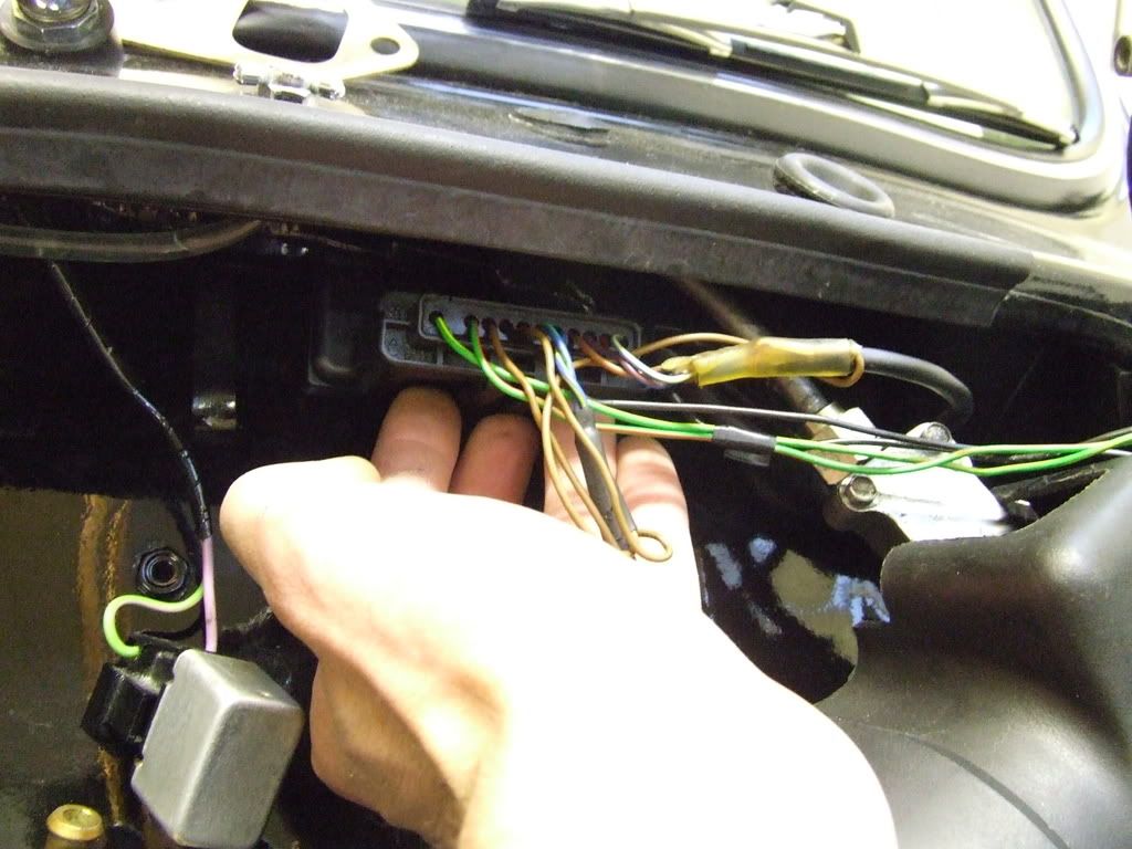

MJ is now mounted and wired less 12v supply and tacho.
Crankcase breather now sorted.
And the plenum is now fitted, next am planning to mount the fpr, and plumb all the fuel and boost side of things in.
Im still waiting for minisport to pull thier finger out and sort/send my exhaust and oil, as soon as these arrive then I can sort my downpipe issue, then hopefully spin her over.
Shane

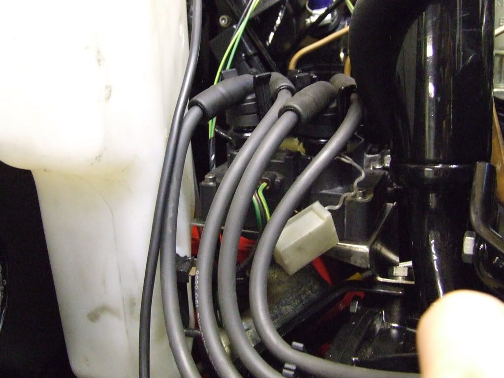

Run a feed direct from the battery (via a relay).
shane
2646 Posts
Member #: 1246
Lowestoft, Suffolk.
Im just going to remove the ballest resistor wire from the ignition switch and take it off there, just got a few other little jobs to do before i can get on to that.

Si P
784 Posts
Member #: 912
North Yorkshire
Just did the same MJ Feed/supply with mine. The Ballest resistor runs all the back up the loom to a point were it joins the White ingnition wire. Remove and replace. also worth a 5amp inline fuse for the MJ. And 15amp for the EDIS.

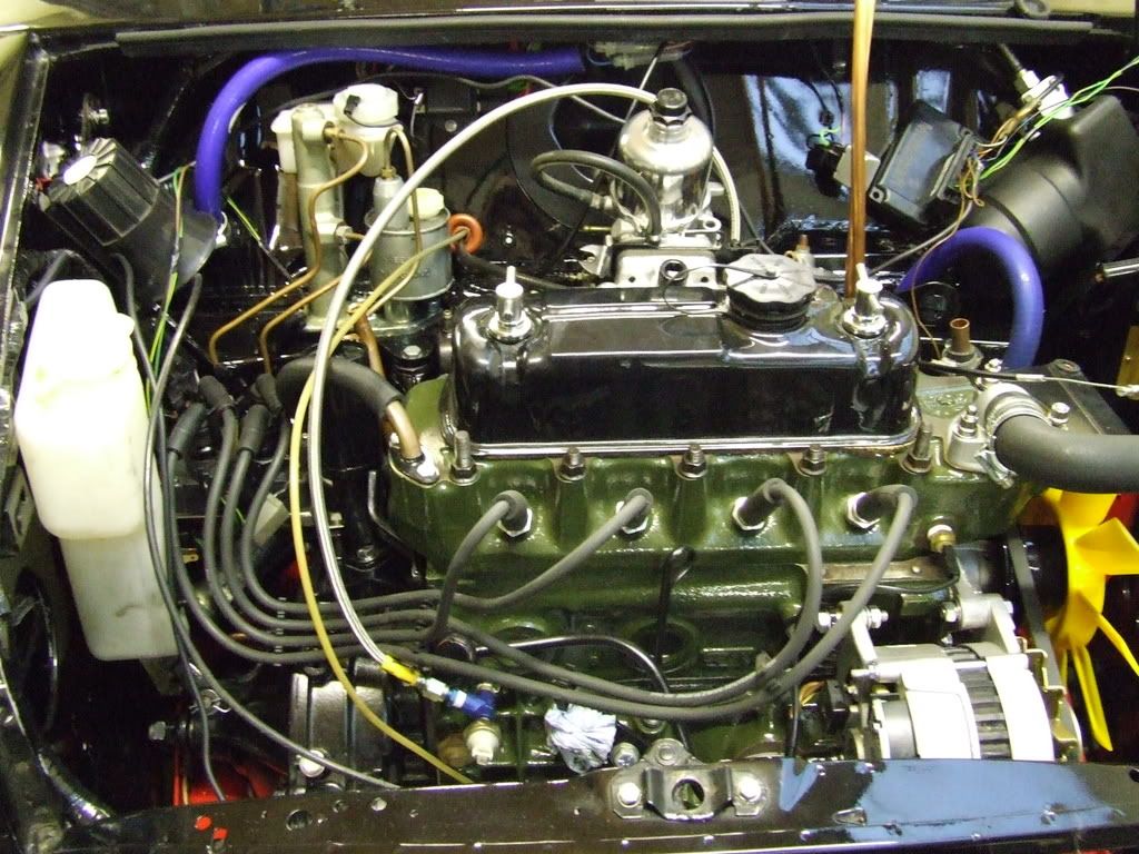

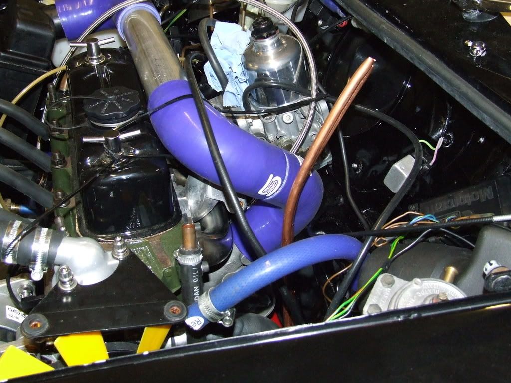

Member #: 1246
Lowestoft, Suffolk.

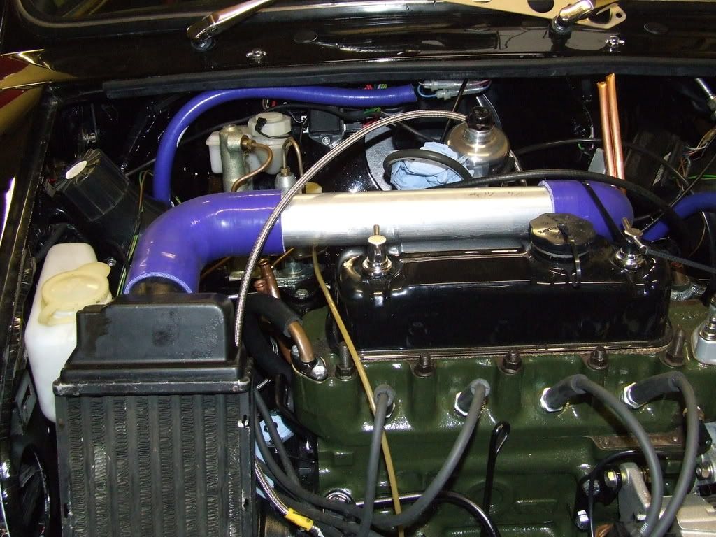

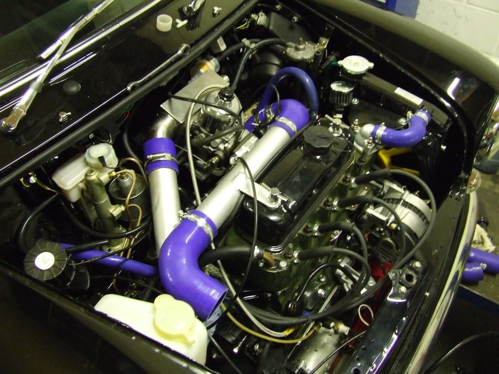

Managed to get a fair bit done this weekend, which has supprised me as I spent ost of the day at work yesterday. Most of the stuff in the bay is now all in and tightened up and staying that way!!! (the amount of times the manifold etc has been out is unreal) New rad is in, and this one made it in in one piece! Turbo elbow and down pipe are all welded back together and are in, all the is left to be done id fabricate a clam to support the down pipe.
The IC is out for a lick of paint, but when dry that can now be fitted and stay there. All fuel hoses are cut to length, just couldnt get any jubile clips today, son as I have them thats the pipework done.
Other jobs left erm...... wire bleed solenoid, and relays for fuel pump, and light for the boost gauge.
Then after I have proved the MJ works (will be tested off a spare battery for the supply before I start connecting it into the car loom) I just got to put this lot to rights.
Still need to swap hubs and brakes over for the 8.4" Fit the new cylinder head which is in uncle steves capable hands, then its time for the rollers!
Still loads to do lol!
Shane
