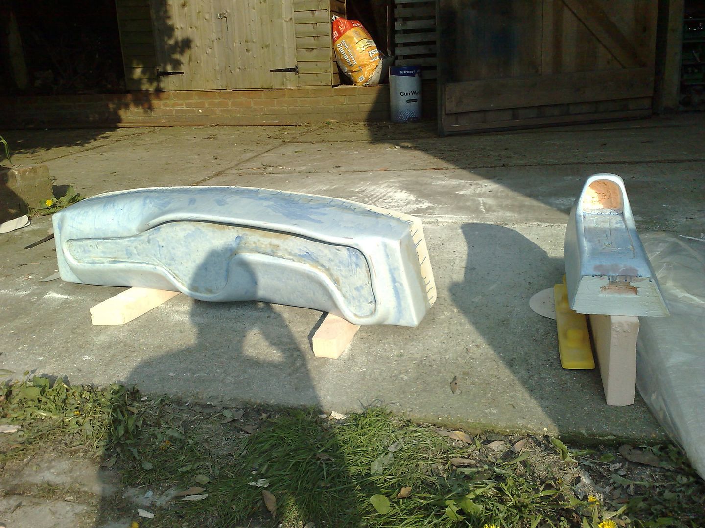

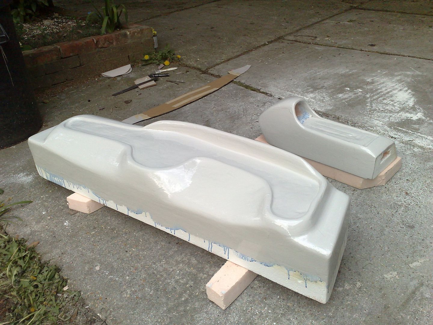

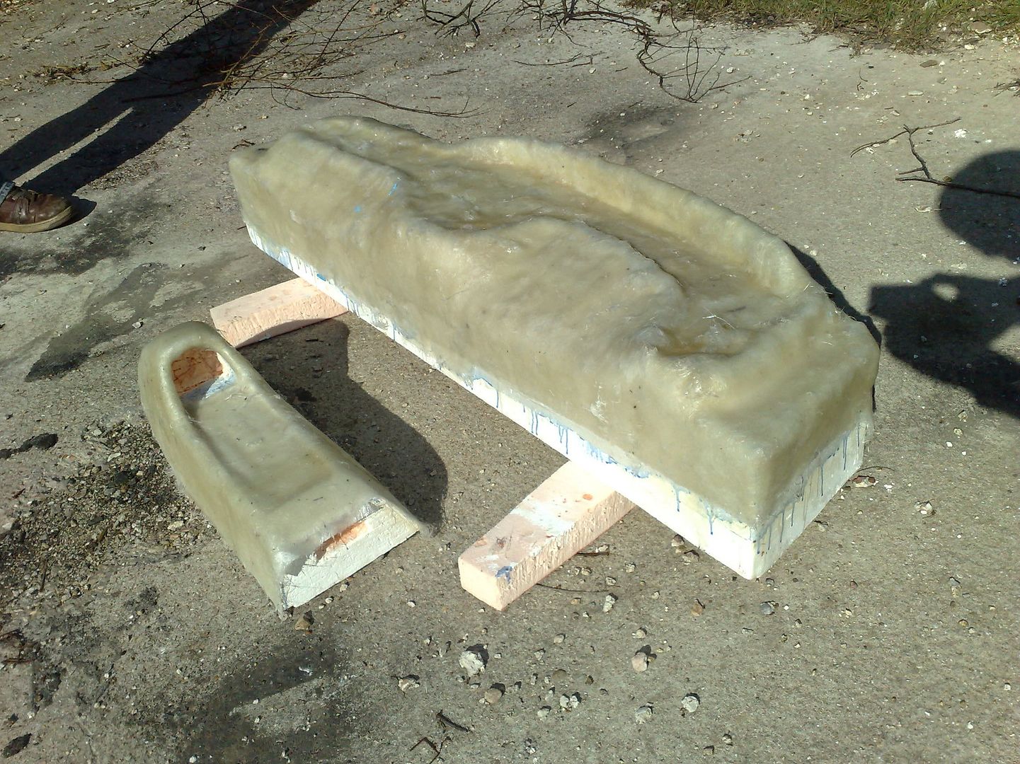

Howdy chaps,
Made abit of progress with the dash mould today.
Waxed and PVA'd the foam plug.
Gel coated it.
My poor attempt at fibreglassing it.
To my suprise it actually came out really smooth!
So tomorrow I will be seeing if the mould actually works!

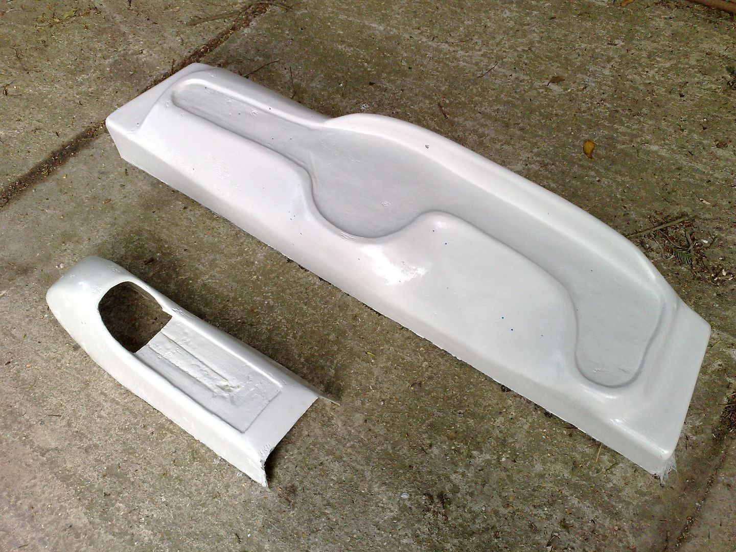

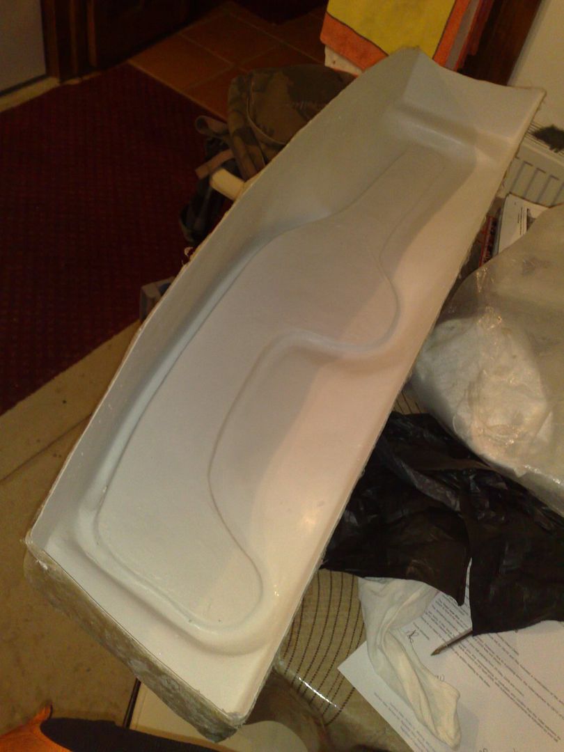

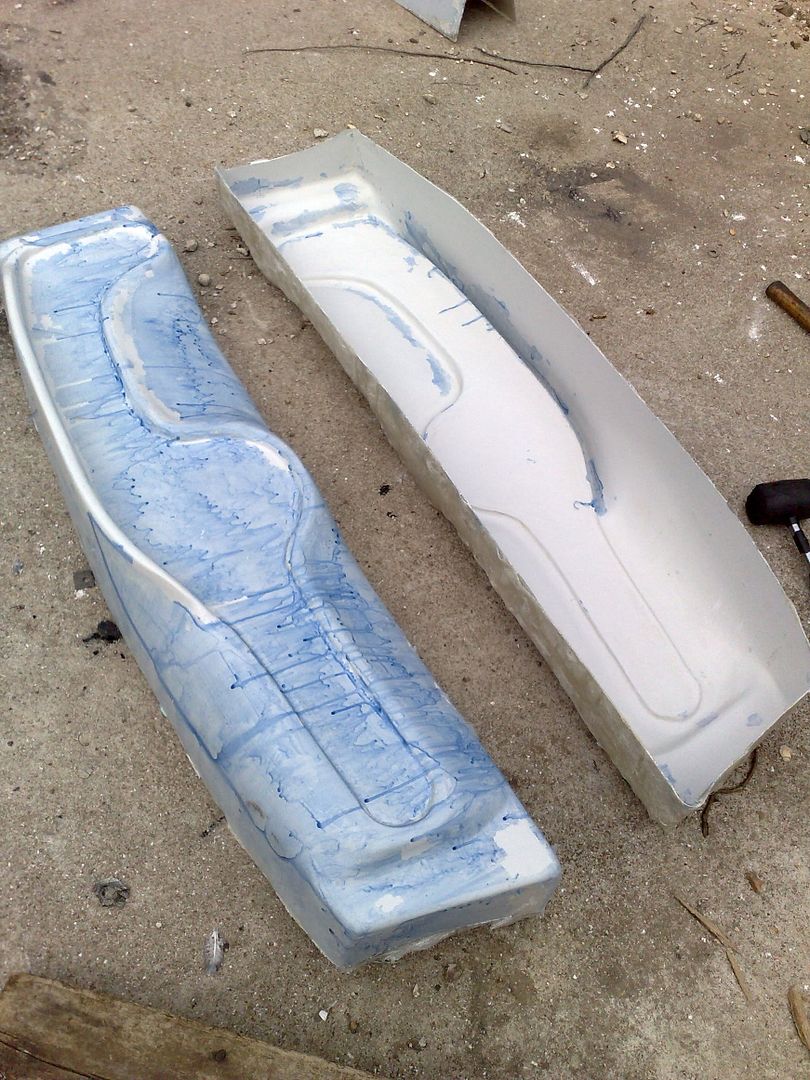

Pulled the final moulds out today, came out alot better than I thought they would.
For some reason the gelcoat went abit gay and bubbled in places.

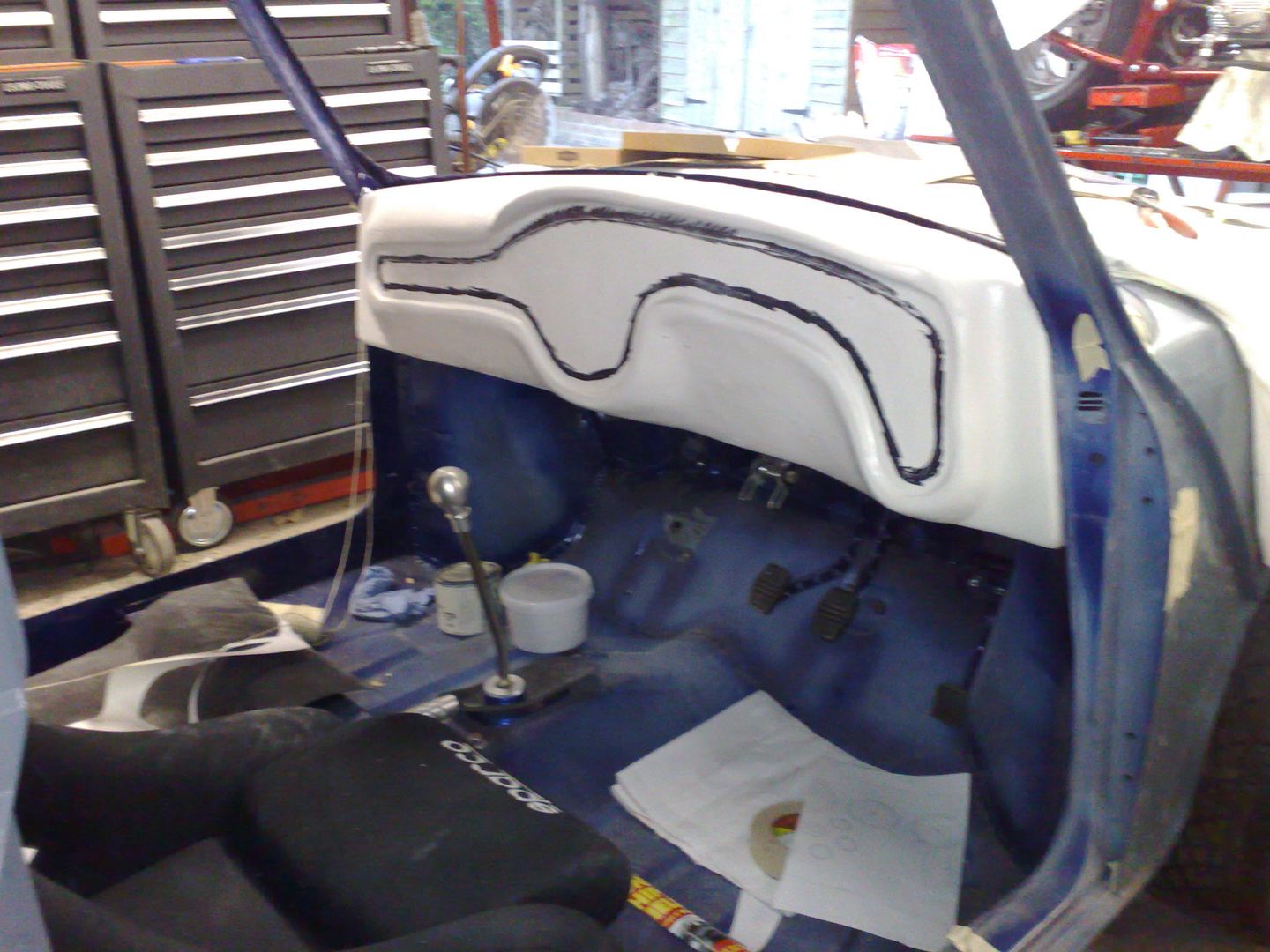

Hi guys,
Just thought i'd show you the dash now its all together. I havnt had time to cover it in leather so sprayed it black for my presentation day.
On 25th Apr, 2009 Brett said:
did that just fit in there with no tweaking? lol looks good,
It needed cutting at the top and sides, to fit over the dash rails properly.

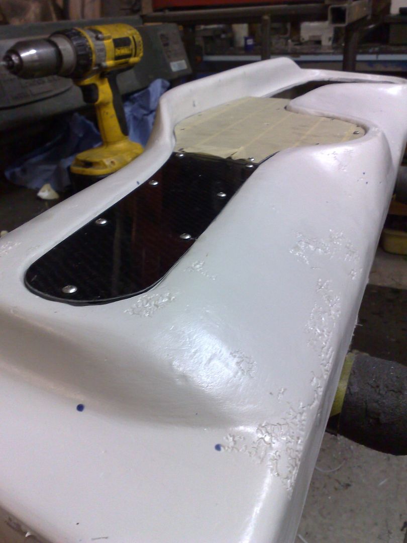

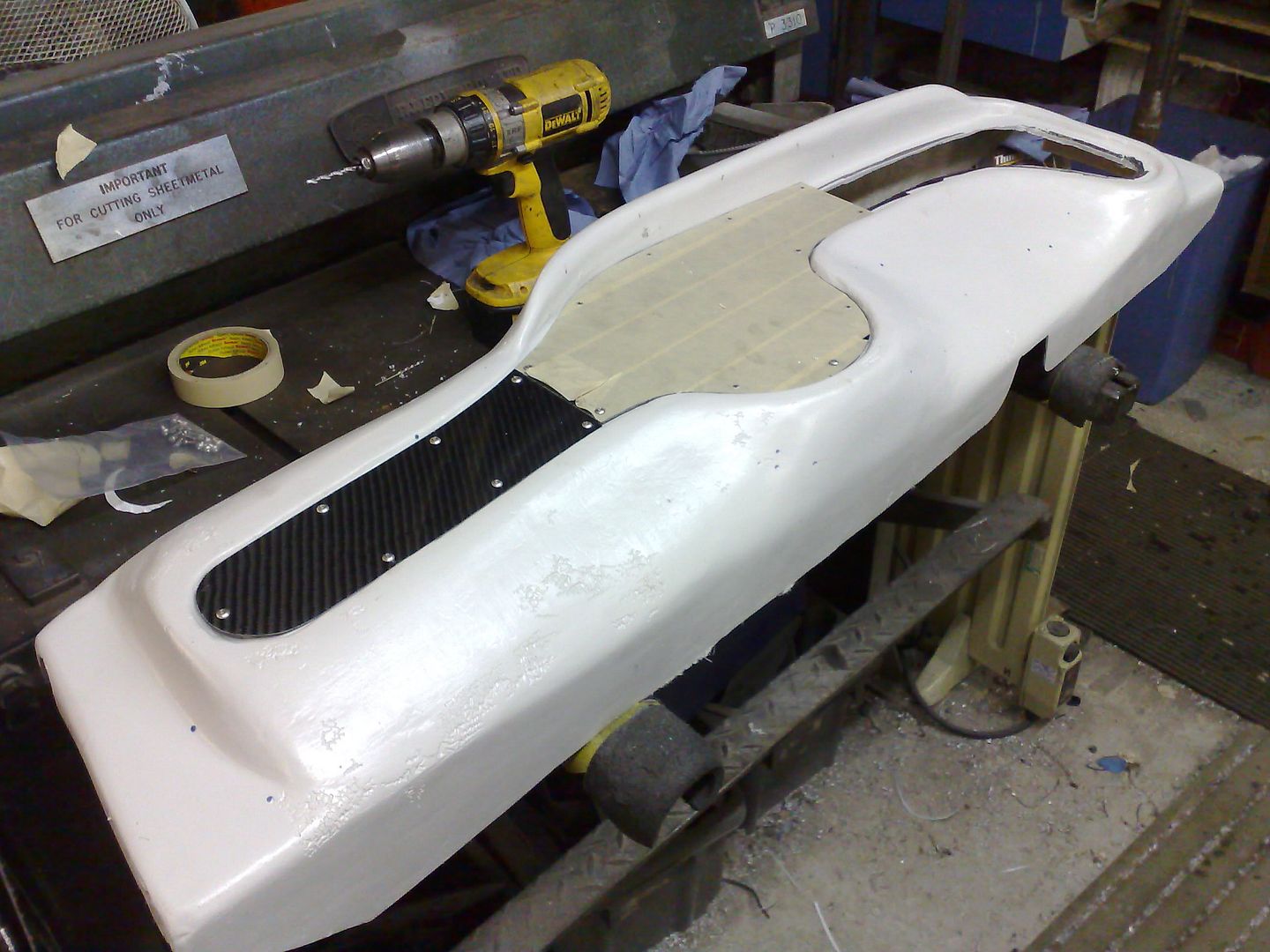

Ben. Is that real carbon shee you have used for the inserts or just carbon effect? Either way where did you get it?
