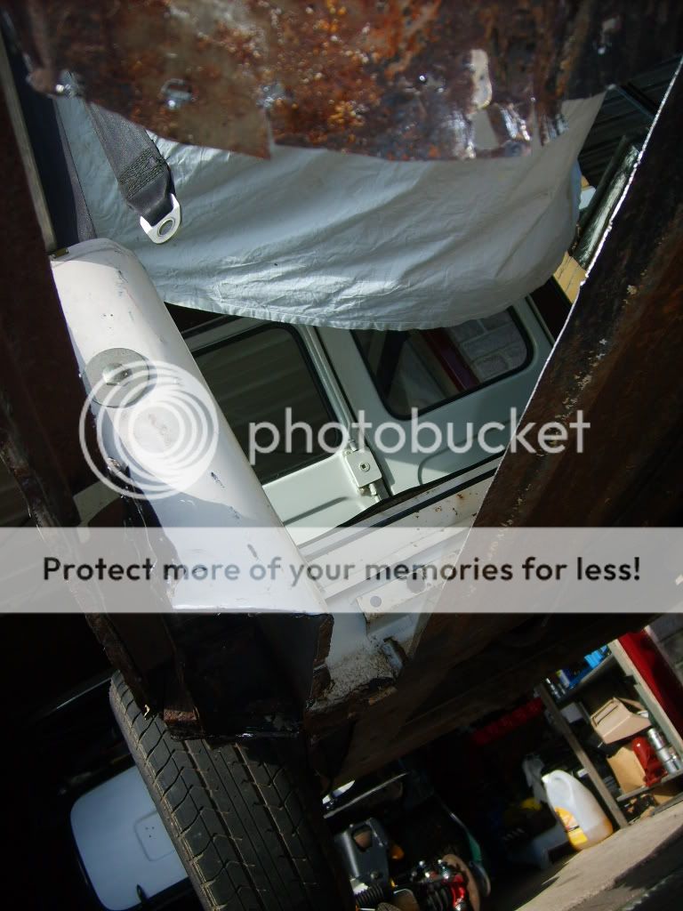

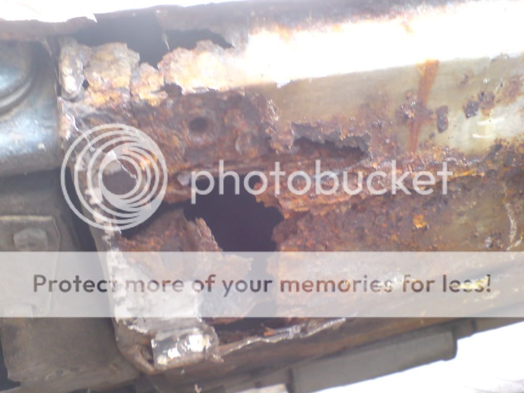

Well after more cutting and rust removal this afternoon, im feeling pretty low.
Because of a previous owner making such a fucking bodge job, i know need the following panels: an extended door step, e.g goes all the way to the wheel arche, and a pocket base.
And because im skint and the moment it looks like i have another mini, sat doing shit all.
I'll try and put some pictures up later on.
Rant over.

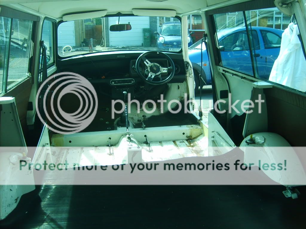

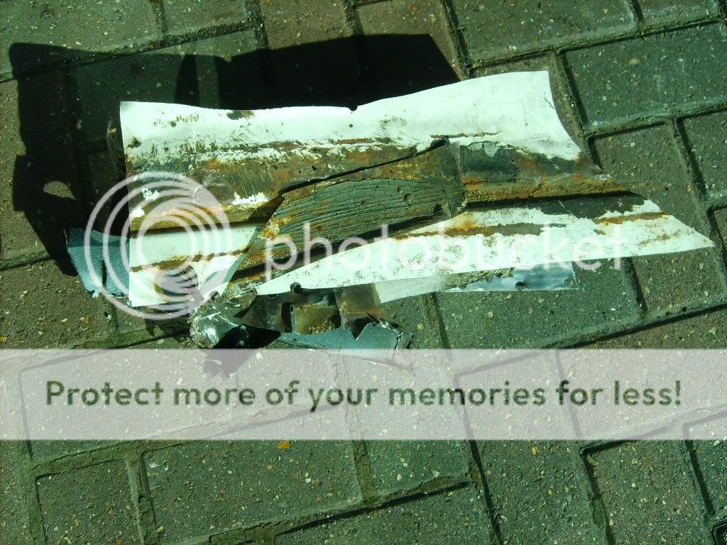

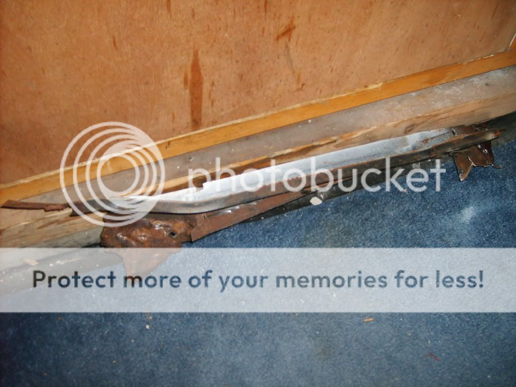

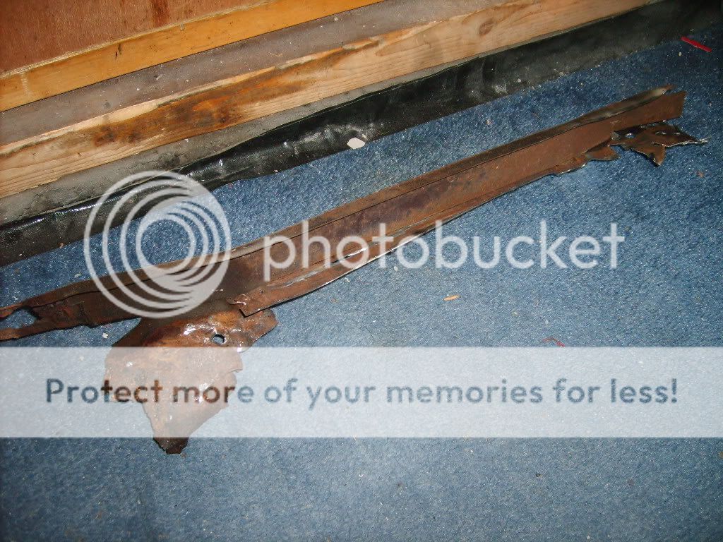

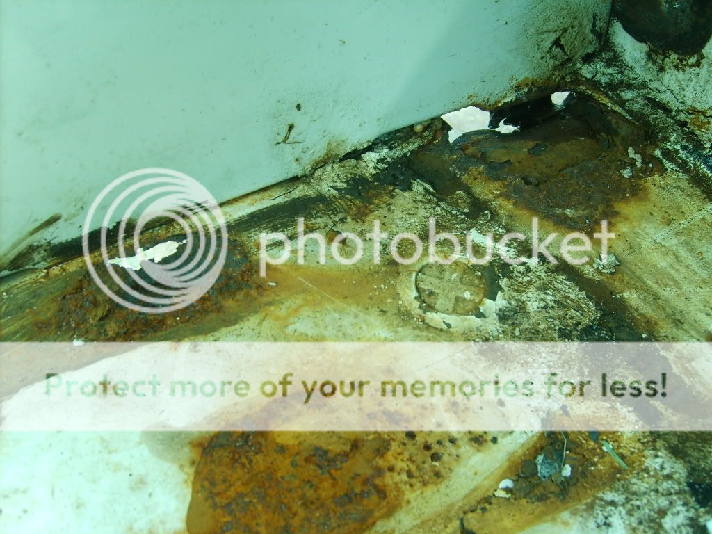

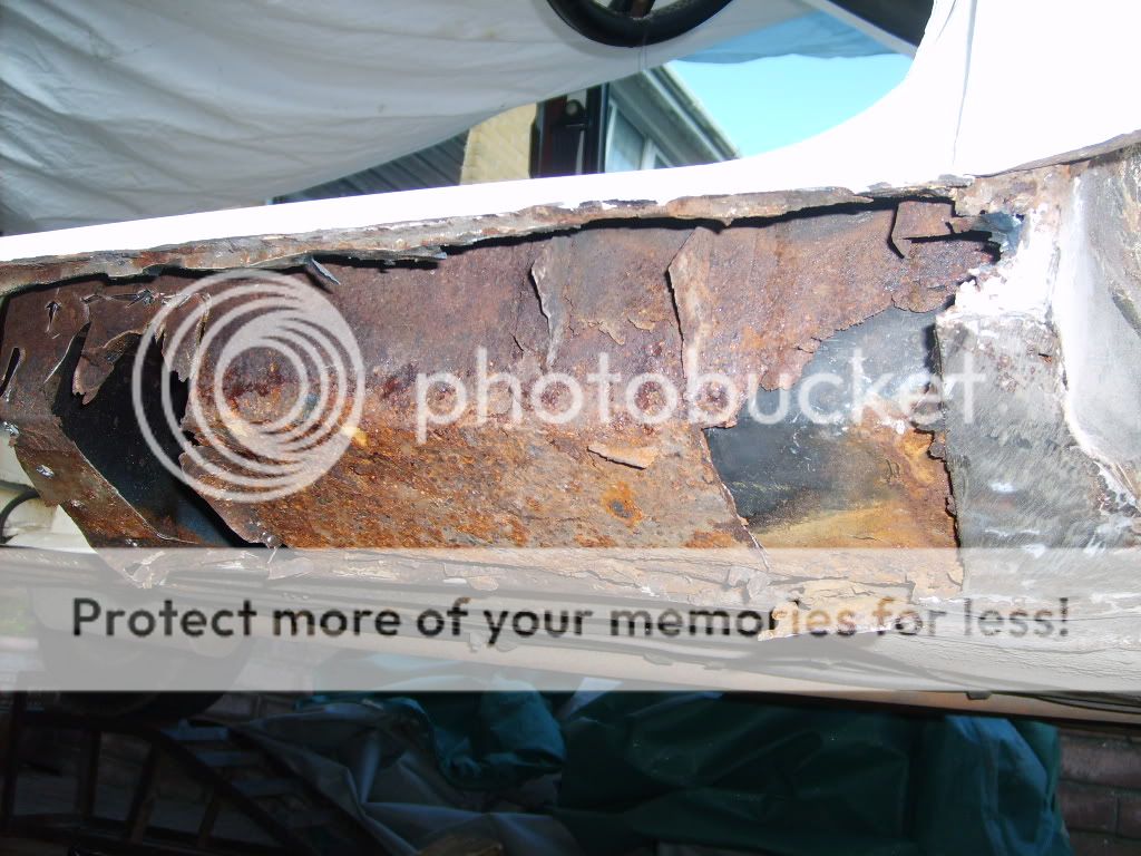

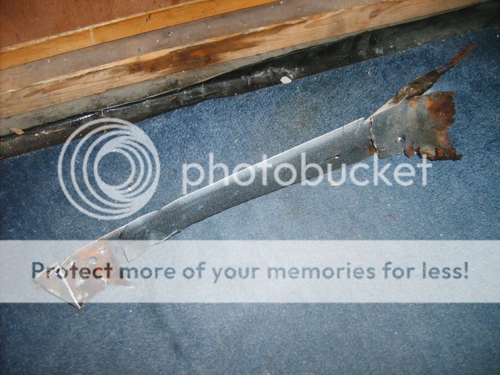

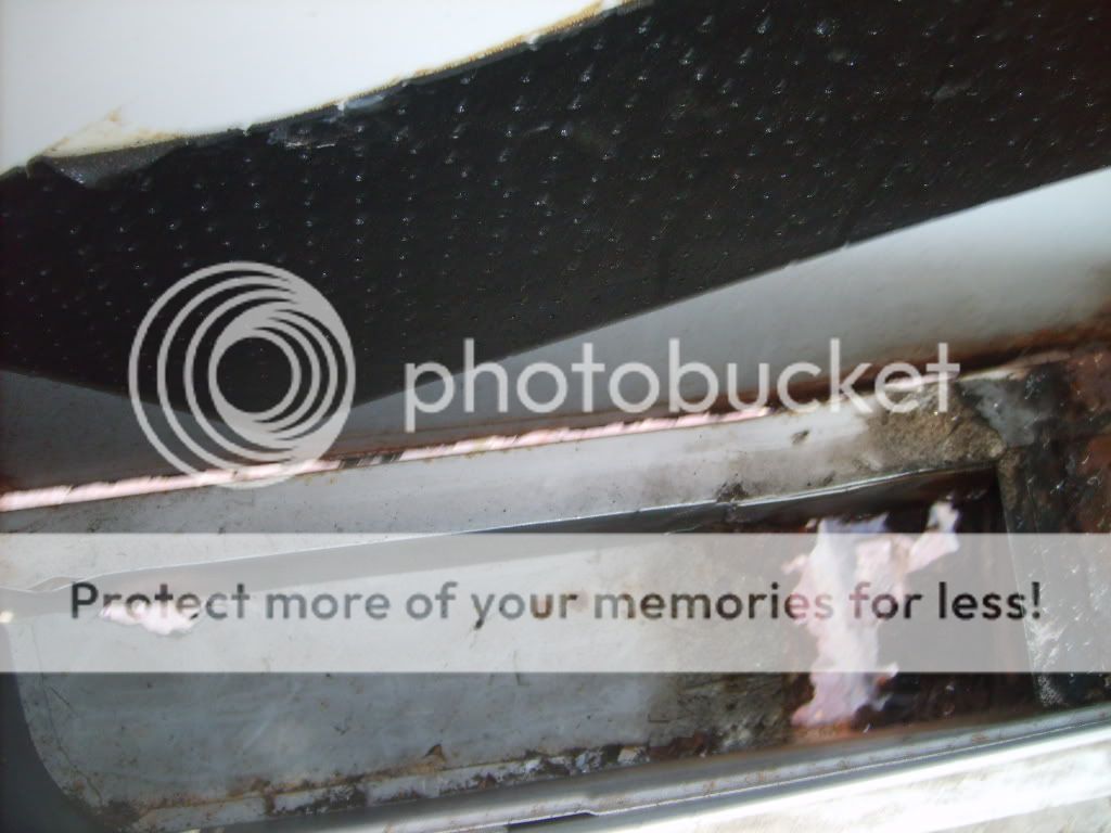

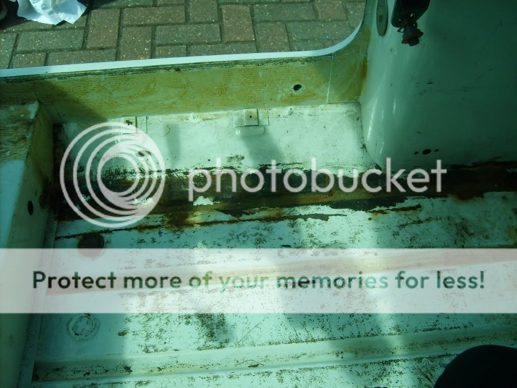

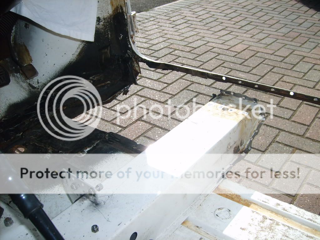

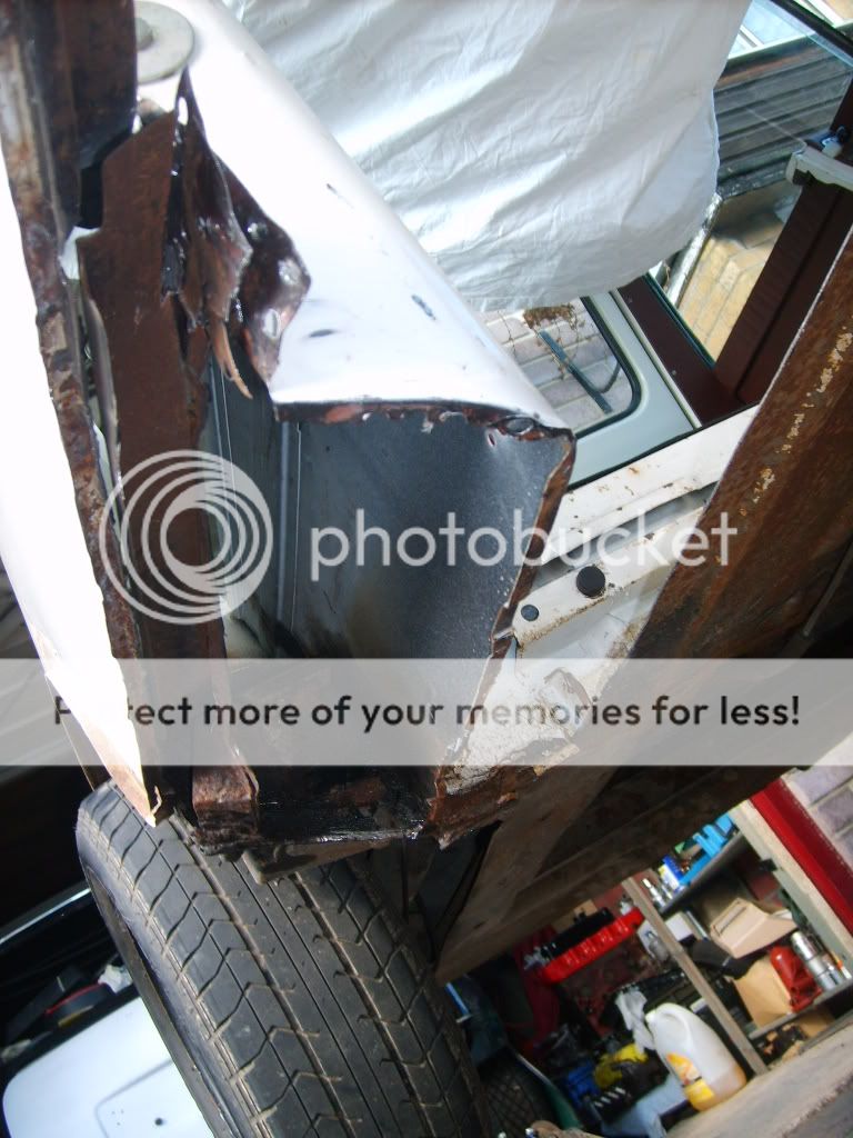

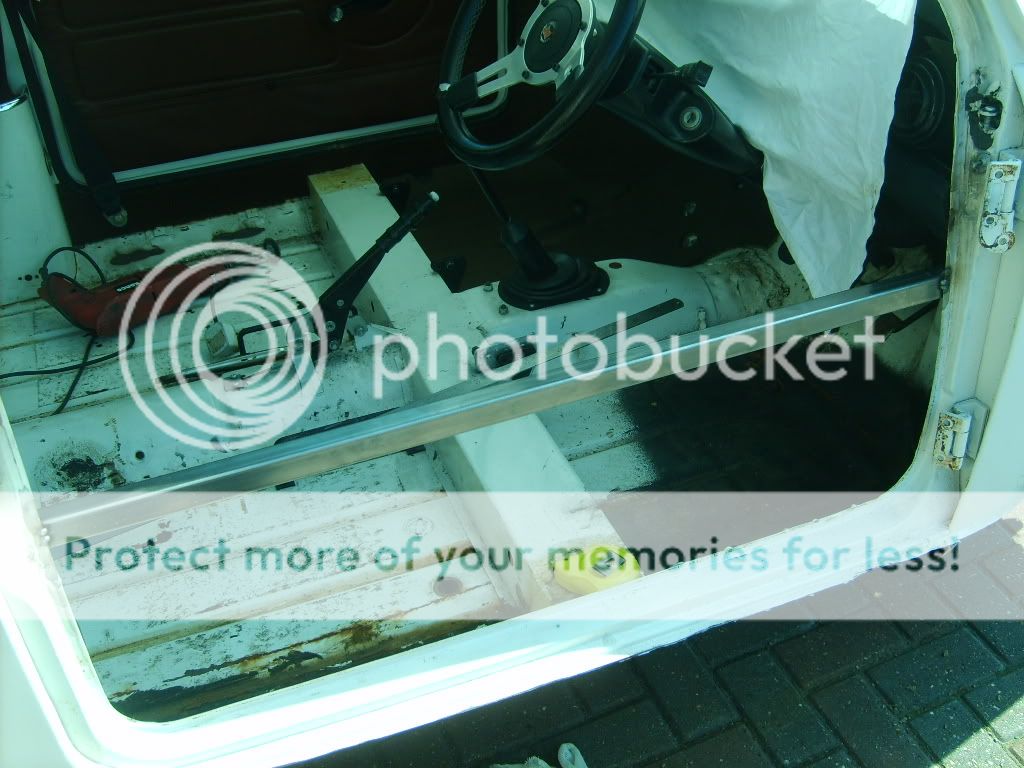

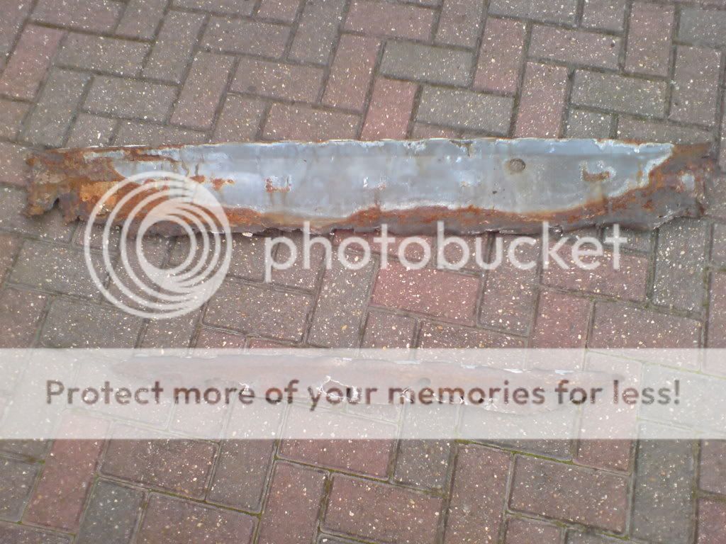

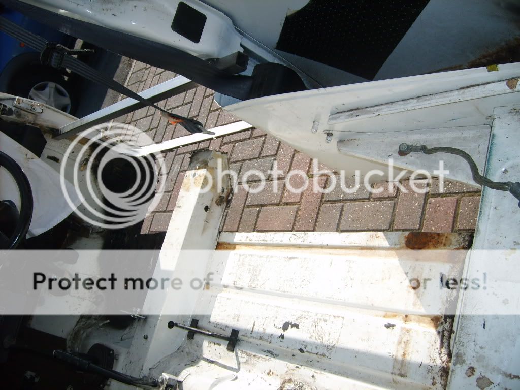

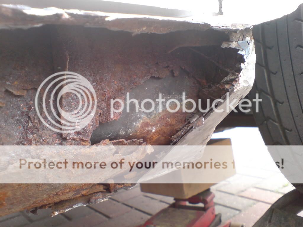

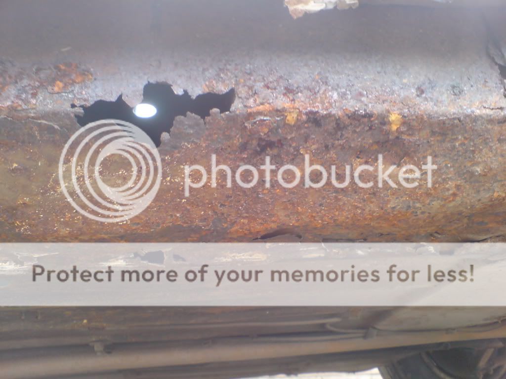

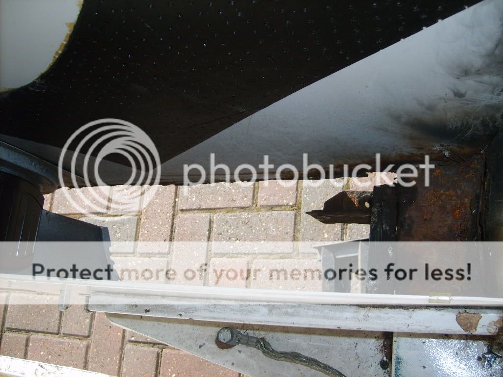

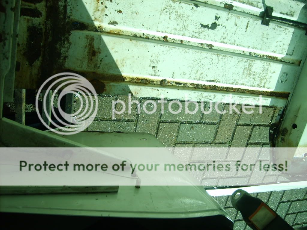

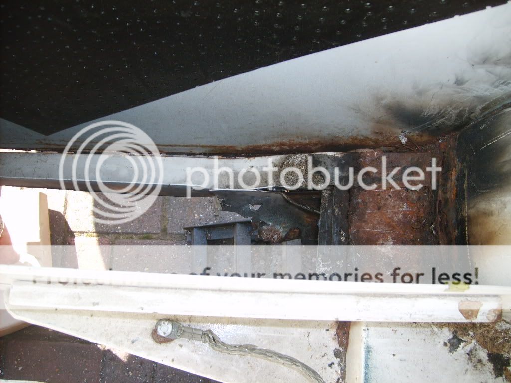

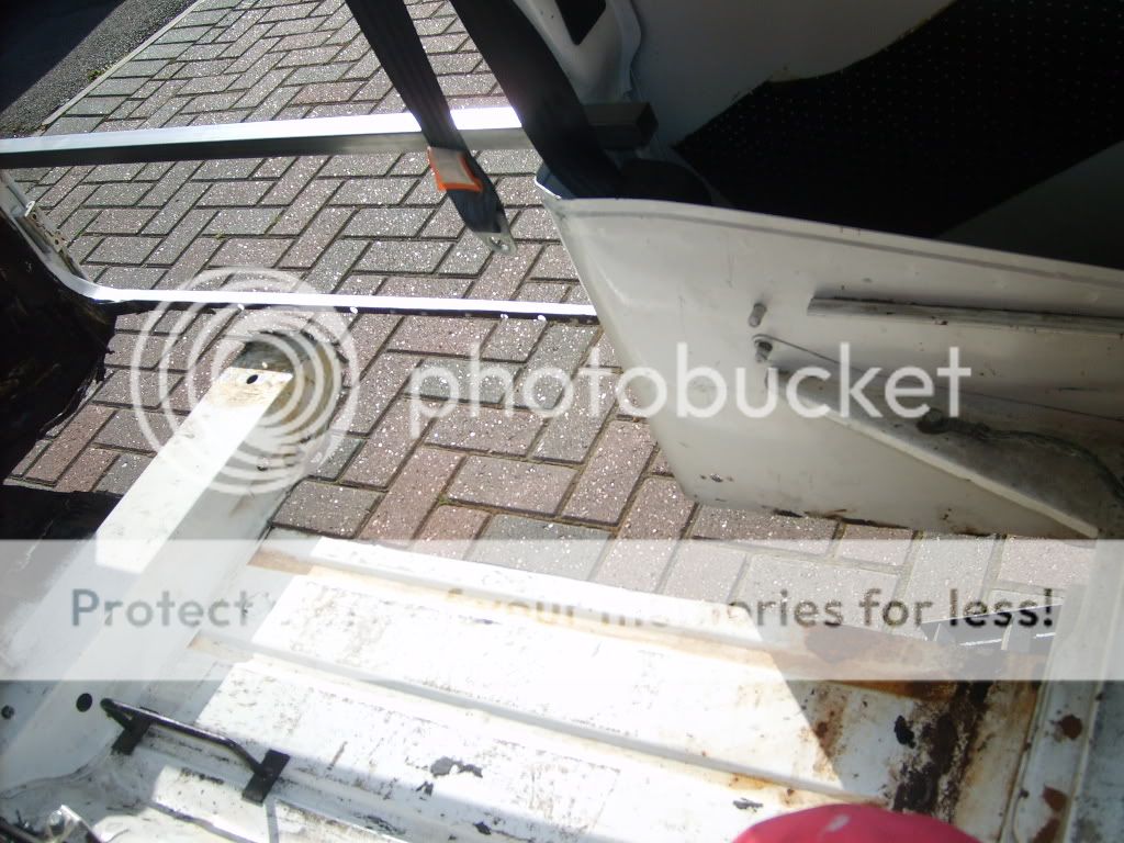

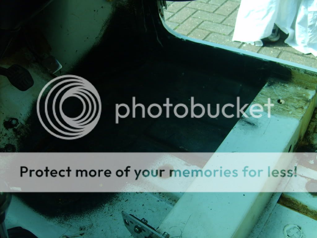

TODAYS WORK
Im sorry there's so many pictures.
Not seen one of those repair panels before. Should make a nice tidy job of it!
Doesn't look half as bad now it's all cut out!

Yeah lol, its not a hard job really, just time consuming... something always stops progress.

Thats coming on nicely, looks like a lot of hard work.

You're doing a great job. Always best to rip out all the bad stuff to at least 1/2 inch of sound metal. You cant weld rust it spits like hell !!! And avoid braze, the welder won't like that either.
Let me know if you want me to pop over. I'm happy to if you want some advice.

I'll be cracking on with it again over the weekend. Got some more metal to remove and clean, and other little fiddly jobs to do, so hopefully after those bits have been done, i may be able to crack on with some welding.

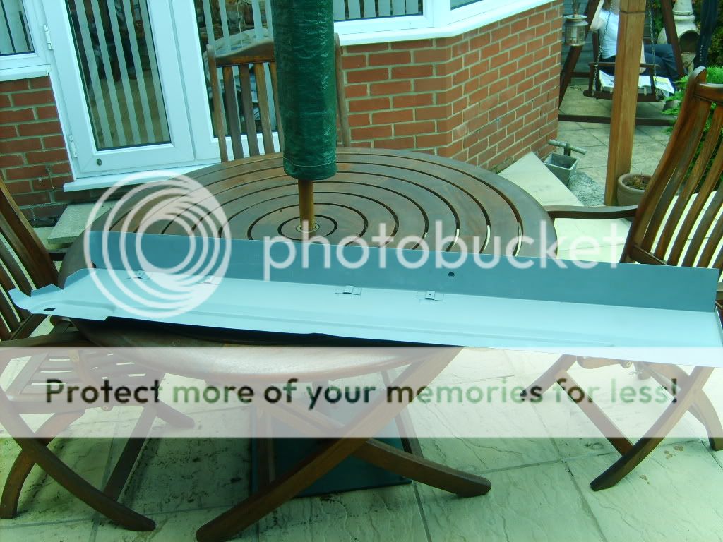

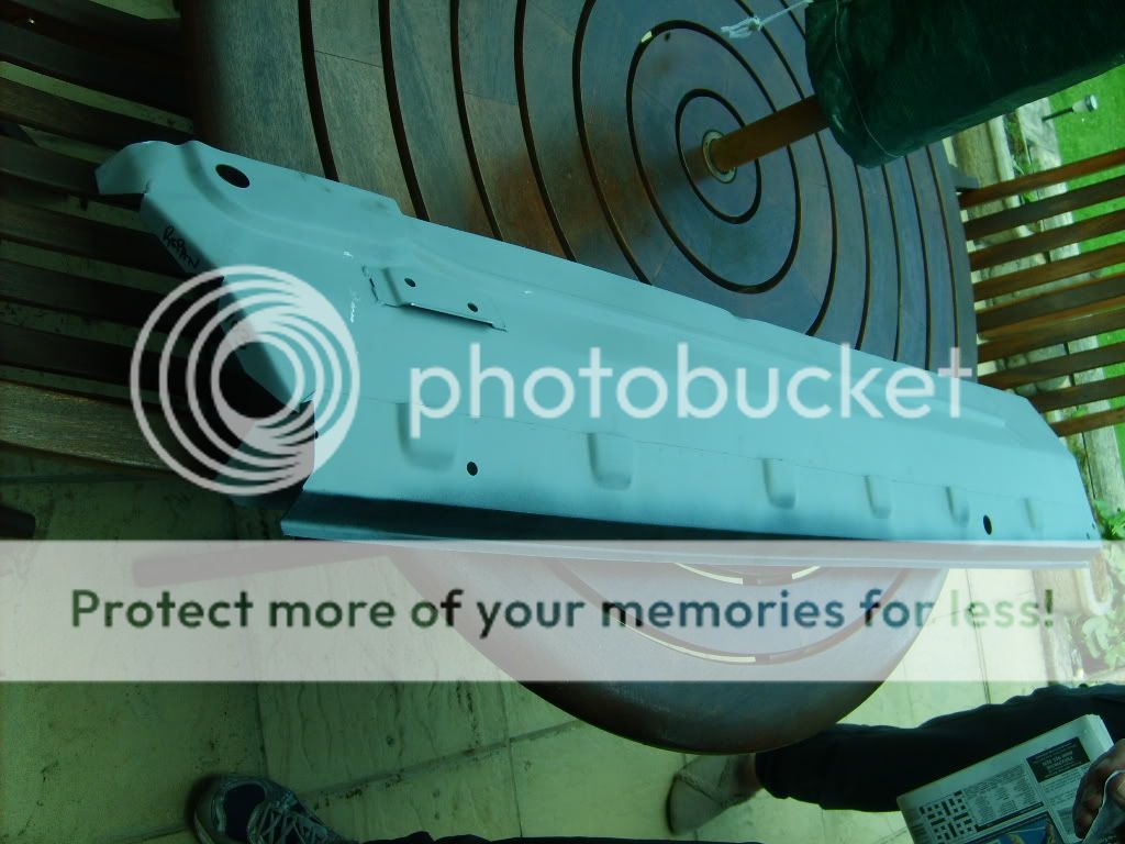

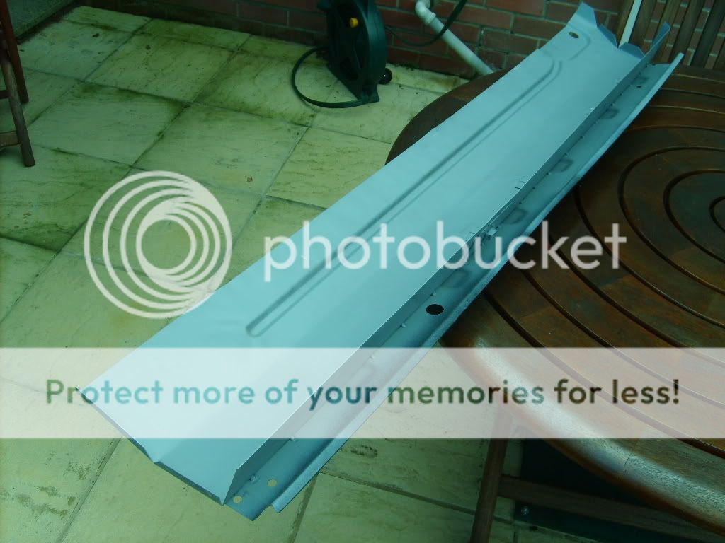

Well Good News, i managed to find some pennies, and went over to somerford minis and brought my other two panels.... now i have no excuse not to crack on!
This panel looks handy, where did you get it from?
Oli
1733 Posts
Member #: 1910
Wilts
I got it from somerford minis Paul, available with 4 or 6 flutes depending on the year obviously. Its a non genuine panel, but its well made, and it seems to fit nicely when i offered it up.
And somerford use them on their restorations, so they cant be that bad lol.
Part number begins; REPAN. If you put that into their seach box and scroll down to the bottom you'll find them.
Hope that helps.
