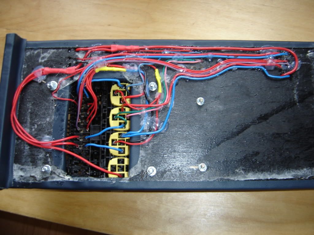

Just a quick update.
’77 Clubman build thread

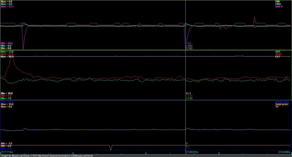

Last night’s log. Or at least one of them.

Looks good, AFRs look nice and close but there's no scale on the left for absolute units.

How do I set the scale in megalogviewer?

Here is something I've just noticed. At each spike of PW the battery voltage drops to 10.5V

Don't know about setting scales in MegalogViewer as I use Winlog (TechEdge based software), I'm sure one of the MS experts will answer.

You can't set a scale in MLV, just min and max.

I've got a battery connected, but it is a spare, which is suspect. It may not be charging. What I have also noted is that as time the time goes on in the log, the average battery voltage is dropping, so I'll swap the battery for tonights work and check my grounding and perhaps swap out the alternator. ’77 Clubman build thread

This definitely looks like a grounding issue. Make sure that all you sensors ground at the MS and that the MS grounds at a very good car ground and then this ground goes to the battery with a sizable wire. You also want to make sure you alternator an battery are in good working order because both will easily create noise issues.

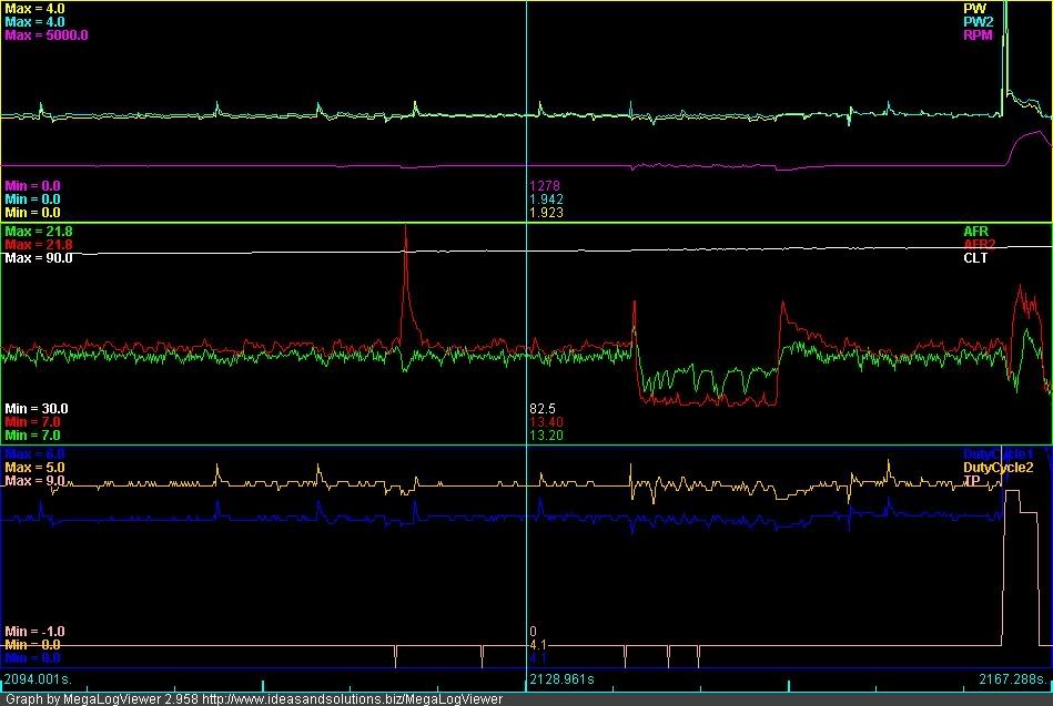

The last week has been a bit frustrating...

Not sure what the exact effect is of having the cam pulse at the same time as the missing tooth but I know Jean has said make sure you don't.....

The lost sync was on TS. I have not bought the scope yet..

It seems like you have created a wiring fault on the Hall switch circuit when you re-wired it.

On 22nd Feb, 2010 Graham T said:
Could a short be why I was seeing the spikes (voltages dropping to 10.5) the last time I had it running? Possibly - where are you deriving the power for the Hall switch from ? I assume it's working at 12v like Pauls. Because I use an opt-switch I run at 5V and use the same 5V supply as the CTS, IAT and TPS which is protected by a polyfuse inside the MS. With a Hall switch at 12V that protection isn't there. Schrödinger's cat - so which one am I ??? |

The hall sensor is powered with 12v from a separate fuse in my fusebox. I have a 2amp fuse in it at the moment. ’77 Clubman build thread

In which case, less likely. A short, even a very fleeting one should take out a 2A fuse easily unless it's a delayed fuse.
