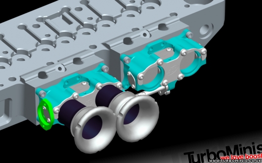

Pic of the throttle bodies for the 7 port, 36mm "shaftless" direct to head.
JK

Tom H
69 Posts
Member #: 1670
Looking Good John
I don't know how you always manage to post tiny pics John.
