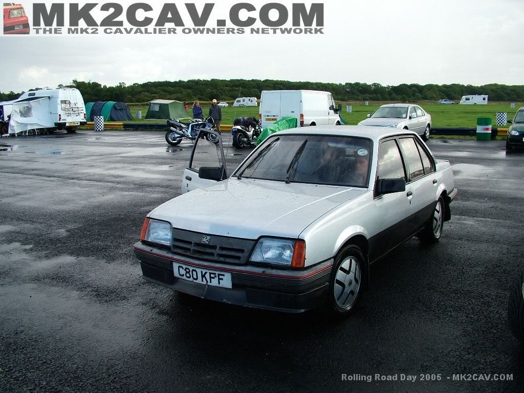

Yep the JB Camira is nearly identical to Vauhall Cavalier (say a mid 80's model). Deffinately worth a try to check out brakes. Used the same engines too I think.

Some similarities there.
