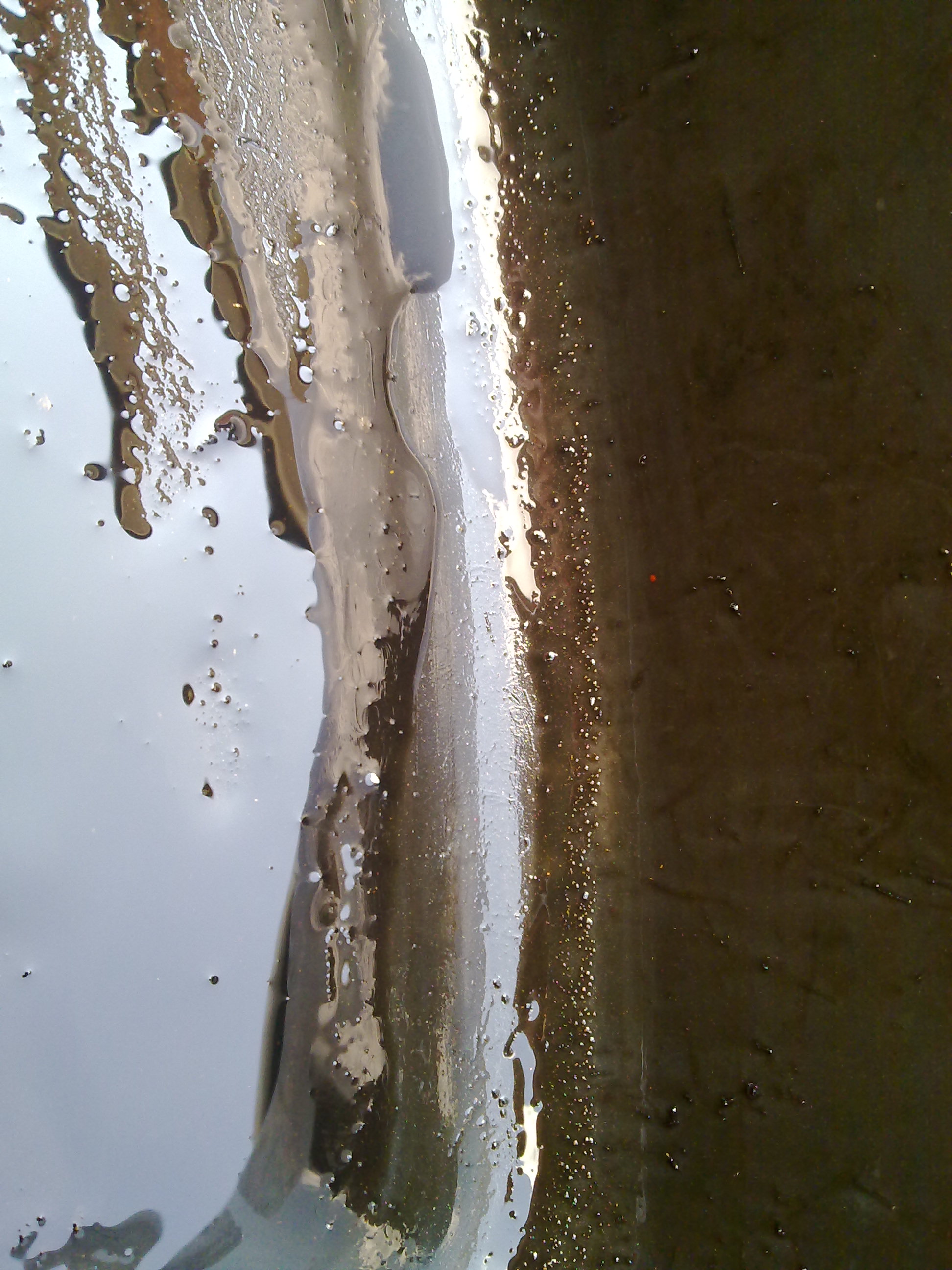

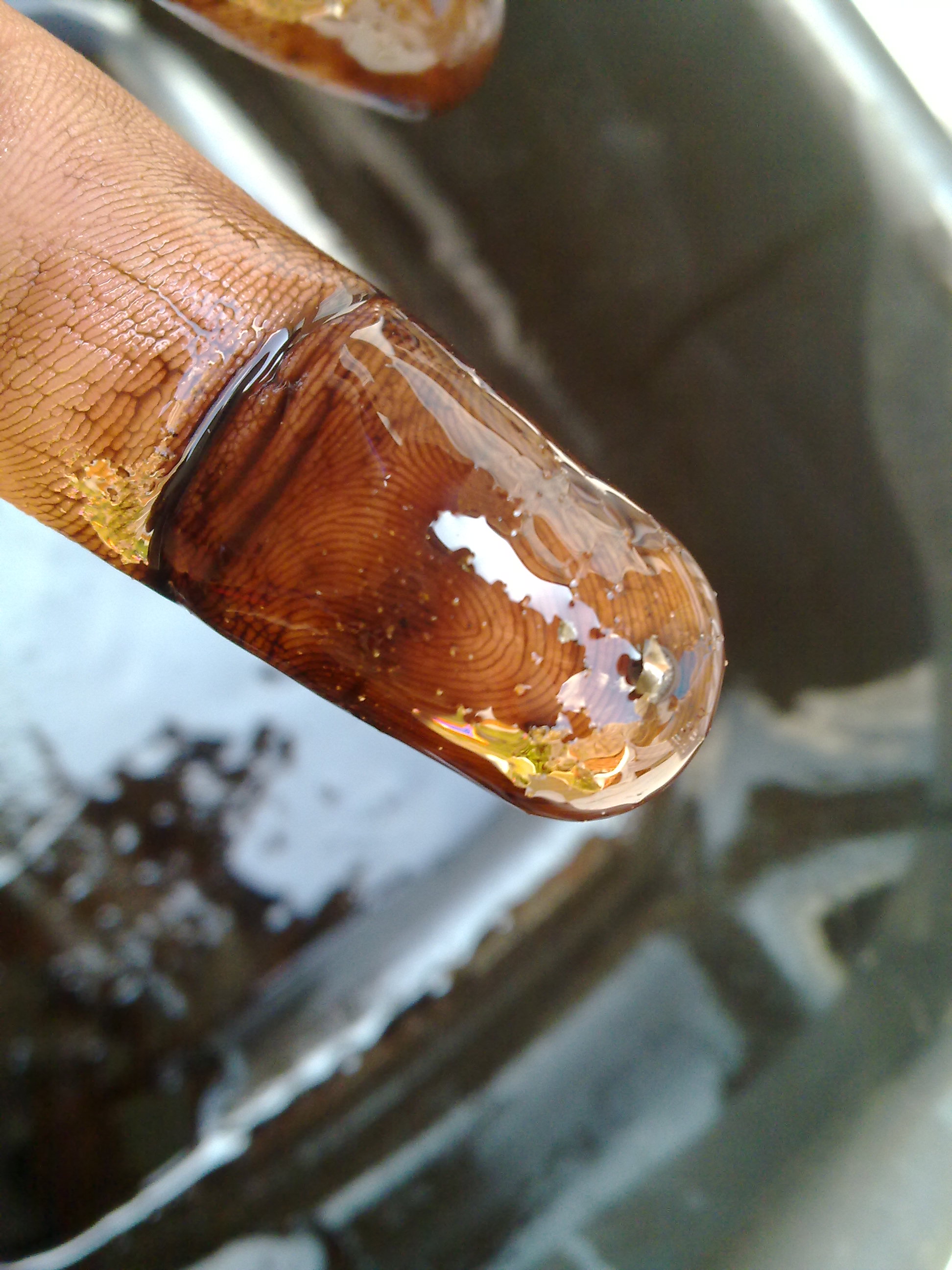

bit of a step backwards update, the recent hot spell was loverly but the 30 mile (excited) pull up to carls on the sat (27degC) i thought just caught him before overheating ( and slowed down) oil pressure has been low since 55-60 on fire up, 5 when warm idle if that,
changed the oil today to find alot of bearing
cold start of 40psi and alot of knocking i think he can stay off the road for abit
i said earlier in the thread he might be the donor shell for running in the new engine, i think he will be now

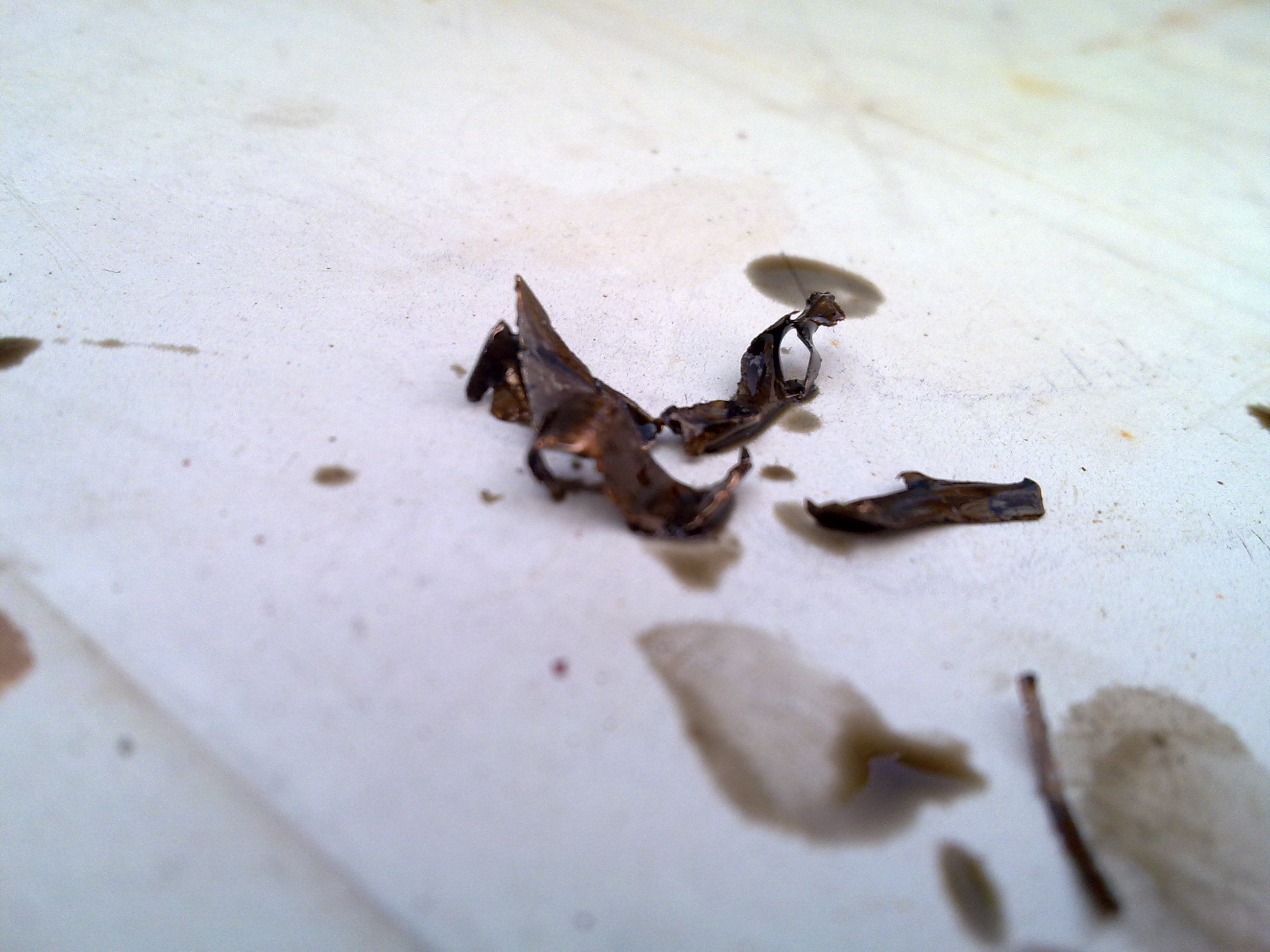

after a trip to the machine shop and to order the bearing for the turbo engine, the copper stuff my gearbox spat out is some sort of thrust ( not main / bigend bearing as i thought) and i think that is gearbox related, it seems to have damaged the bearings though oil pressure is still down,
i have a 1l lump to go in, not payed for yet but i think the deal is done :)
All yours mate *wink*

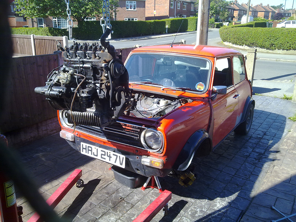

sounds like the lay shaft thrust bearings have taken a beating, easy enough to sort out.

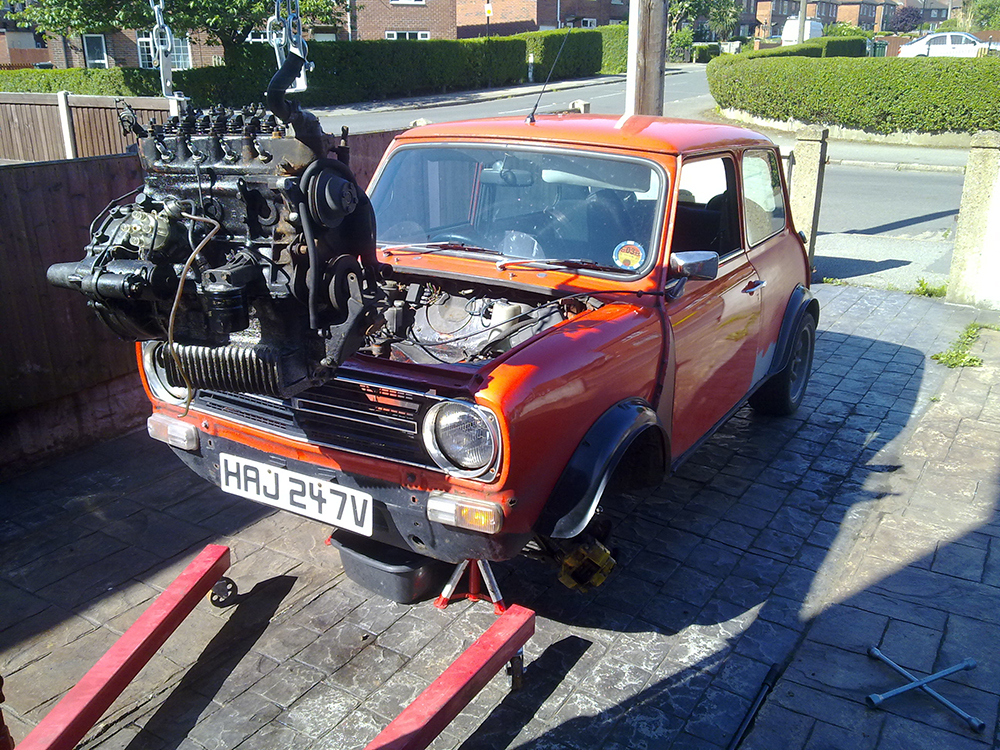

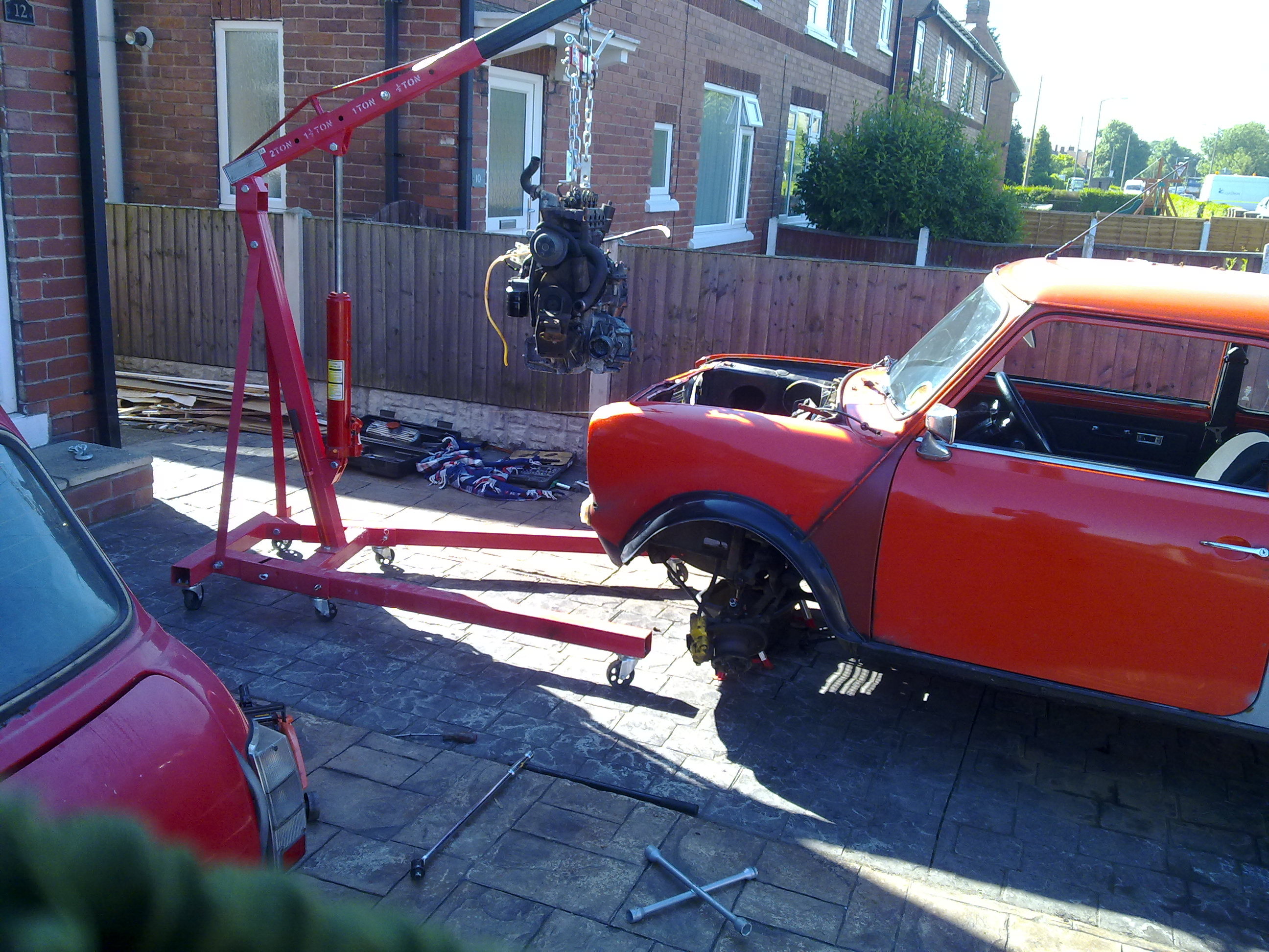

When you gonna get that 998 in there then? Thanks for helping us take it out.
thanks for bring it to mine for me, i have a holiday from work end of june, it will be in for avon *wink*
thanks for all the extras too *wink*
i might even give it a scrub and get a bit of paint on it too ( car and engine )

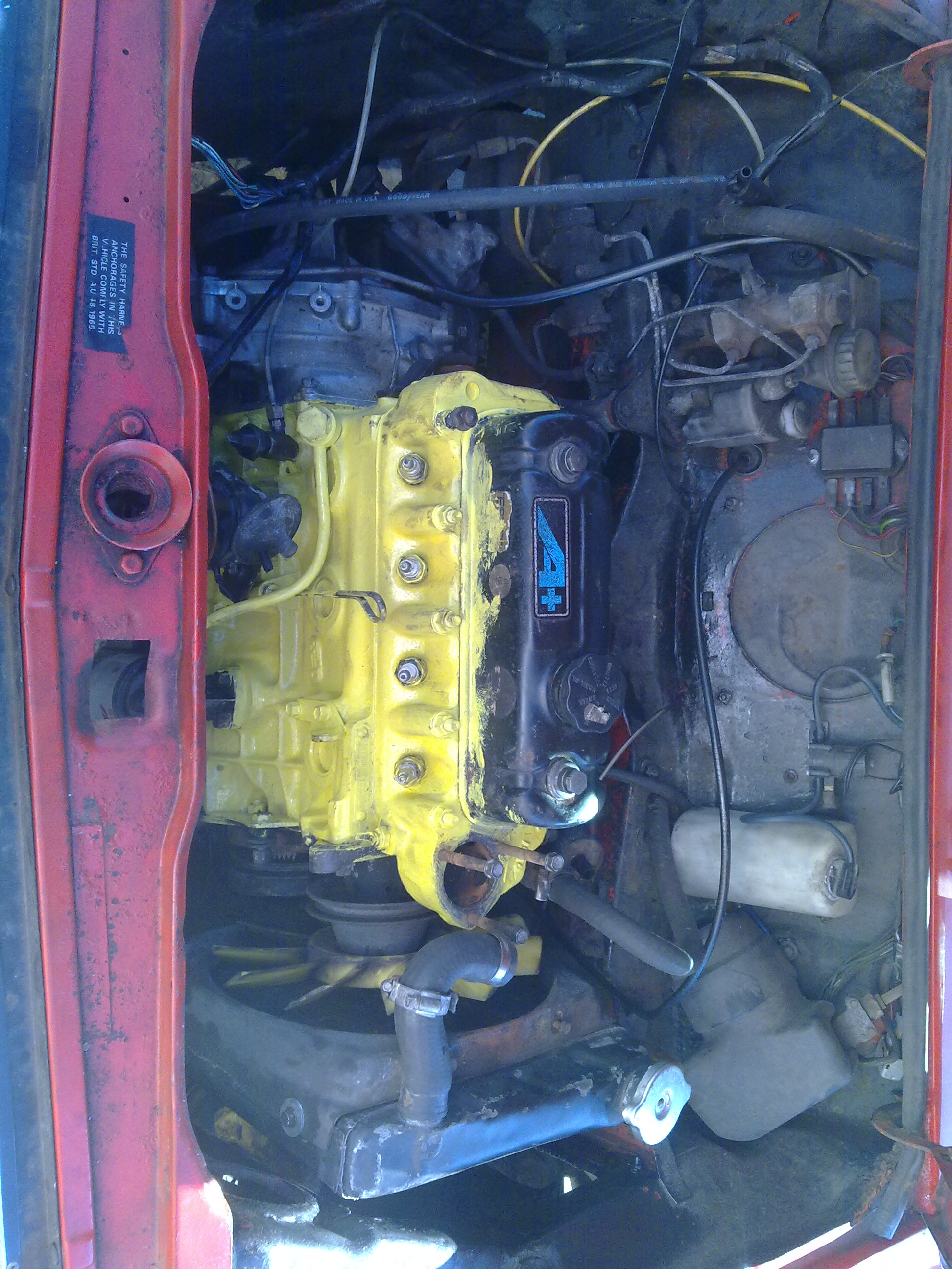

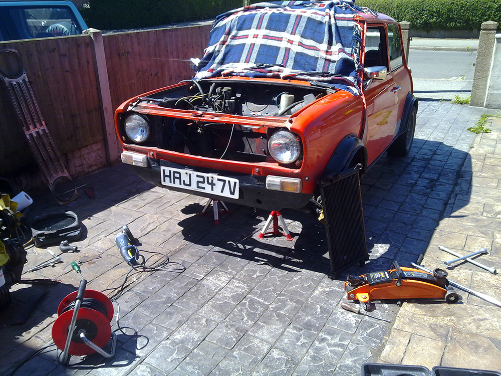

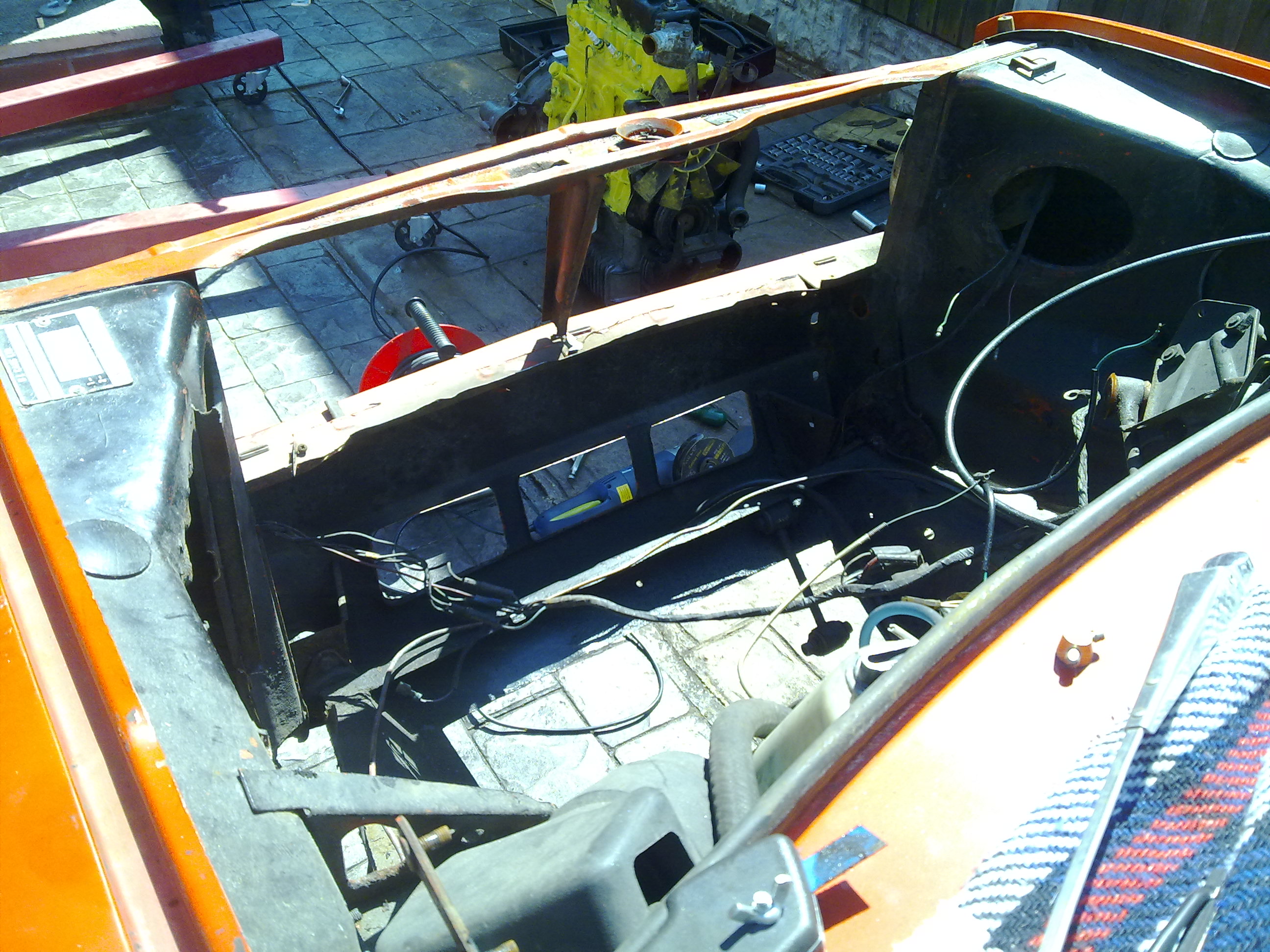

engine swapped out today, no pics of the new engine as phone died, but its bright yellow*happy*

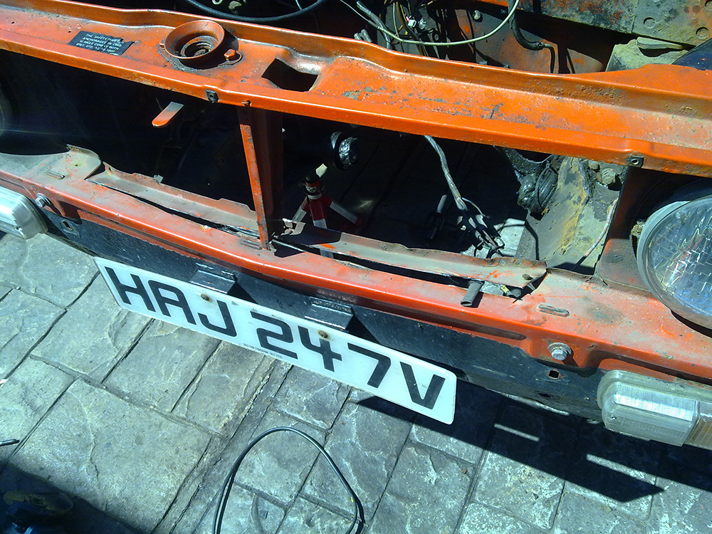

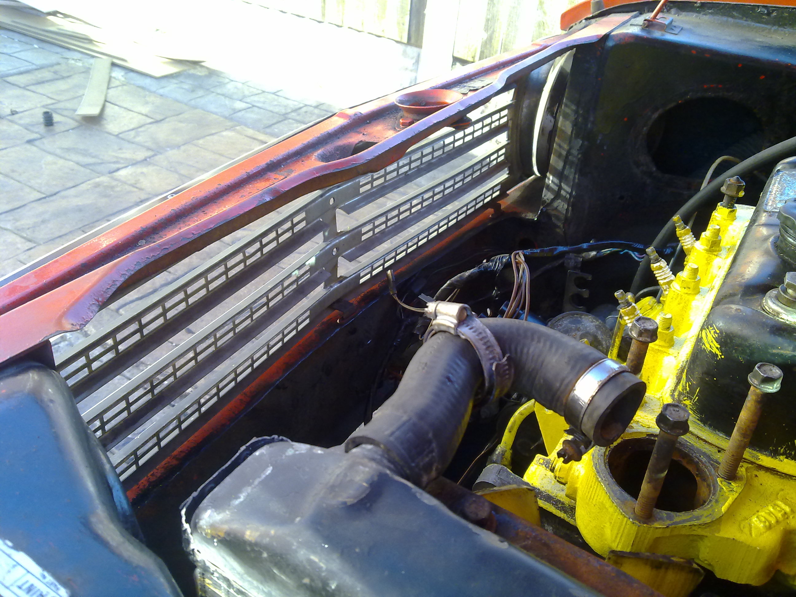

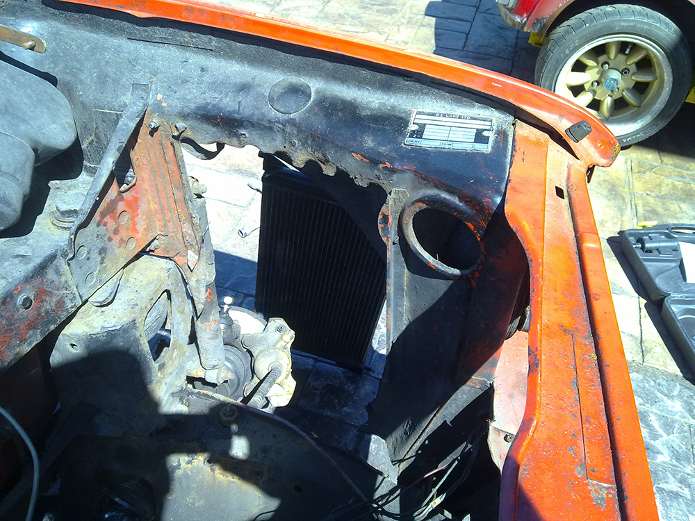

the front is cut out ready for the front mount ( in the close future as my metty rad is a little too far gone)

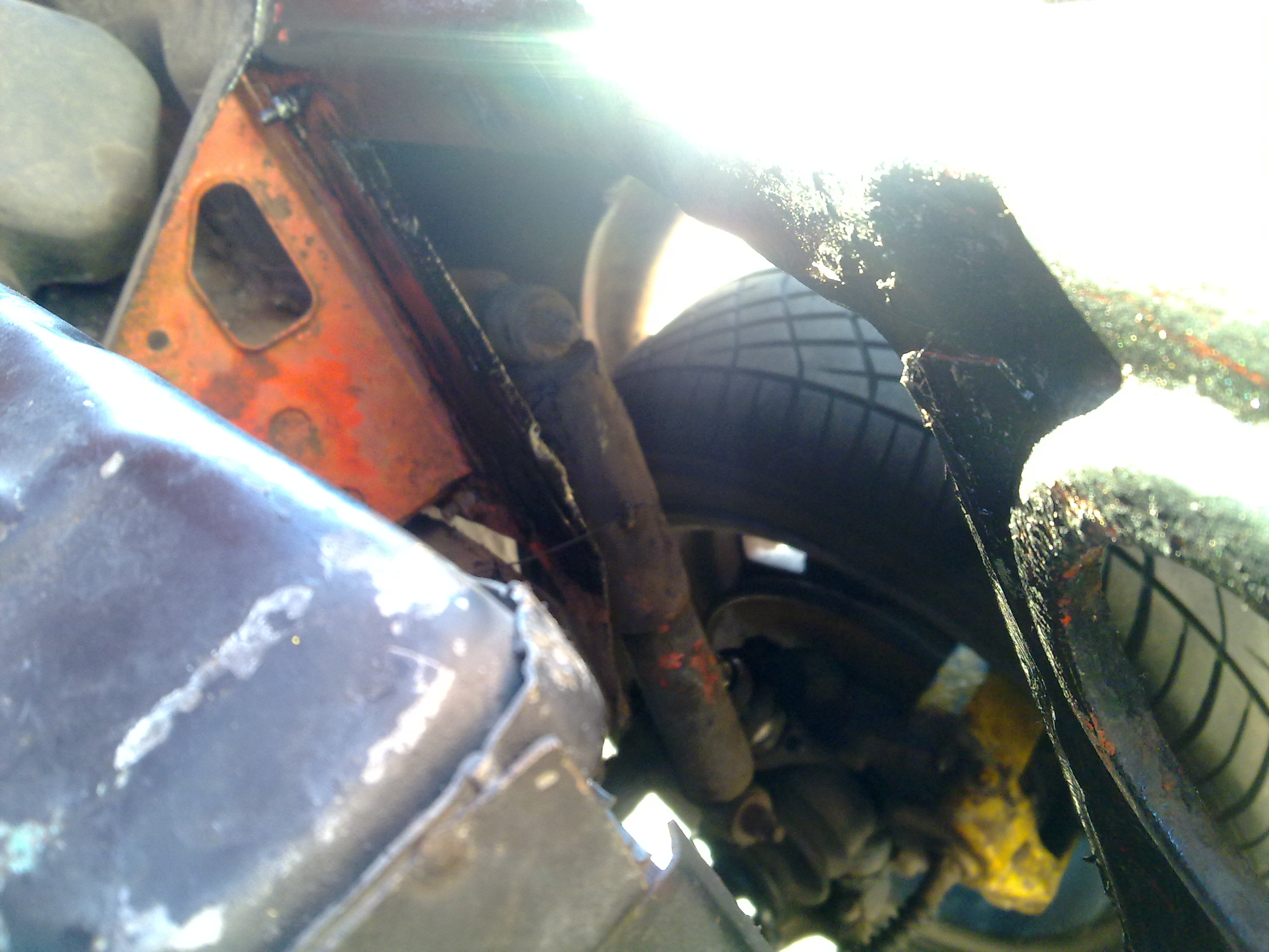

inner wing cut out for an electric fan on the side mount rad for now, it was very rotten anyway
front wiring sorted out, and a new front brake pipe made up, as it was crusty then i hit it with a grinder anyway :(

cheers brocky, and yes i know the paint isnt neat, im not trying to pass it of as a brand new unit on ebay.. just to tidy it up, the ally cover will be going on it, and the engine will be gold, bling bling*wink*
Did you wear a welding mask while painting? lol
