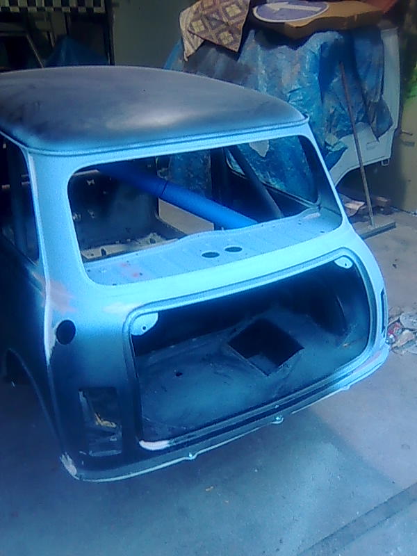

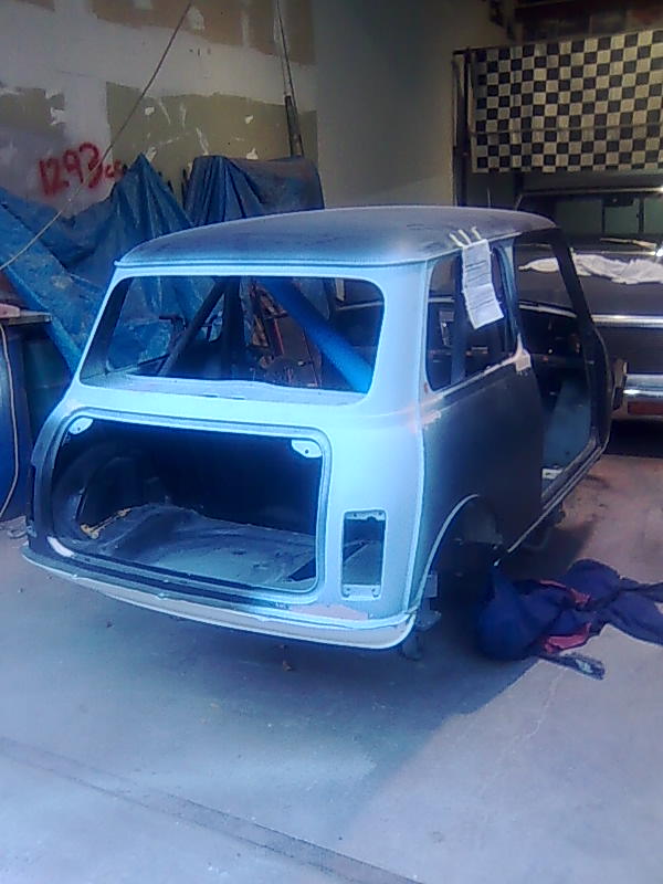

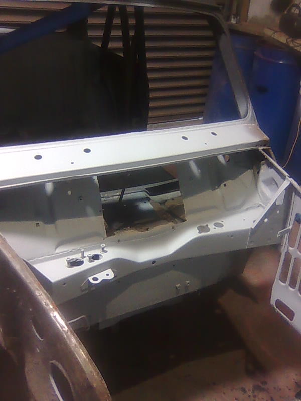

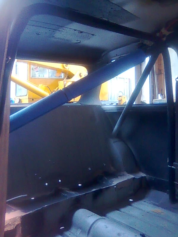

this weekend done lots of seam welding and finished rear seat tray. cage harness bar is made up. firewall panel cut out and made up a new carbon fibre cover. front firewall is fully welded and hole proof to prevent fire, smoke, fumes from getting through.
rear valance fitted. bit of work around the dash. carbbon fibre bonnet arrived but it was for mk2 so i have to send it back.. it was there fault not mine....
