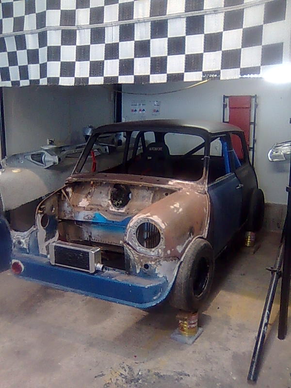

Hey Guys,
Will keep you updated daily on my Build Thread Here....
at the moment waiting on a international minispares order. 1100 pounds worth of suspension, rubber, trim, quickrack, gaz shocks, arches, solid mount subframe kit, crystalk angeleyes, competition shock mounts and last but not least ALLOY 4 POT X DRILLED 7.5" DISC DRIVE ASSEMBLIE.. IN BLUE FINISH..WITH MINTEX PAD AND GOODRIDGE BRAIDED CAR KIT.
carbocarbon fibre bonnet and bumper products imported this week from arcangels uk..
fibreglass boot, valance, carbon fibre bumper ordered this week also...
IM USING MY INHERITANCE WISELY AND GETTING THE MINI DONE RATHER THEN BUYING A NISSAN RWD DRIFTER LIKE EVERYONES DOING....I JUST CANT WAIT FOR GETTING IT ON A TRACK HERE IN NEW ZEALAND..
NEW ZEALAND MIGLIA SPEC ROAD LEGAL TURBO MINI BUILD THREAD >>>

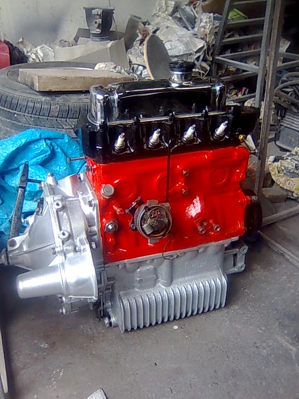

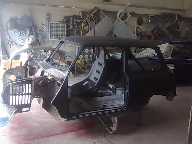

the engine in pic is the na 1100cc clubman motor that i am running boost on until m.e.d engine ready. at 4psi it made 87hp at 8psi it made 101hp ...running 4 spd sc cr gbox...

I assume it is one of the short stroke 1275s and not a long stroke 998 by the power figures?
On 30th Apr, 2010 Rod S said:
Gary's description is best
The one in the piccys so far also has a carb....
It will be interesting to see your intended fuel injection setup (that you mentioned in the earlier threads).
Looks a good project though.
That's an odd statement Gary.
Benjamin has 140hp from his 1098.

Yes but I thought 87hp at 4 psi and 101hp at 8 psi sounded a little high for an engine so uninclined to rev

I would tend to agree that 87 at 4psi is maybe optermistic, but this is why be say bananas rather than bhp on this forum.

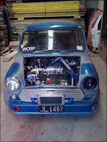

This was the car trying to run boost with no plenum a while back was it not? pipe straight into the carb? With what looks like a n/a carb which hasnt at liest been boxed in?
NZMED1293
45 Posts
Member #: 8924
New Zealand
this is the car and it works fine without the plenum. have only just stripped it down after 6 months road/weekend use at 4-8psi. went fine. na carb yes, modified to suit boost. bdd needle profiled, hifturbo jet, pressurized float bowl.

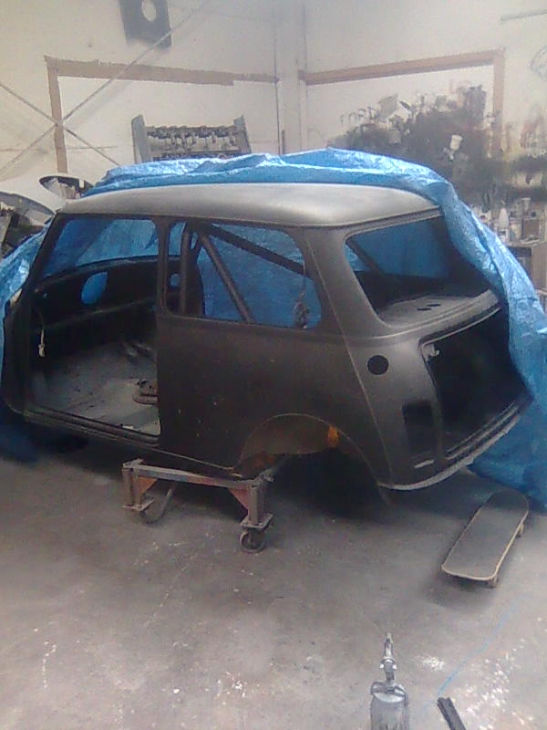

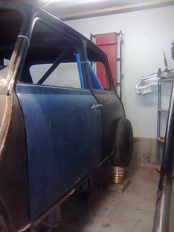

build., rear valvance fitted. inside the car preped more.. still need to weld new guards on when they arrive..

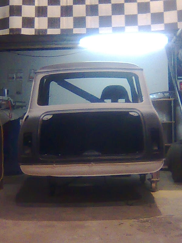

rear valance fibreglass mocked up. new boot floor also wleded in there..

Are you going to get rid of that hideous front valance?
What is that sitting on?
catering bean tins by the looks *happy*
looking good too
Im glad someone asked, I was thinking exactly the same.
