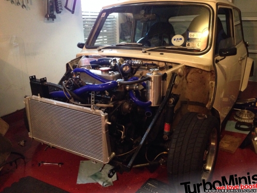

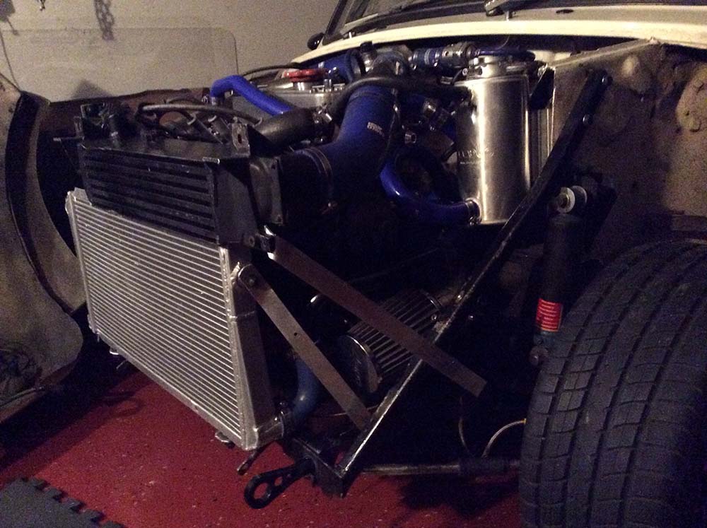

I have been enjoying a few hours of uninterrupted tinkering over the holidays.

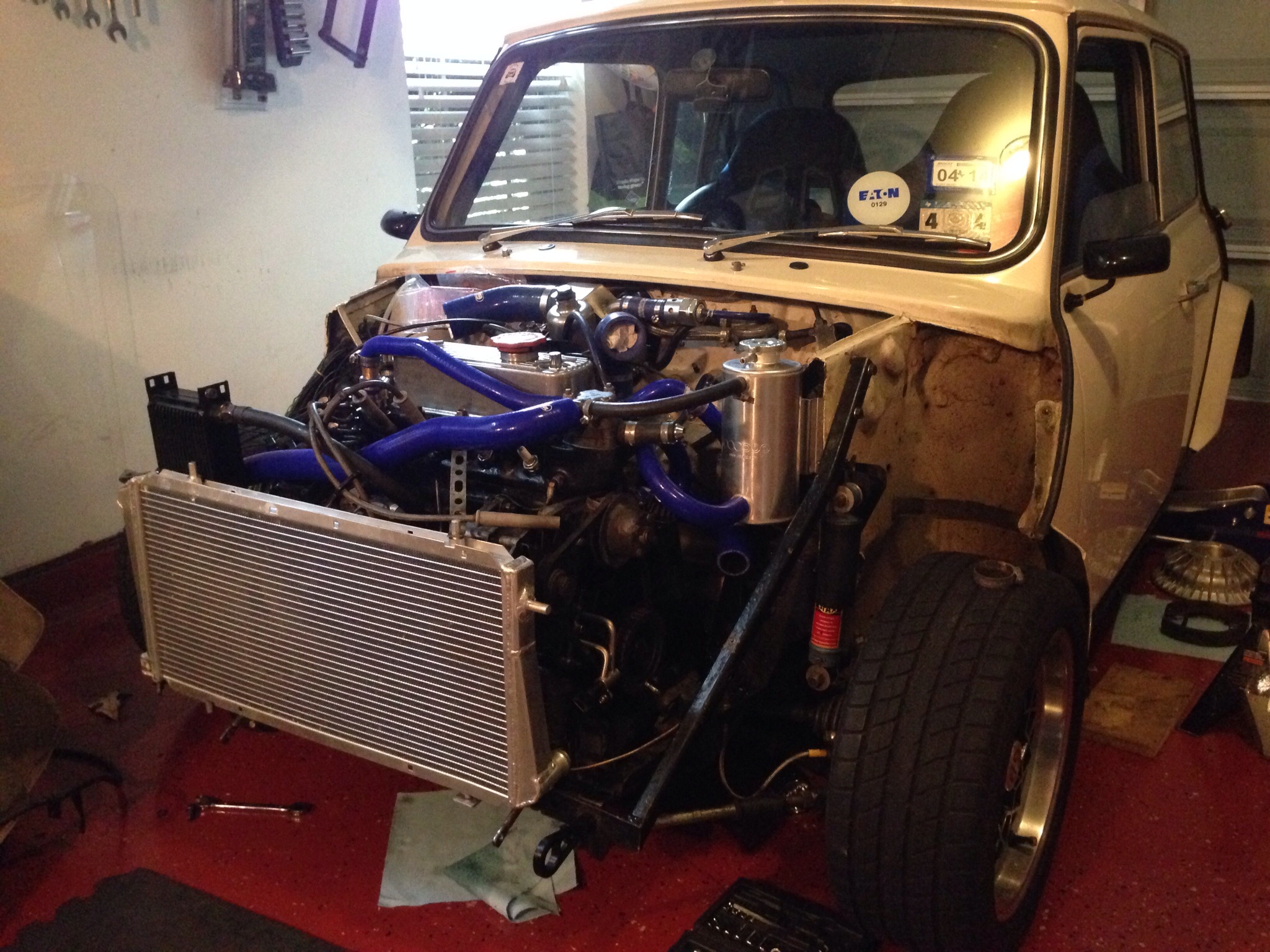

Thought I would post a quick update on:

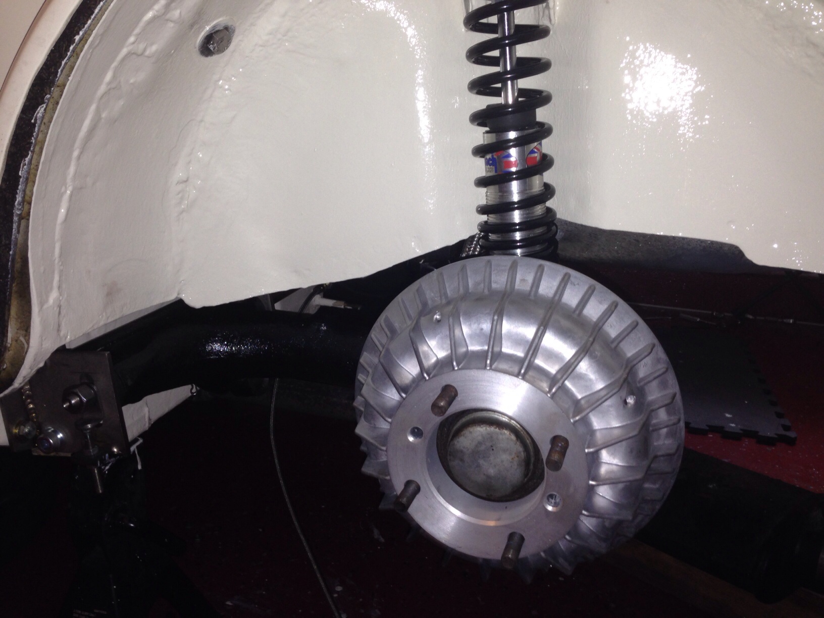

Rear beam that it finished earlier in the year
And cooling upgrade - I have been planning on doing it for a while and since my metty rad started leaking I ordered the stuff a few weeks back
The rest of the list looks like this :
Fixed loose drive shaft boot
Replaced timing cover oil seal
Fitted new expansion tank
Changed oil and filter after run in complete
Started fit up of new rad - Alloy MGF, it's big but will fit just, is still thin at 1", but need to change plumbing a bit and move up the IC a bit !
Fitted temp sender for mj for ignition correction
Will need to wire up relay for fan using mj as adjustable fan switch
Fit fan
Fit new rear slave cylinder and bleed
Comments welcome

That is a fucking big radiator, but not surprised given your summers! Surprised you don't have an AC condensor on the list!
Brocky
809 Posts
Member #: 224
Katy TEXAS
Hey Dave,
Yeh needs to be down here, it's nice and cool just now but when it's in the 80-90s the original set up struggles even with the stat out. 90-100+ June thru August, it just stays in the garage....
Plan is to try to be able to get to the point of over cooling and work back from that
Your not wrong on the ac, although I am getting acclimatized

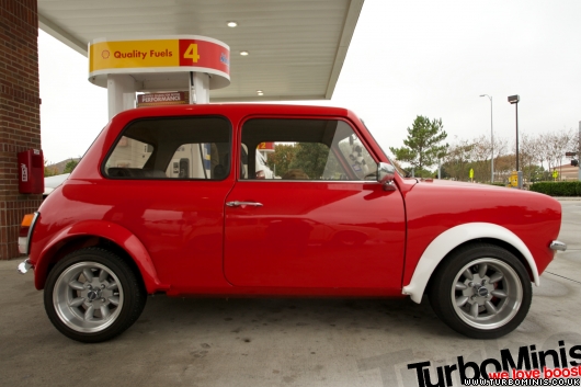

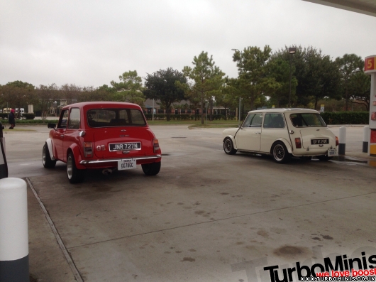

Heres a couple of pics of the Katy mini clubs first outing a few weeks back
The red one is Pete's v tech if you look closely you can see the boot badge has been modified to 1797 GT

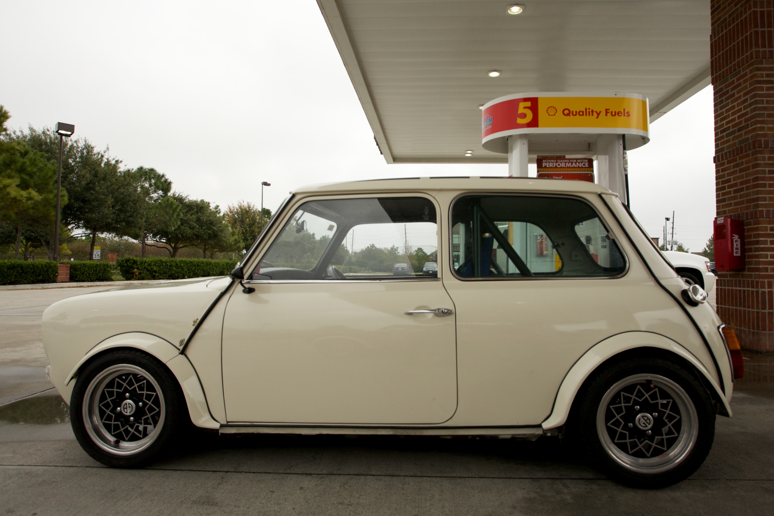

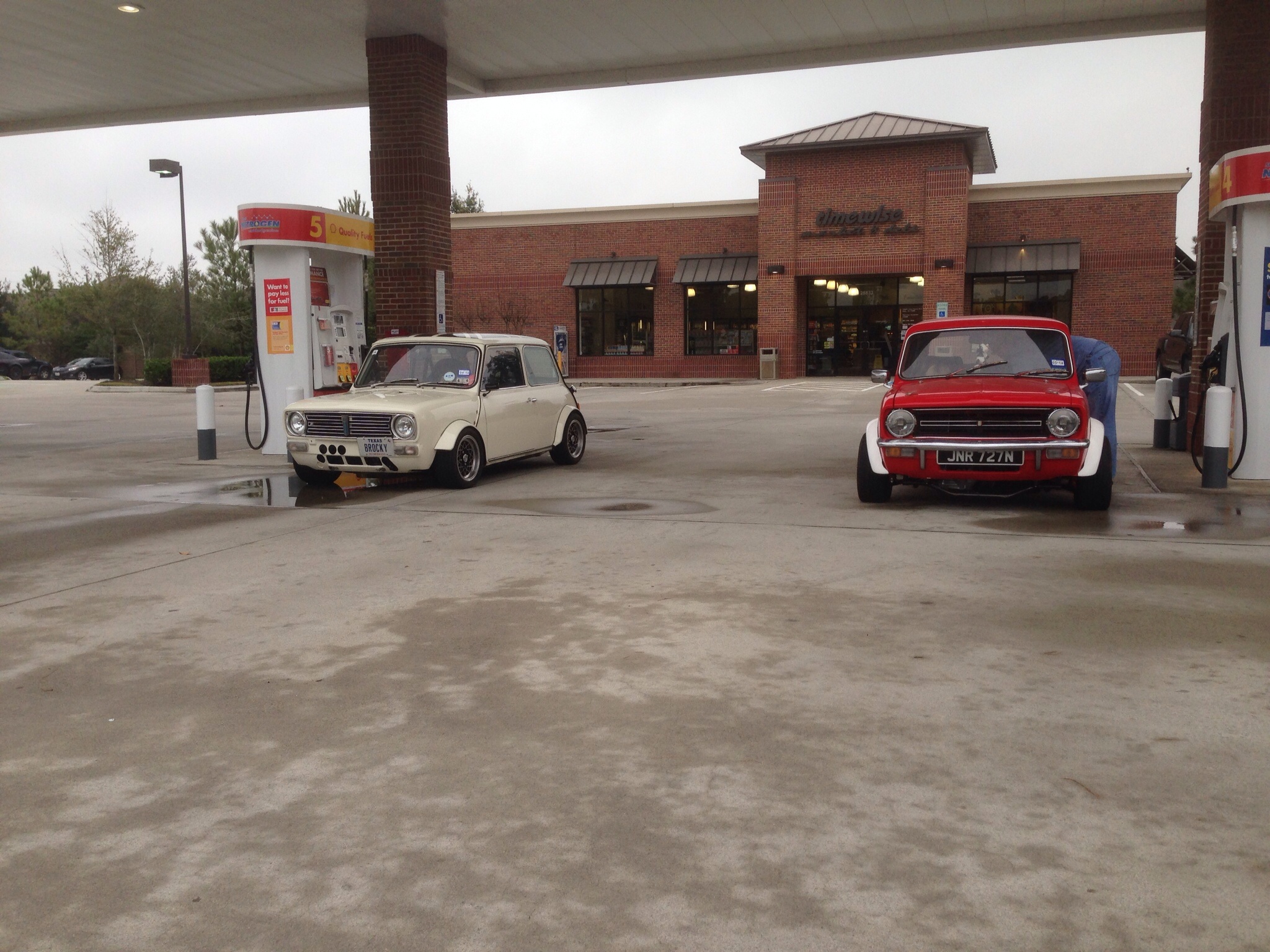

A few more pics from the sunday morning breakfast club run,
Comments welcome

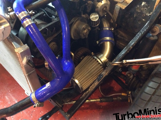

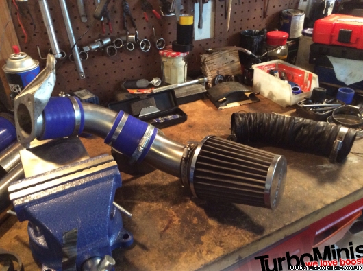

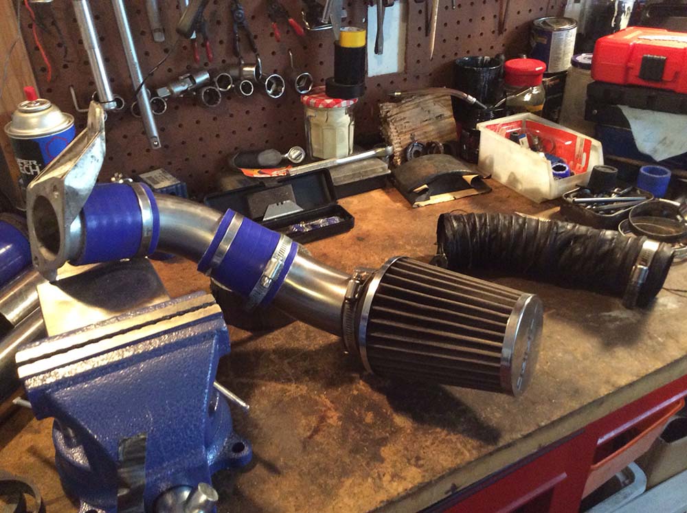

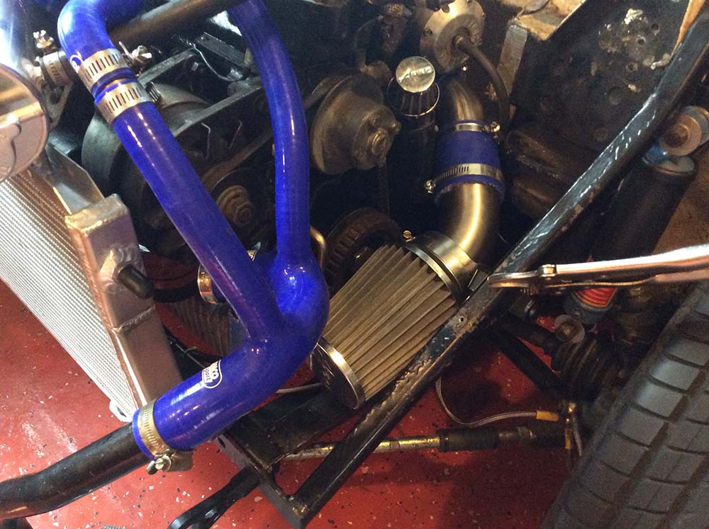

Alright chaps

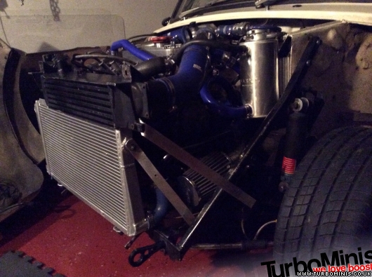

I've been working through the big front mount rad upgrade and while I was in there decided the original section of the black un crushable pipe had seen better days
(in background photo below) and had also suspected possible partial collapsing / choking at higher boost levels recently....
Have had some ss bends and silicone hose in the spare parts bin for years so thought would make use of it, might be a few grams heavier but looks nice and definitely won't be crushing...
Very tight fit - will remove breather next rebuild !
But still quite please with it and will sit in good flow from lower front valance hole, may add some ducting to ?
Comments welcome

Brocky
809 Posts
Member #: 224
Katy TEXAS
Getting late but getting there....*smiley*
Will have to finish mounting bracket off in the morning... No grinding / drilling after 9'lol
Mid night tinkering...

awesome looking cluby
dose that rad have an oil cooler at the top? looks like the two tanks on the side?

Oil cooler is separate behind o/s of ic
