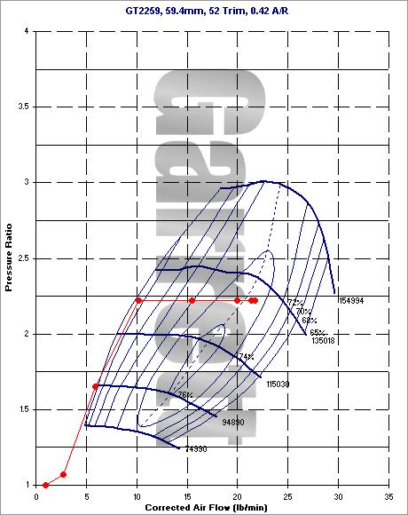

Sorted out a spreadsheet and messed around with numbers.
How does this graph look?
About the right turbo?

Or does this look better?
I think the 2056,
it leaves more scope for adding boost, and also it has a higher efficiency aboyt where you peak power is going to be
