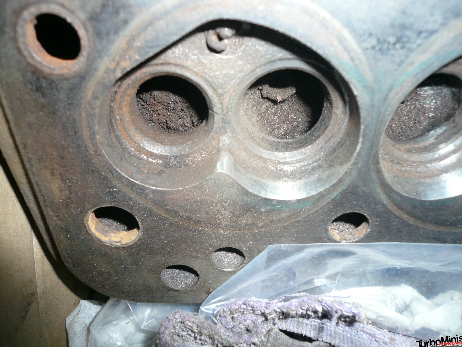

The 202 has a VERY good potential, but it needs work. The ports are very different from a standard 998 head, I don't agree with you there.
Oh, one more thing. I'd have the head bead blasted or soda blasted around the notch in the exhaust seat. They easily crack because of this and if it has, it's so futile spending hours and money on it.

If that is a crack, and not just a "cut" throw the head in the bin. Have it blasted to determine properly.

My english show its lacks here, what is the difference between a crack and a cut ?
The depth of the damage ?

On 17th Mar, 2004 Vegard said:
I just received a cracked 1275 head. I did carve out the seats to fit hardened seats and then had it pressure tested. No leaks at all.
Do this, and you'll find out if it's scrap or not.
as seen in http://www.turbominis.co.uk/forums/index.php?p=vt&tid=853
So is your advice of binning the head in regard to the cost involved ?

Due to me not blasting the head as a starting point, I later found a crack.
Now I wonder if my 998 in N/A form is better with a high comp 202 (say 10,5) or a low comp 295 (say 9,4).

And by the way, the 202 is off to my dad's place to try welding it.
I'll keep you posted of the progress
Welding a seat is useless. You cannot properly cut the seats afterwards because of the hard metal (weld) If you still do weld it have a seat fitted, if not the valve seat will wear unevenly and wear out in no time.

thanks for the advice and the added picture, speaks a thousand words !
so, about the welding, I have been told about arc and sticks of cast iron (we have an arc welder) but my dad is more keen on oxy acetylene to create a pool of metal in fusion (he knows his way with welding but has not done any heads so far)
To your knowledge, wich one has the most chances of succeeding ?

On 5th Mar, 2011 stevieturbo said:
I wouldnt necessarily worry too much about the cracks between the valve seats. I ran mine for a very long time like that, and it never seemed to get much worse. Detonation is the main cause though.
How about that ?
I am tempted to do a quick valve job and hope for the best !
