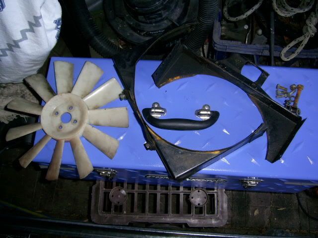

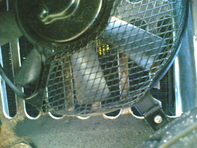

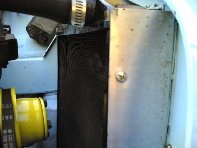

Both my minis (a stock 1098 & a not very stock at all 1430cc) run without a pulley driven fan. Both normally aspirated, running stock radiators with scrapper electric fans, one Nissan and the other Suzuki.
I prefer to remove the original mini fan, radiator and shroud & mount the radiator to the body with the fan drawing through from under the wheel arch.
Good enough for 40 C + temperatures here in Oz.
Tips:
- make sure fan is blowing the right way
- use the factory shroud that cam with the leccy fan
- don't use long screws as they can pierce the radiator core :$

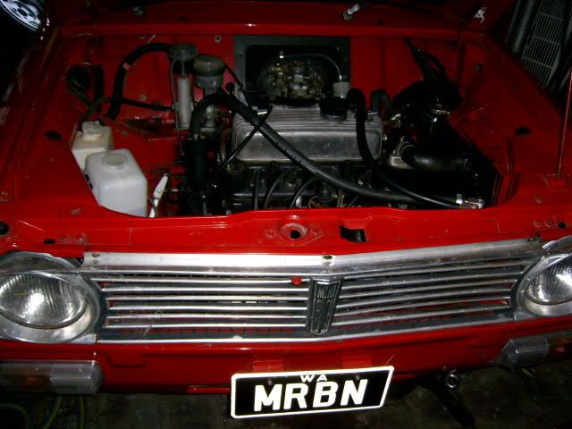

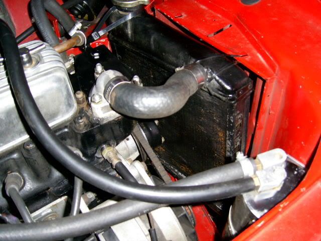

As promised, some engine bay shots
Not running any fan at all temporarily as I'm about to do some rewiring.
and these are the surplus bits. Should help offset the weight of the thermo fan.
Note that you'll need shorter bolts for the water pump pulley without the fan fitted.
Can't take any shots of the Countryman as its been stripped & getting a new motor and subframe.

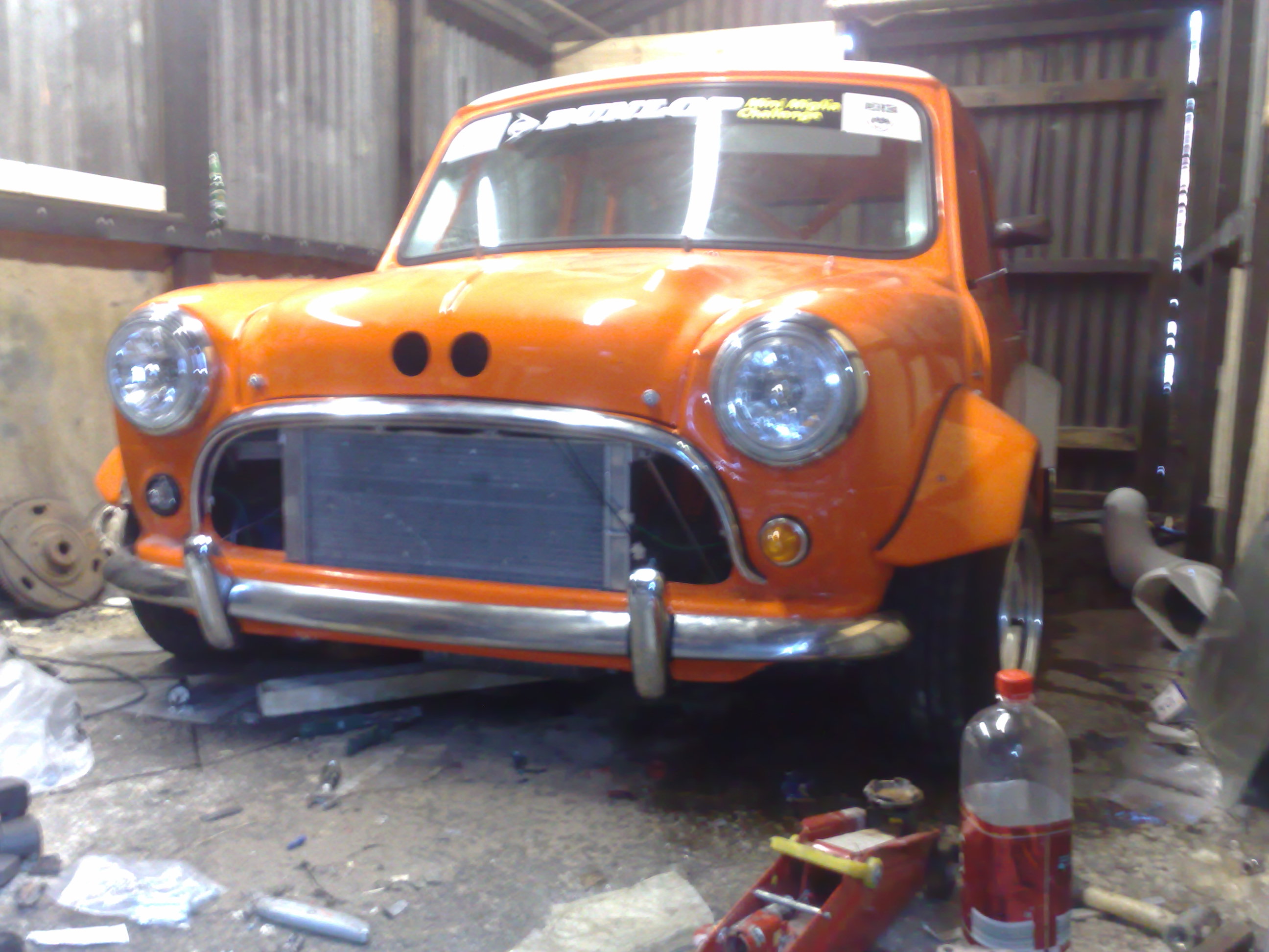

Did you find mine?
http://www.turbominis.co.uk/forums/index.php?p=vt&tid=196359
works well, I think the cowling is worth the effort..
