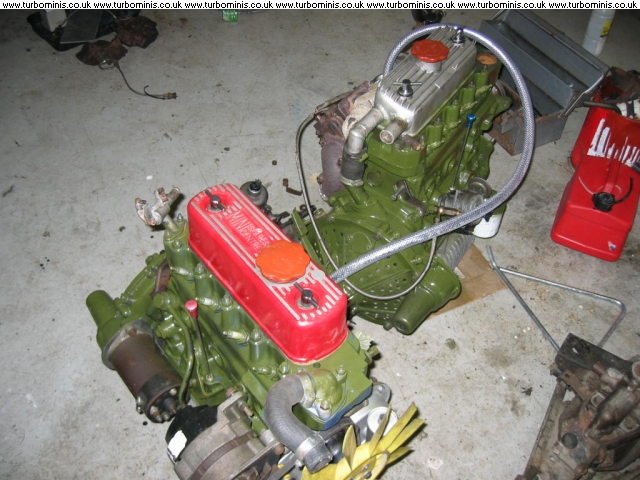

On 22/04/2005 16:08:27 Jimster said:
dave, how many gallons of that green paint do you use a year?
Do I beat you Dave??
First. BIR engine, and N/A 1380 for a friend:
Then my GT's engine:
BEAUTIFUL, and not eeh...Chav ..(Coff) Red :)

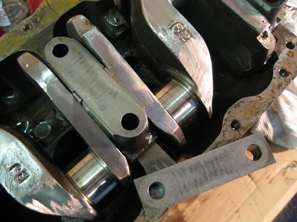

So, now I've quit using main straps after seeing this:
That's my own racing engine.
4309 Posts
What rpm was that spinning too?
7300 max.
http://www.youtube.com/watch?v=D7NtzN22U-4
4309 Posts
To be honest looking at the size of a standard cap I'd be suprised if it would move anyway, fit some decent dowels and I'd say you'll be ok up to 8k. Well I have been with standard cap anyway.
Edited by minimole23 on 8th Nov, 2011.
6966 Posts
So you are going to stop using steel straps because you have seen how rough your crank if finished off, lol
how many meetings did it take for the crank to look that rough,lol
carl
