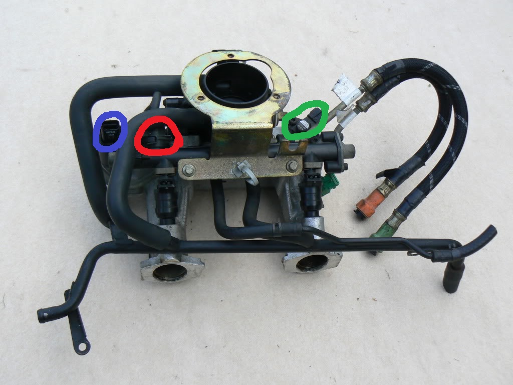

Hi guys, its been a while since I was here. I have made up my mind of buying an MPi manifold. Can you please identify the three objects encircled in the photo ? I'm not so familiar with this type of manifold and haven't ever seen one in my country. To my knowledge only three Mini MPi's have been imported throughout the years to Malta.
Thanks in Advance
Blue is an idle air control valve. The red is the fuel pressure regulator. The green is the MAP (manifold absolute pressure) sensor.
To be honest, these parts are fairly common on many engines.

Yep I know but wasn't able to identify which one is which and I wanted to make sure before actually purchasing one. Thanks mate :)
One question. Do you know if the idle air control valve on this type of manifold could be operated with a Megasquirt MS3X ?
Also since this manifold has both a TPS and a MAP, which is the best of the two to be used as a load parameter ?
Thanks
The Rover IACV may work with the MS3, but I have always swapped them out for Peugeot item, part no. A95269.
Best to use MAP if it is avaliable. The MS3 has a built in MAP sensor, so you do not need the Rover sensor.
