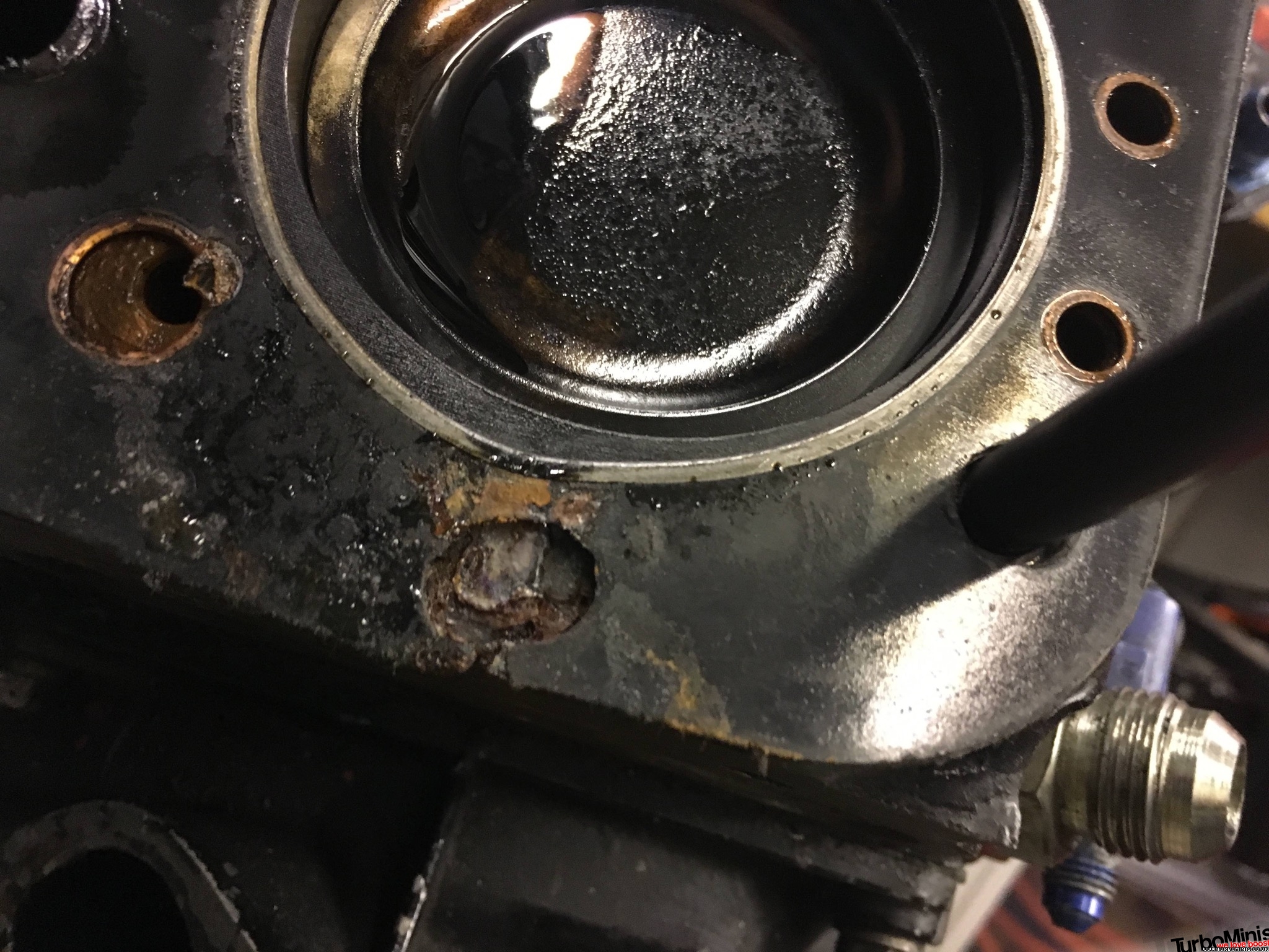

Well that was flipping close! Had this gasket on for 4 years. It’s been hanging on for dear life!
Should’ve listen to Tom when he said “11 stud will fix that” around ten years ago.
4642 Posts
Just re-read all this, nice work. Are you still running the sidemount ?
Phil.
