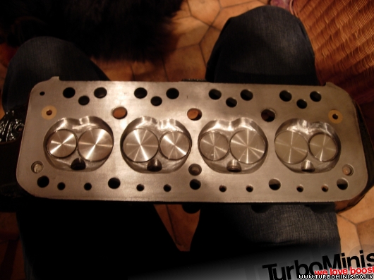

Awesome!! Got my head back from Steve, and I knew the standard of his work before, but the attention to detail that has gone in to every bit of it is fantastic, everything is perfect!! Thanks again Steve, recommend you to anyone.
Steve did me a fully worked head, aswell as ported my exhaust manifold and turbo elbow. Also modded the exhaust clamp for downpipe fitment! Unleaded head, giving me a pukka 8.5:1 compression ratio:

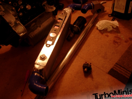

Got a front mount intercooler like a few of the guys on here, which was a great price and is top notch!! Going to fit like a glove behind the clubby grille. Mk1 metro rad with the connections on the same end (thanks James for the switch, owe you one mate). Aswell as a Nic/Hywel plenum (thanks guys!).
Zena racing silicon hoses, great price and fantastic if you don't want to fork out for exactly the same thing that says "Samco" on it instead.

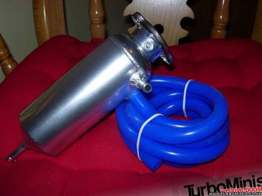

Got a bargainous expansion tank, but snapped the overflow pipe on the neck off when fiddling with a piece of blanking hose that came with it, doh! *oh well*

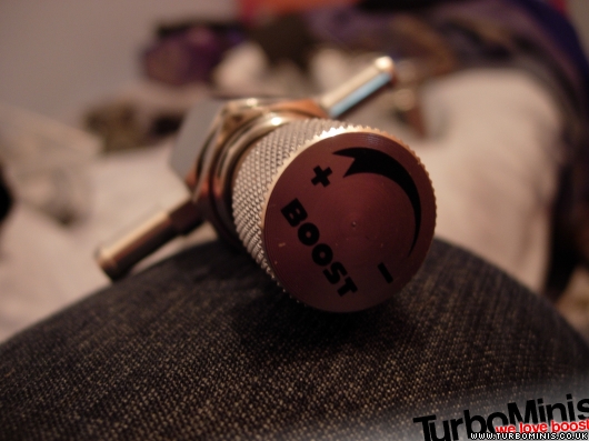

Bleed valve:

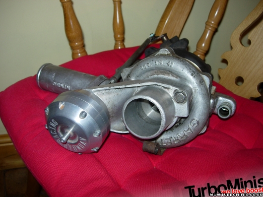

The T3 with avonbar actuator, set it at 5psi ish preload for the minute while I run it in:

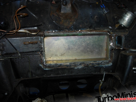

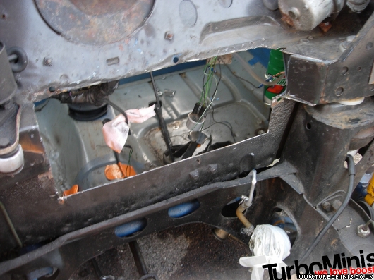

I cut the bulkhead for the clearance box and put the actuator angle in aswell, my mate Mike welded it in for me:

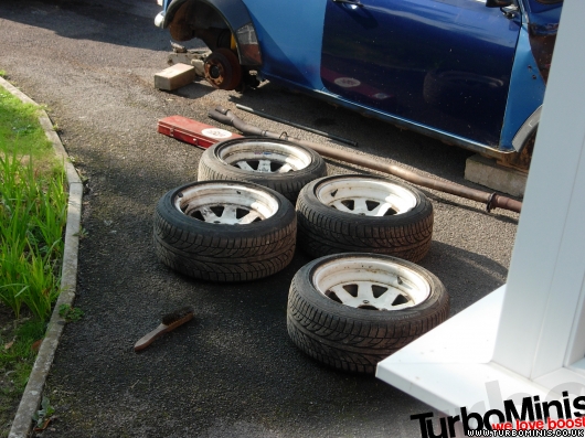

And swapped my ultralights with a guy at combe with some 7x13 wellers, with bran spankers tyres! Got them shotblasted aswell, got a funky idea for them, going to look sweeet!:

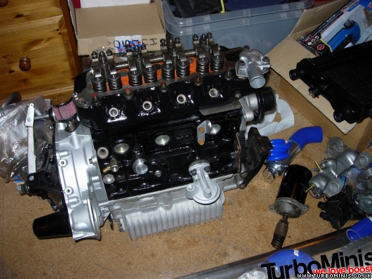

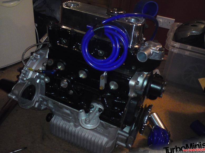

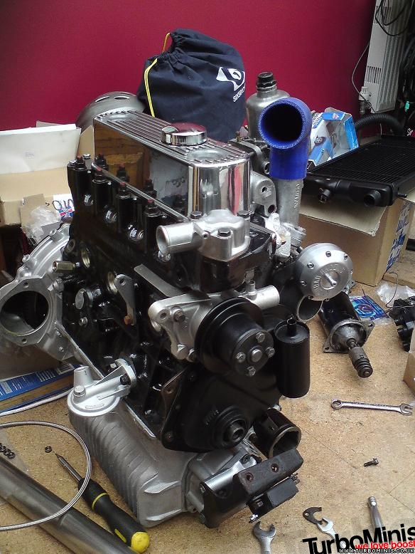

Got the engine 95% ready today, feel so close now!!
Got the head on, rockers on and all torqued down, need to set the clearances still but that can be done on the car:
Had to file quite abit out of the lugs on the exhaust manifold as it was fouling the studs quite abit for some reason. Turbo then went on, had a bit of a nightmare getting one of the manifold to turbo nuts done up, the one nearest the block on the compressor side, took the actuator off which gave me just enough angle to nip the swine up! :
Routed the oil feed, had a fiddle in a few different positions and now have it so the union points towards the block, runs against it and out to the clutch cover, keeping away from the hot bits on the back!:
