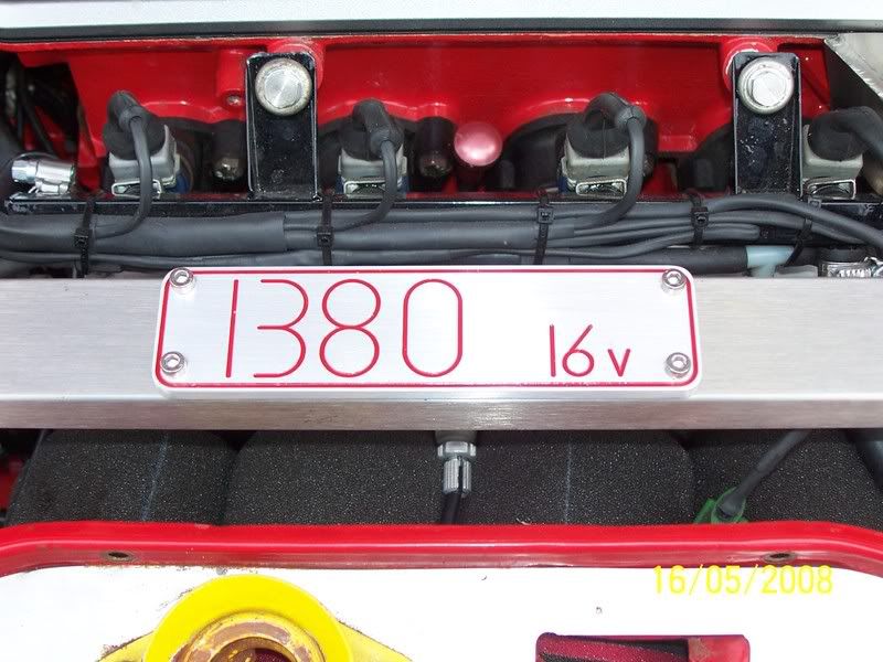

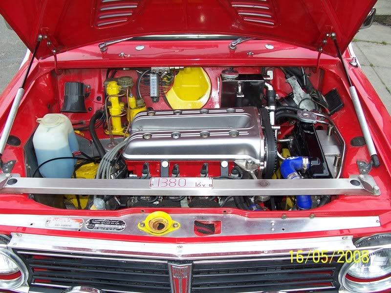

Hi lads a quik update cars running excelent g0t 1400 miles on now its spot on had a couple of problems along the way main one being an oil leak from head gasket, now qured blocked off origional holes and ran an external feed, well run in now so i must get it on the rollers for final seting up and a power run, only problem being i just want to drive it LOL, heres a couple of pics of the finished engine bay and a side view.

That really is a top job :)
Hope my estate turns out that nice.
