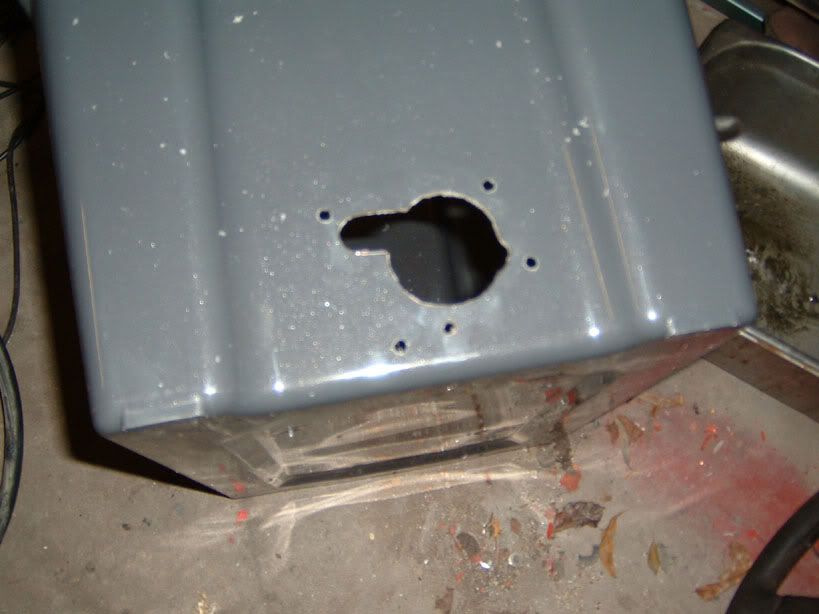

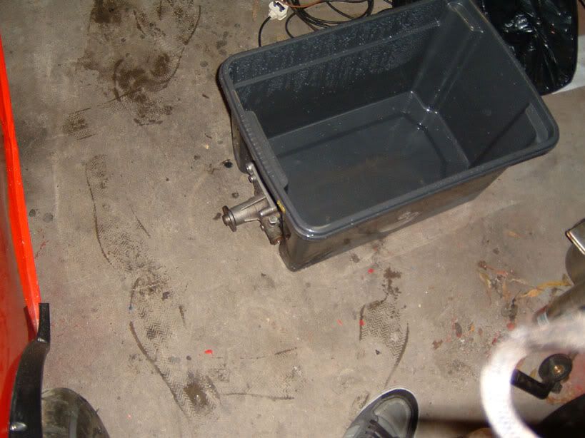

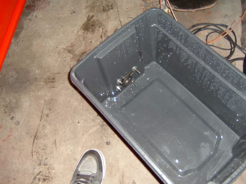

Right, this evening i knocked up this:
Although i then realised that the water is flowing the other way to which i was thinking just to make life difficult.
So, i then need to get another tank going to the inlet, fill this one above the impeller, mark the level, and work out the difference.
My main problem is gravity and it improving the flow of the pump as it seems to push quite a bit of water through, and i need to make the face the same thickness as the block
That should work a treat mate!
Can't you strengthen the sealing face by making up a couple metal plates to sandwich the plastic side?
Bit of a PITA to make but can't see another way round it?

It' all well and good doing that BUT the impellor is not open to a tank of water when it is fitted so I would question wether the test is valid.
Dave
But wouldn't the tank of water kind of replicate a bit of pressure or at least give some resistance?
If you did the test 3 times and took the average flow, then drill a hole in the bottom of the box and drain it into another container you could test the difference of flow between the pump with and without resistance.
Edited by matty on 28th Dec, 2007.
I recon around 80 litres a minuit on an un restricted pump at around 2500rpm
