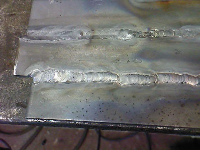

And for those interested, some of my shameful attempt at TIG welding so far. That is mild steel, but stainless looks similar.
AllanMcD
612 Posts
Member #: 414
Dalbeattie Scotland
That looks OK to me.
Allan
http://www.rabdunn.co.uk/
not too shabby.
sheet steel is a bit tricky, ( i find) ally disipates the heat quicker and as a result is easyer not to blow apart.
check you havent got the gas too high, i find 8-10 cfm pretty good for most stuff, if itgoes to high it can blow the arc about.
