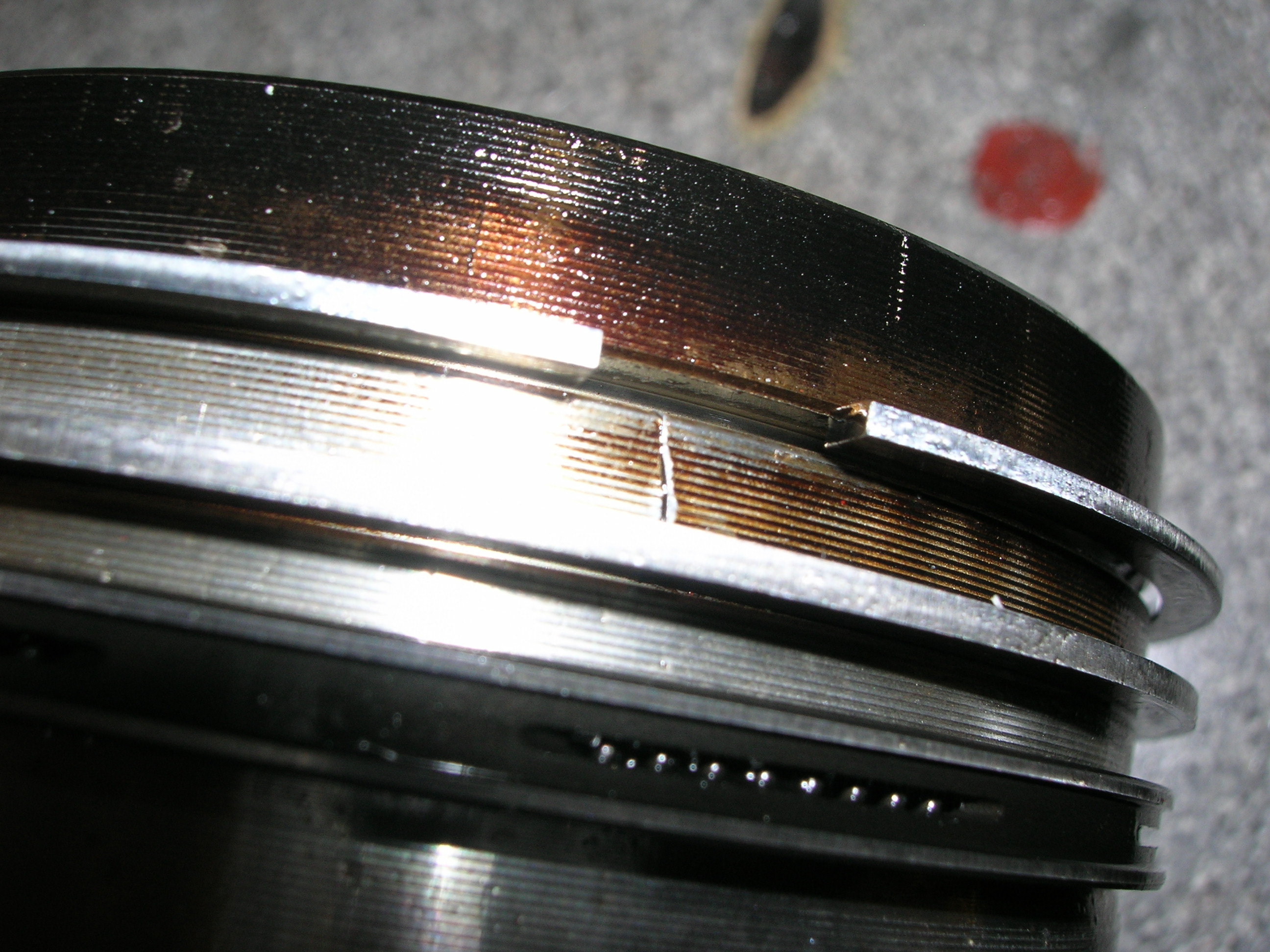

This is the piston that hadn't failed (yet!)
'Where does the engine go?'
Steve, Looking at the (outer face of the)top ring itself, it's no wonder that piston failed. was it ever set up?

No Dave,it was timed and fuelled according to data from this site,but not on a RR. what do you see on the top ring outer face?
miniminor63
1849 Posts
Member #: 672
The oversills police
Oslo, Norway
its half melted.
