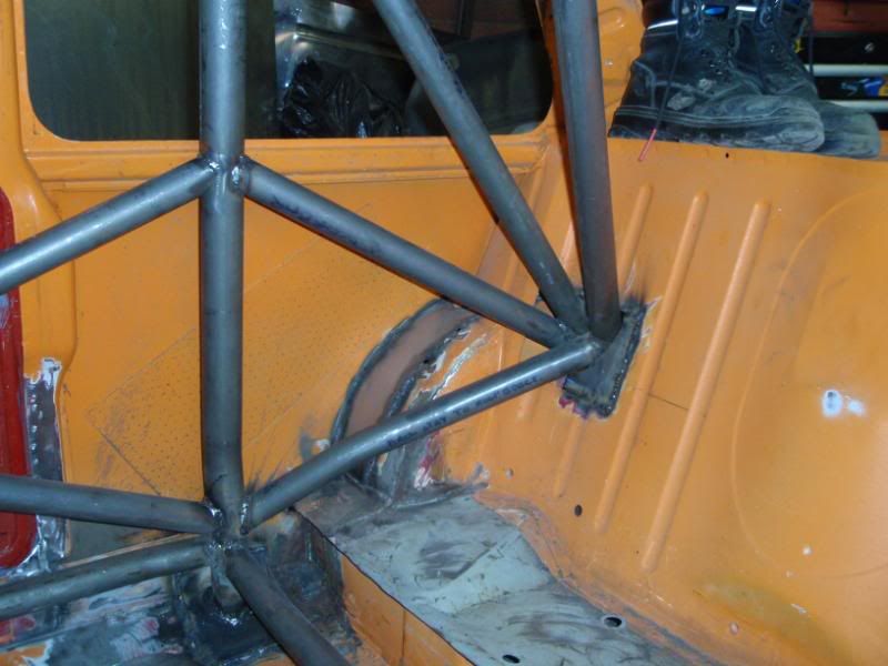

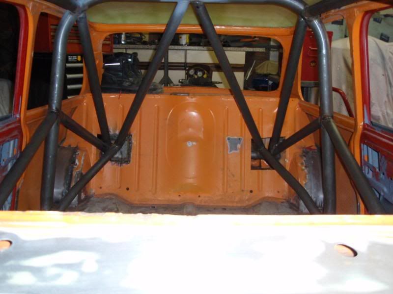

More upto date pics of the cage, rear legs are all in place now and front bars are under way:

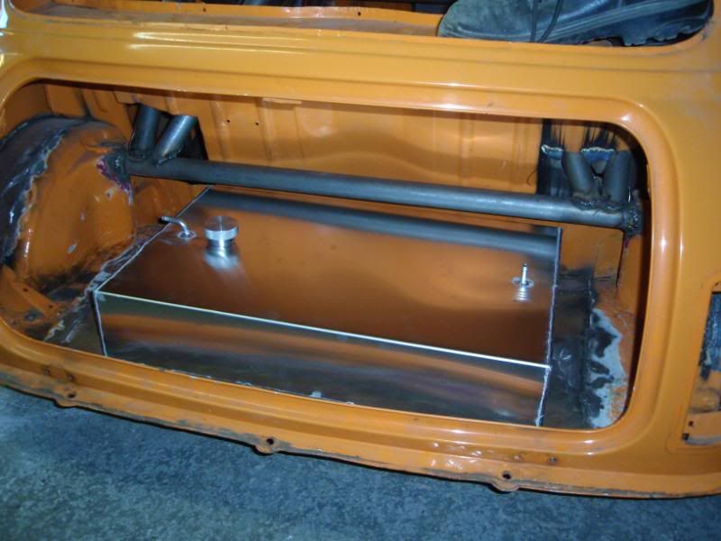

Got a fuel tank, just need to get a splash bowl welded on:
ooo where was that tank from? what that capacity? and how much? *happy* haha!
p.s i picked up some ally door skins at bingley *wink* woop just need to get some cheap doors now because i sold mine for £80 odd bucks!
advantage998
458 Posts
Member #: 1840
Kings Lynn, Norfolk
Off ebay, cost £95 inc postage. Item no: 170296847031.

i think i have seen those tanks before and was debating getting one. what are they like first hand? whats the quality like?

Tbh you do get for you pay for, there not bad at all, one edge is a bit distorted from heat so has a slight ripple to it and there not baffelled so idealy will need to be foam filled, welding is pretty neat though. Will get some close up pics for you.
Yeah would be really simple to fit a sender, don't think i'm going to bother as the way its going i dont think this car is gonna see a mot ever again, lol.
hahaha!
30 litres....about the same as a standard mini tank? or more?

James, a standard mini tank is 34 litres.

Standard is 35L iirc

Look identical to my Allard tank, even looks like there's an Allard logo on the filler cap, I wander if ARP is another name for Allard.
When you fitted your rear hoop how far back did you fit it? I've been test fitting mine and I'm half tempted to fit it slightly forwards so that the heal bar sits in the grove in the exhaust tunnel but I'm not sure if it'll give me enough space to fit my seat.
advantage998
458 Posts
Member #: 1840
Kings Lynn, Norfolk
The address on the box was allard motor company, so pretty sure its the same. You fitted a splash bowl to yours yet?
Its fitted as far back as i could before the front legs were too short, Hmm think that'd be a bit too far forward, i've run mine at the same heigh as the tunnel and run a seam of weld to tie them together.

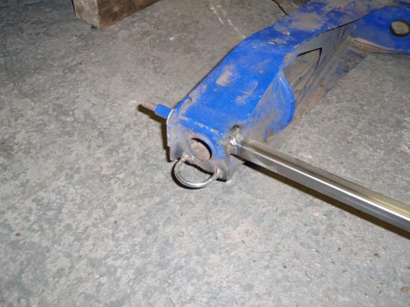

Few updated pics:

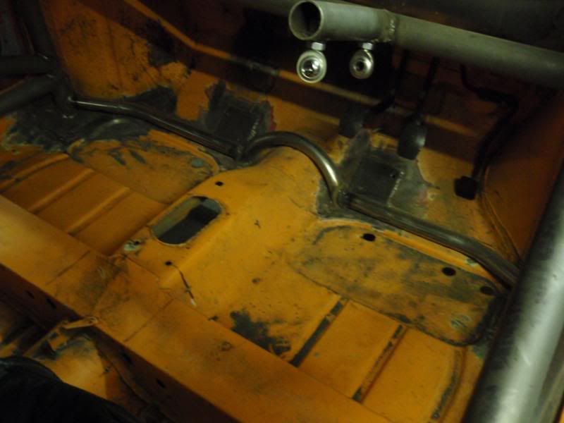

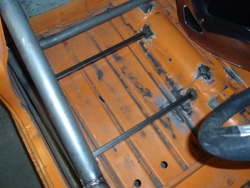

Floor brace in:

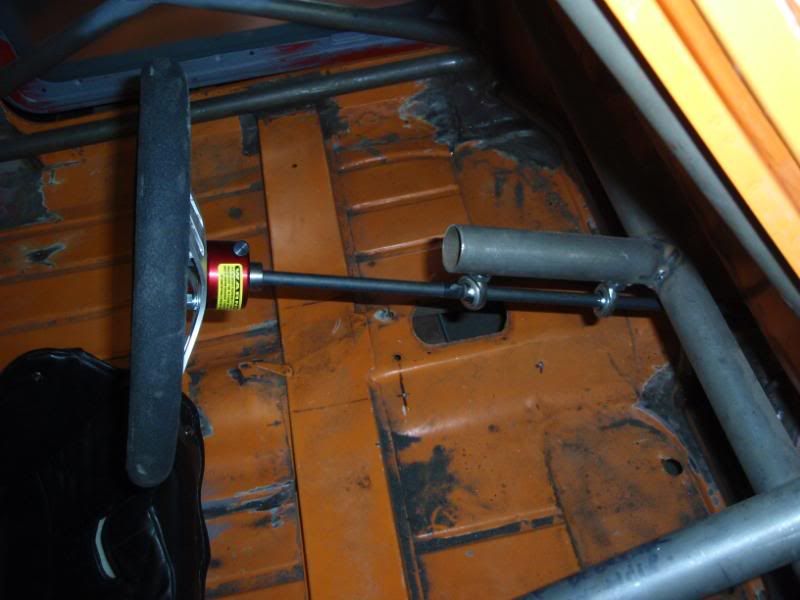

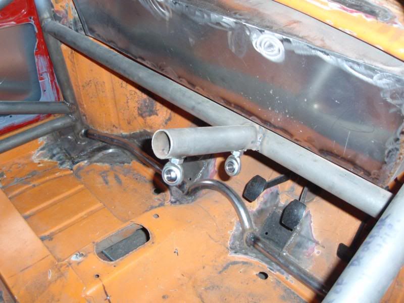

Steering column mount:

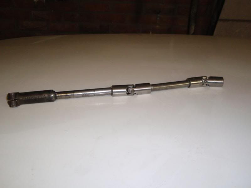

Mock up of lower column, just need to get the uj's machined out:
Seat mounts welded in:

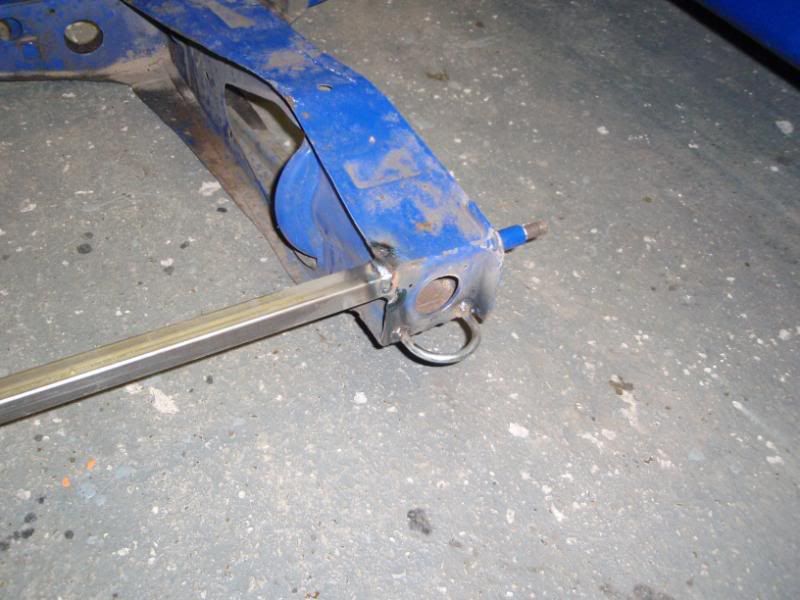

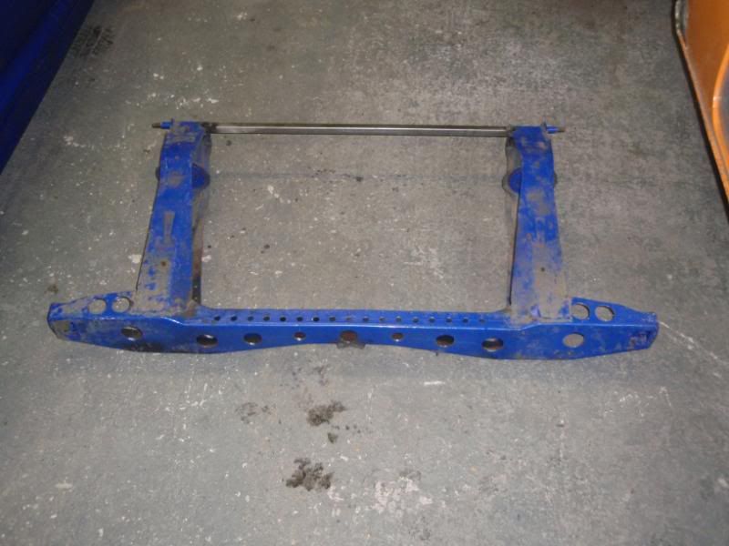

Rear subframe with a new rear section, and lightened a bit:
Welded some tow rings to it:
Si P style lightened subframe:
Quality mate, what more can i say.

Well done mate coming on nicely. Subframe looks good. Loving the name check. 8-)
Those front inner holes need opening out too.
Si
