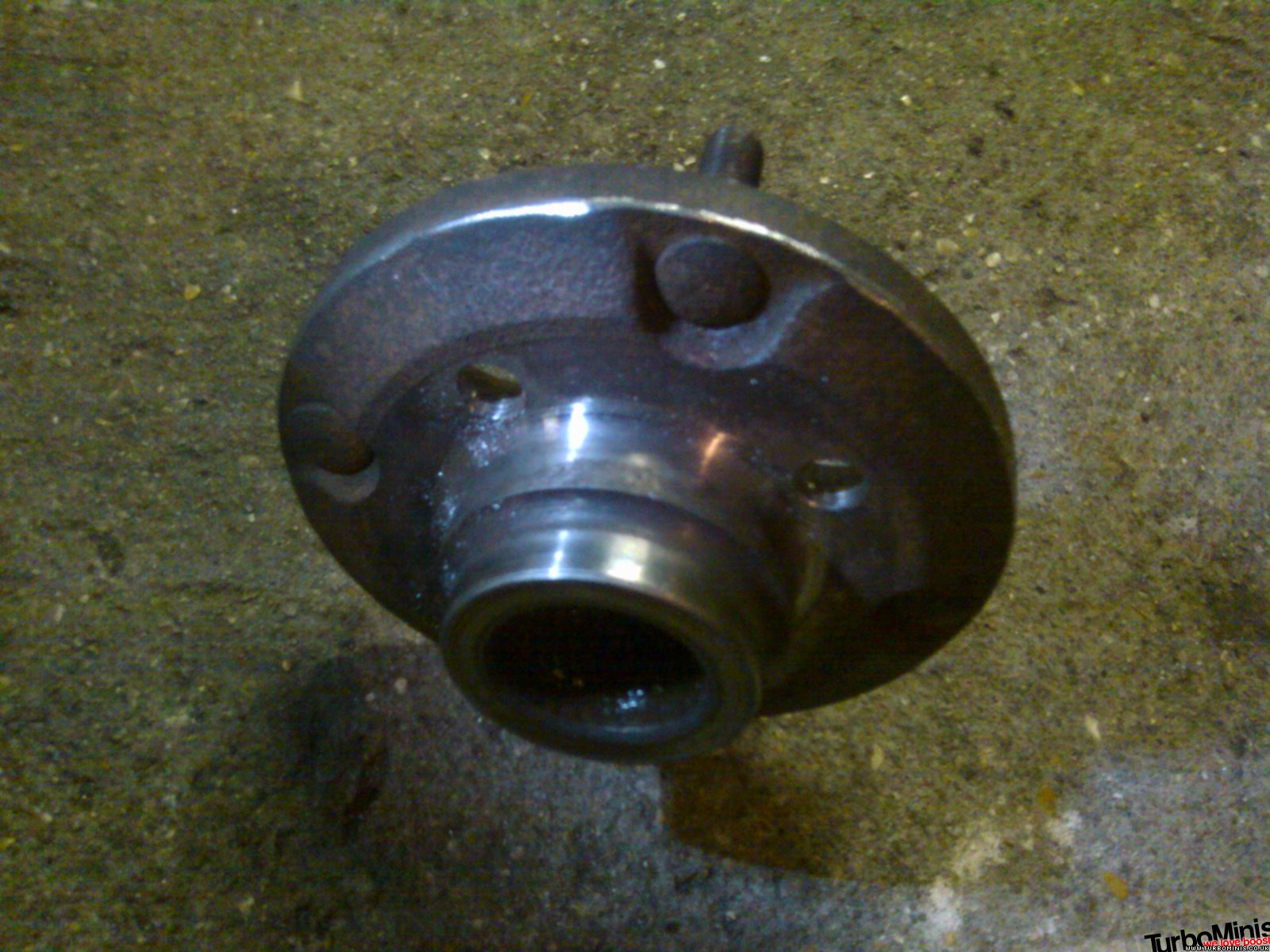

Advantage
1137 Posts
Member #: 1450
Near Paris - France
Downside is I found the LHS as got a Metro hub and bearings falling off for no reason ...
Second downside is I found out I'm better off with Metro hubs as they help with the wheel not hitting the front of the wing when turning on full lock ...
Anyway, it's VAT free week so I am gonna treat me with something shiny.

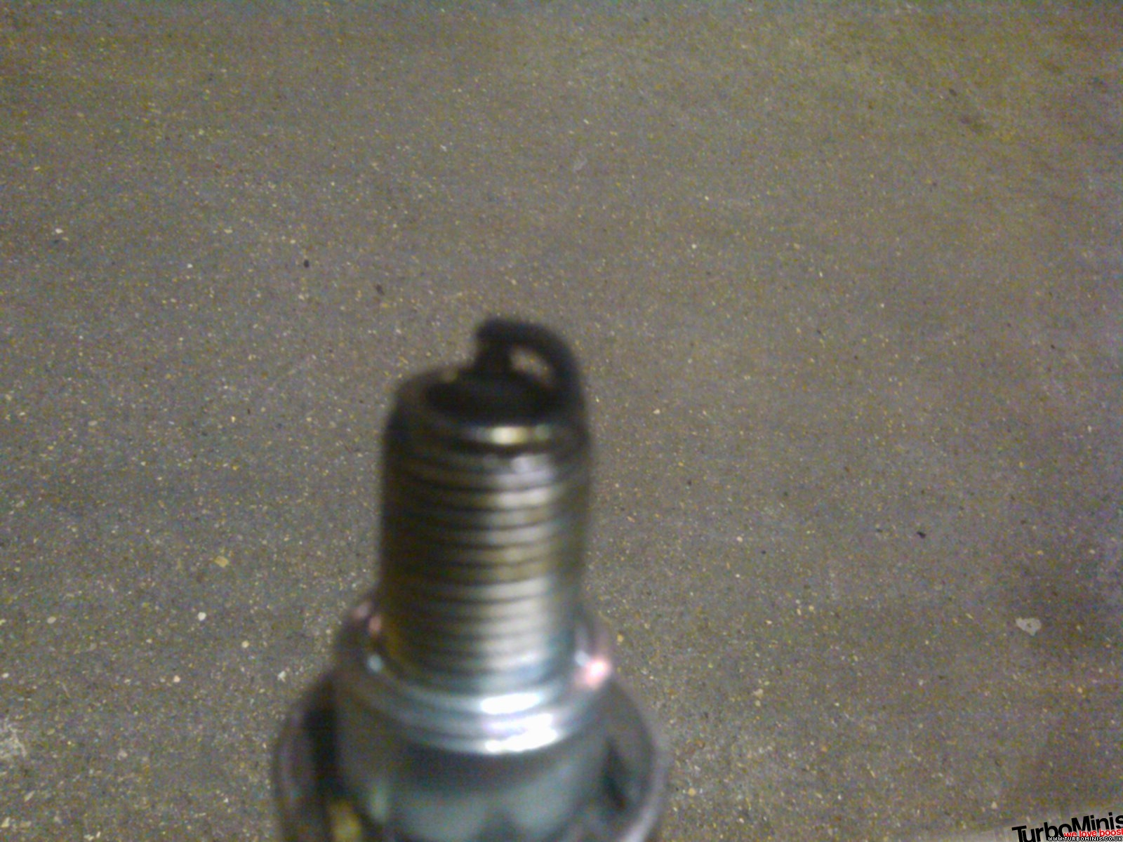

Engine is now set-up as good as I can.
Only running on 3 cylinders though.
Plug n°1 was black and wet ...
Should be down to leads or distributor cap but timing was set using the lead of the non working cylinder so it might see some signal ???
I changed the plugs.
Previous plugs were BPR6ES.
Was the R for resistive ?
I bought (and now) fitted a set of BP7ES as recommended by minispares.
Plug gap is 0.8 mm as I have an electronic dizzy.
Sorry if it is a little messy but I am a little lost here ...
Rusty by nature

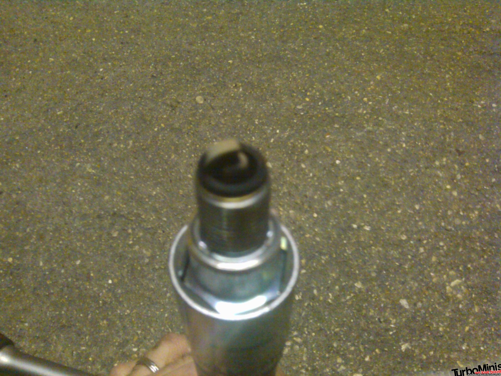

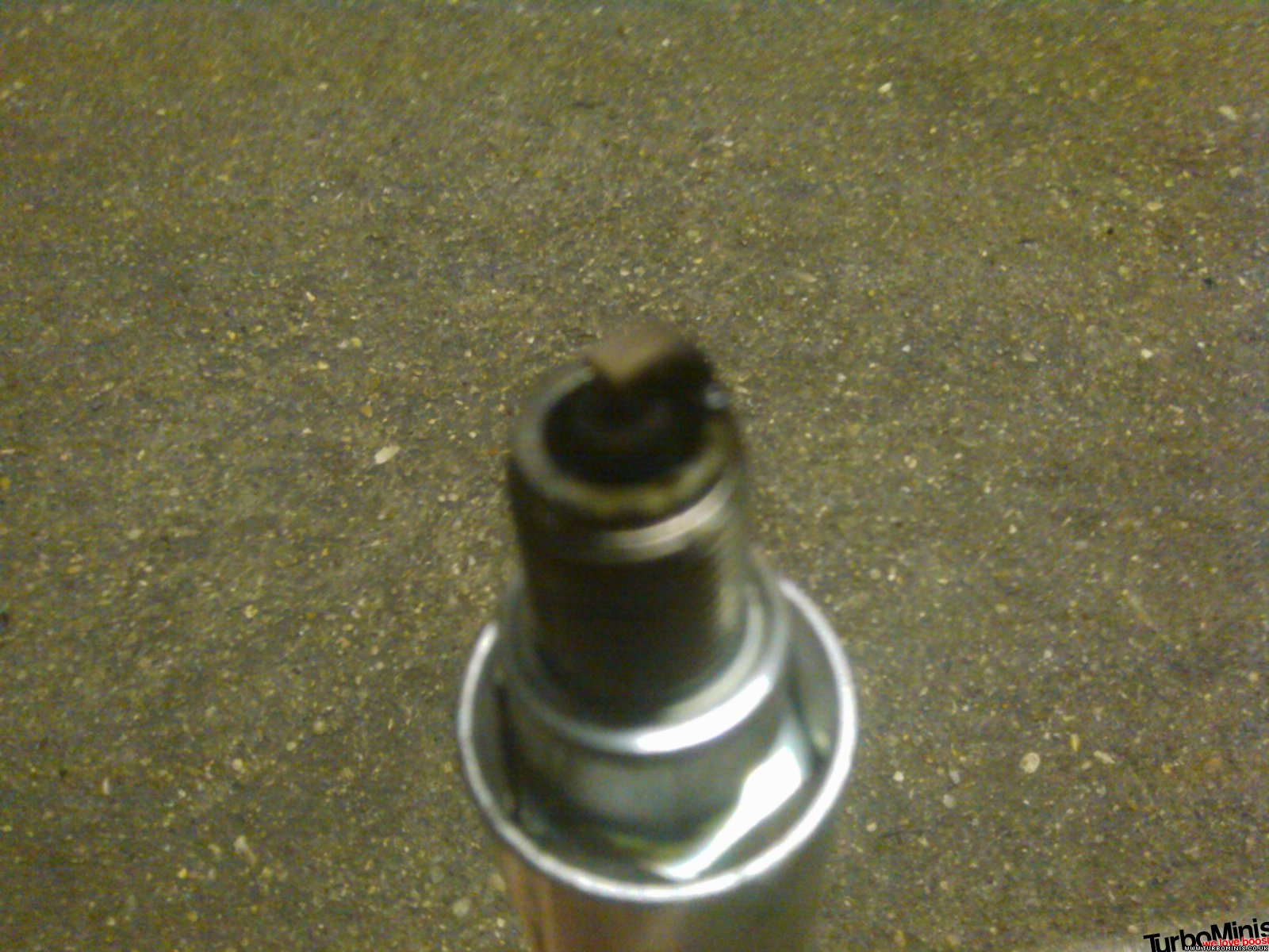

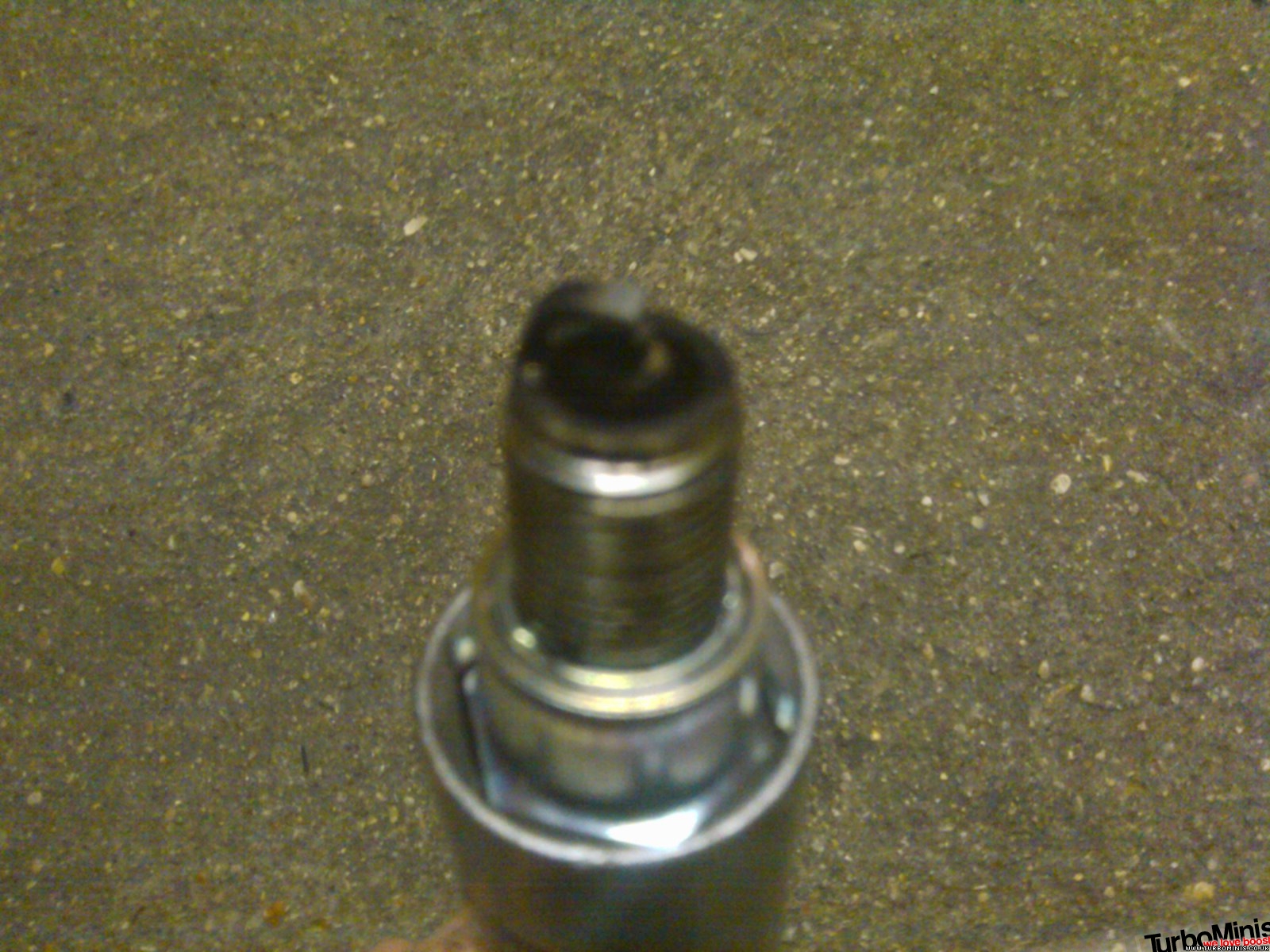

Advantage
1137 Posts
Member #: 1450
Near Paris - France
Plug n°4 (clutch side)
Plug n°3
Plug n°2
And the loser is :
Plug n°1
And that is after roughly 10 minutes of running.
Trouble is I cranked the engine over with plug n°3 then plug n°1 out and they both have sparks so this kind of rules out electronics problems.
Now I'll have to have a leakdown test done because I have been told that if the compression is very weak, the mixture can not be ignited hence the wet and black plug.
The 202 I was working on might have to come into play sooner then expected ...
Rusty by nature

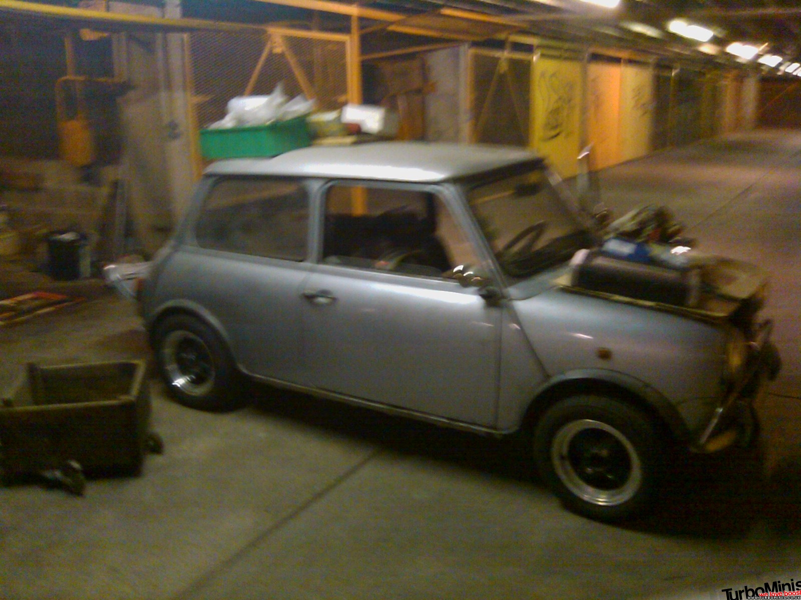

Advantage
1137 Posts
Member #: 1450
Near Paris - France
pic of my car
Rear need to go up a little but first I have to get rid of that oil leak from the transmission.
Is it the good time to fit my X pin diff as I replace those gaskets ?
