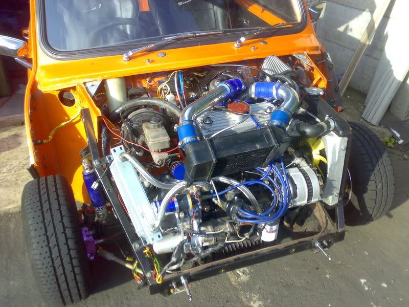

just fitted this
RS turbo intercooler, may as well join in with the cake brigade although its only a fairy cake :)

One of those coolers should be front mounted man!
chinlesswonder
530 Posts
Member #: 1192
In the garage......again!!

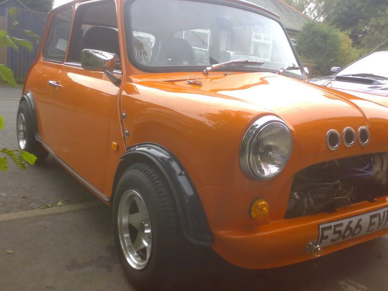

The intercooler is right at the front and i have some holes in the bonnet for the air, the oil cooler i'm not that sure i really need, so tucked it out of the way so as nor to overcool the oil. I may remove it yet. Anyway, its MOT time tomorrow so wish me luck, trying to get this sorted for castle combe this weekend, i may drag it down for a run anyways.
This is how it looks at the minute with the cooling holes .

looks great mate.
Markie_D
862 Posts
Member #: 1660
Formally Mini_Uk
London
Looks Very nice :)
Love the colour.
