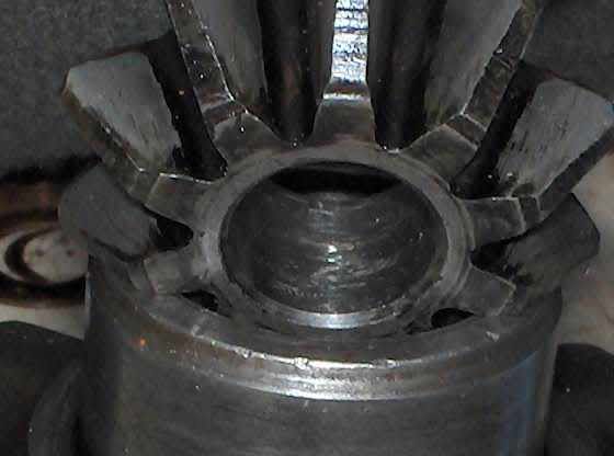

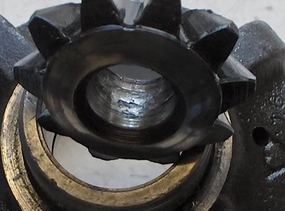

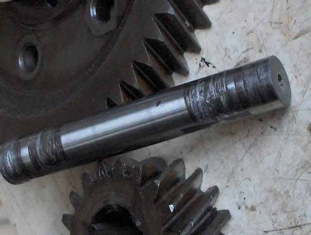

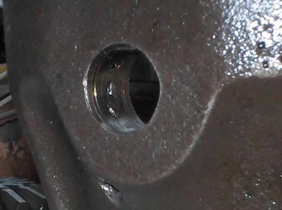

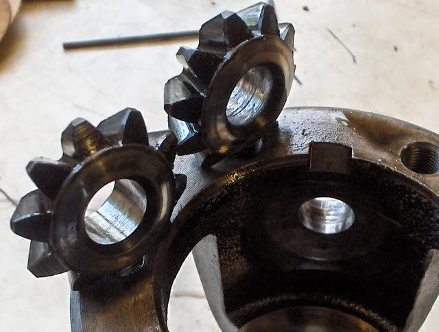

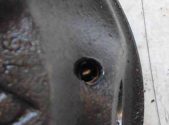

How about a 'file test' to see how hard this pin really is at the surface?
That looks like it was significantly softer than the pinions?
hmm good idea dave,
the stuff on the pin end is where it had welded part on the case to itself as it rotated at high speed with the gear .
the planets look worse ill get them out of the case and put up a piccy ,looking at the tempering marks on the pin
id say that the planet wheels wore ,then friction welded itself to the pin ,and the heat removed the hardening on the pin , ,the end that isnt so worn ,has a worm pinion but it hads not got hot enough to remove the heat treat from the pin yet ,so id say its harder than the planets ,but once it gets hot enough it goes soft .ill run a file over it and see .
some more pics ... the pin shot with the little shiny patch is where i tried to make a mark with about 7 strokes of a file ende on ,,,,so it is pretty hard .
the other pics show palnet gears and the roll pin ,which seems to have wrapped itself round the pin in some way .
Well,
They're fu**ed.
