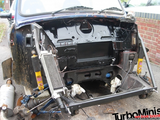

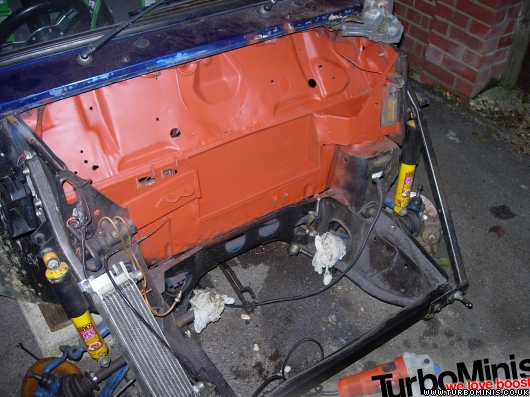

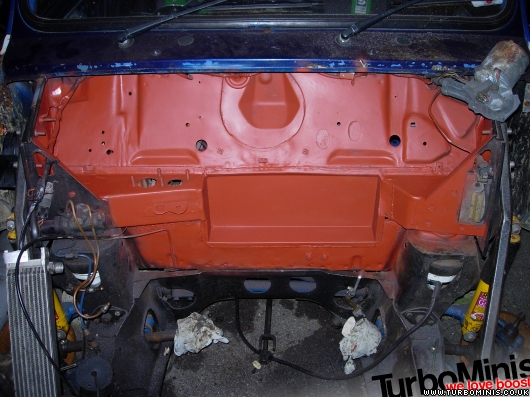

Got the bulkhead down to bare metal and gave it the red-oxide treatment, never sprayed with it before but I love it, goes on super nice!:

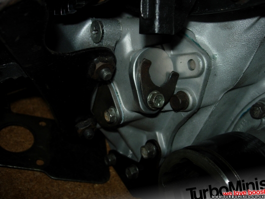

Then my friendly neighborhood fabricator (Ben) whipped up a nice ally blanking plate for my speedo drive:

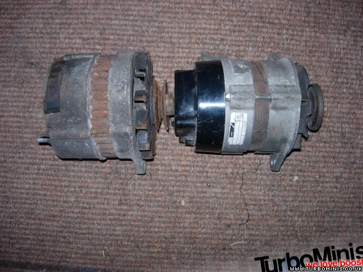

And he also bought round a spare alternator that he had, seems a little thinner than the standard one, but longer which isnt a problem. Tis also lighter!!
Cant really see it in the pic but its about 20mm thinner, every little clearance bit for my rad helps!!

why you blanking the speedo drive? digi dash?
Yeah planning to get one of these,
http://cgi.ebay.co.uk/Trailtech-Vapor-Digi...id=p3286.c0.m14
Took all the speedo drive out, less resistance hehe*surprised*

Gave the bulkhead a re paint so its looking fresher:

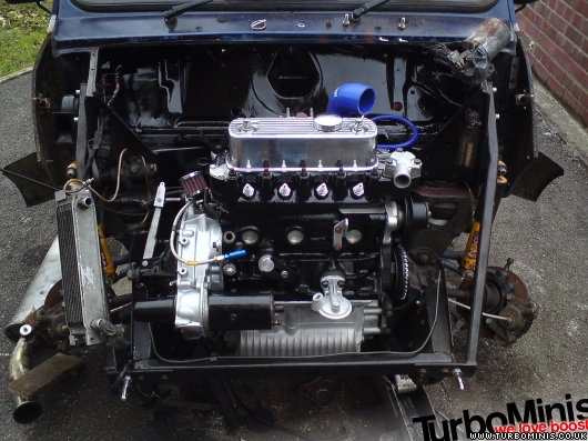

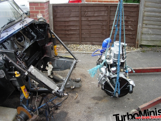

And got the engine out ready to be put in, was quite a mission and a stinking hangover didnt help!! :s
On the hoist!:
And with a bit of tweaking of the timing end mount:
Engine is officially in!!

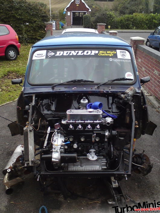

Next is to fit the carb and plenum, run fuel lines in the car, wire the pump, mount the fpr and connect everything up fuel wise. Mount the rad and intercooler and run all the piping for that, install the megajolt and plum all the vac related bits in, starter motor and bits like that - looking good I think!

looks brilliant mate - can i ask how you went about getting it back to bare metal around the tower bolt area?

I used a flapper disc all over the bulkhead to get it back to metal, and just really coarse sandpaper in the hard to get places like the tower bolt area and to key the metal.
Theres quite a bit of seam sealer in the corners there, which I just "flappered" away and sprayed over like normal, going to put some sealant in it at some point.

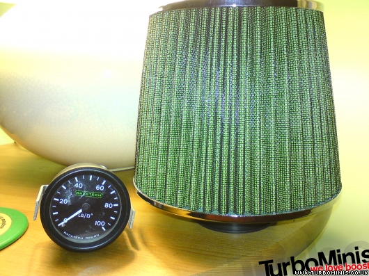

Got an air filter, as well as a 2nd hand but never used oil pressure gauge:

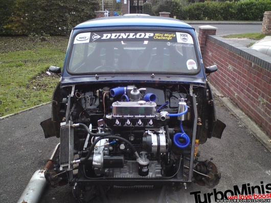

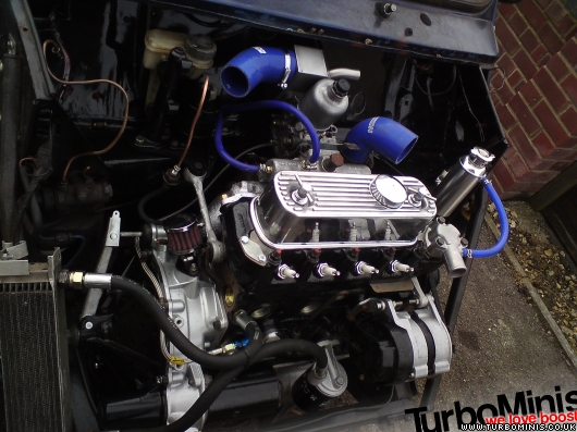

Got the carb, pleniniarm, alternator, oil cooler pipes + filter, master cylinders and header tank on now. Ooh and most of the vac hoses on aswell.

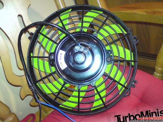

And got a 9" fan through for the rad, gave it a bit of a personal touch!
Yarr!
