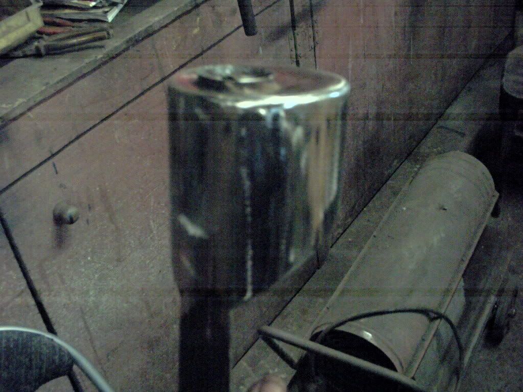

got all the brackets welded onto the subframe for the brake pipes and exhaust, i've cut the lugs off of the rear arms and taken the markings off, looks loads cleaner.
