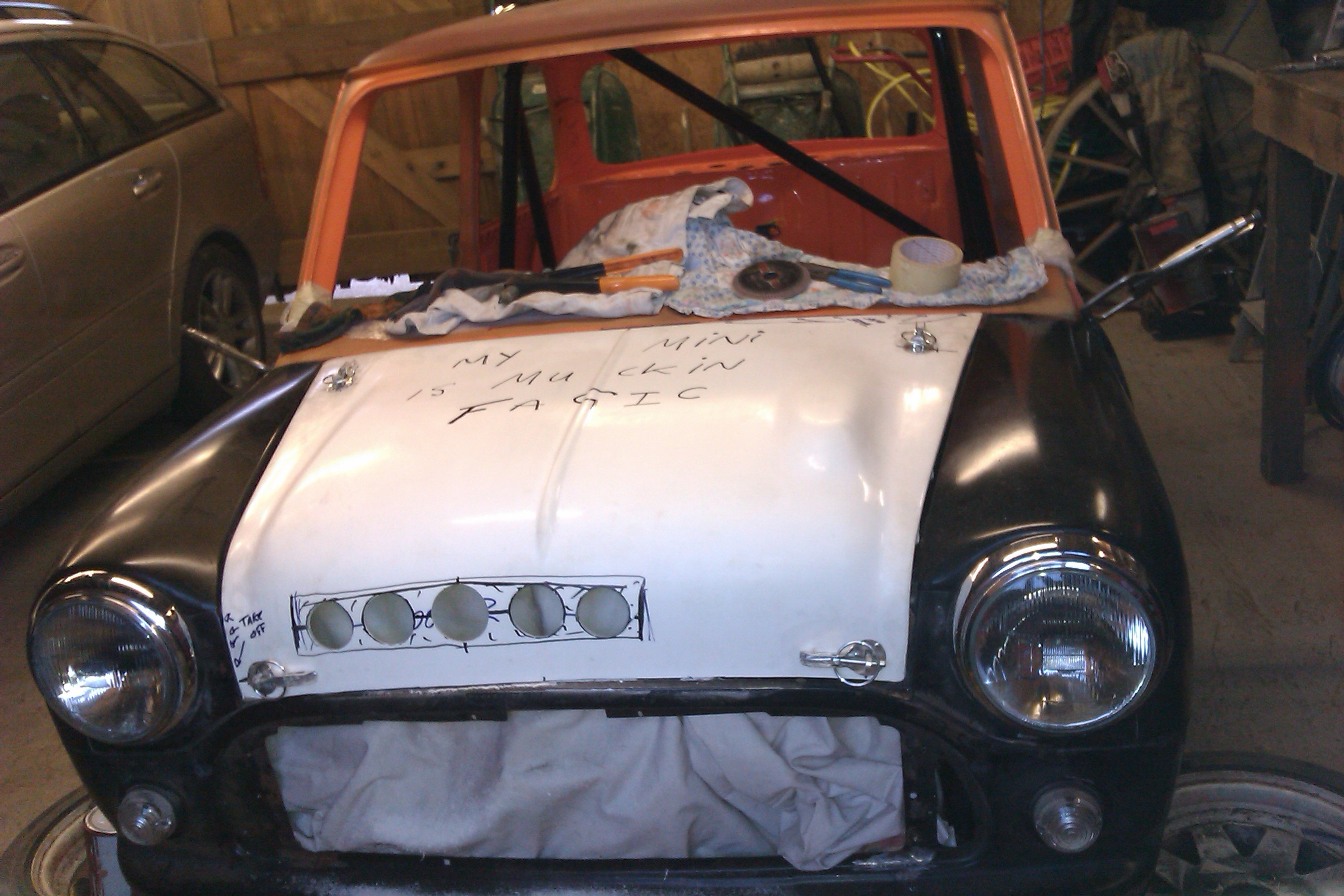

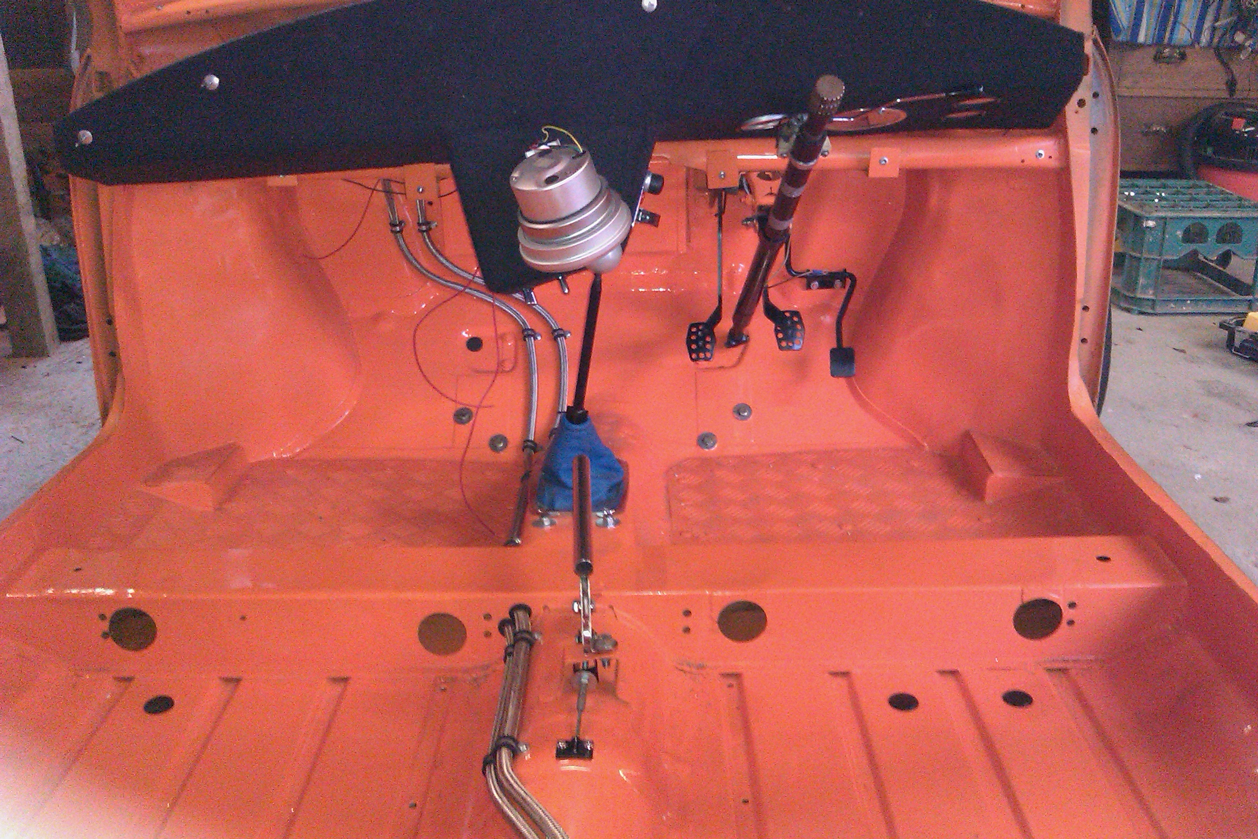

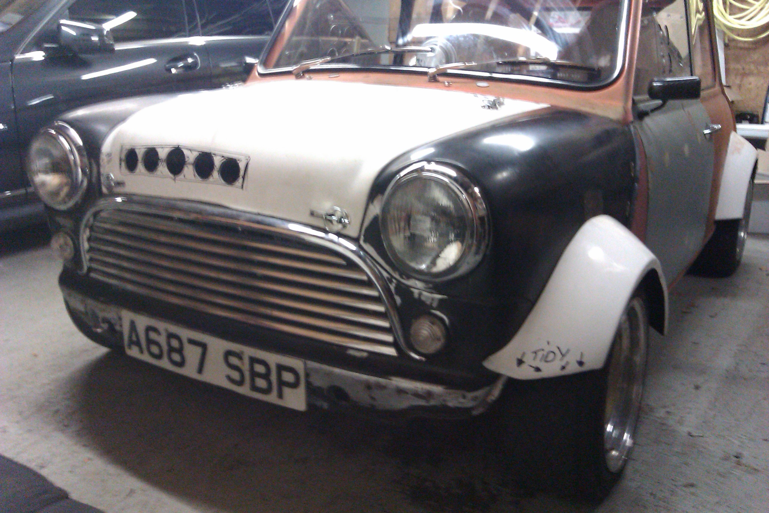

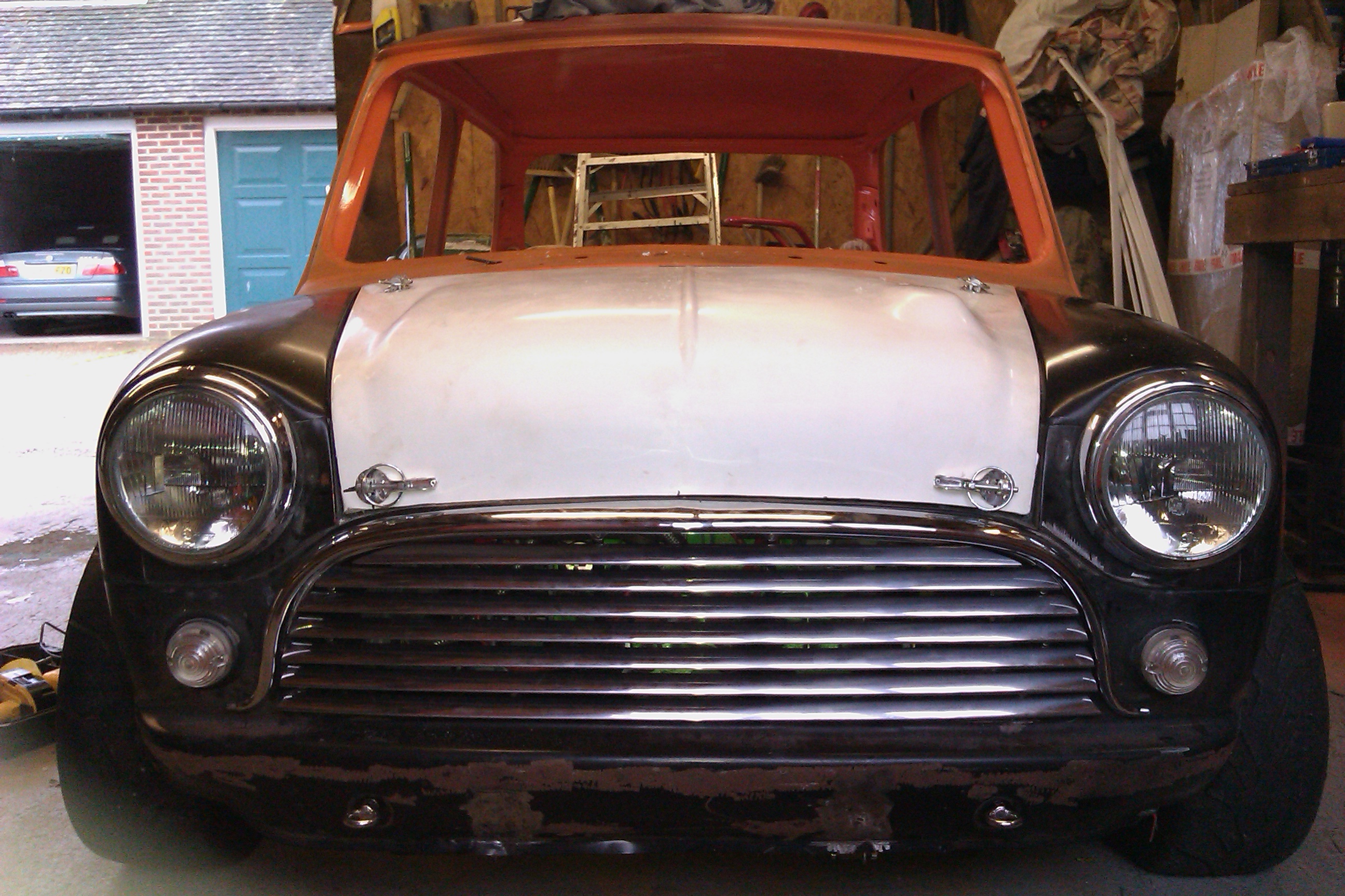

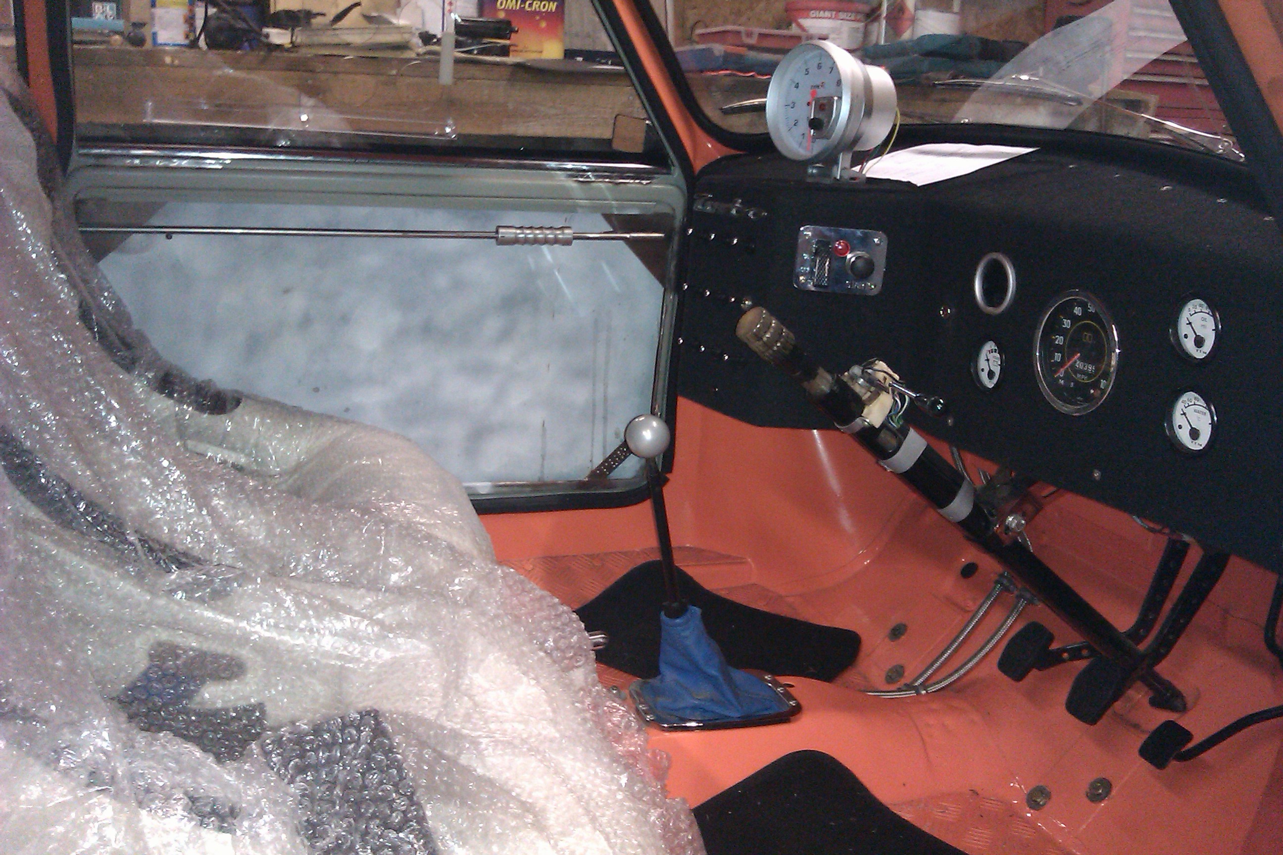

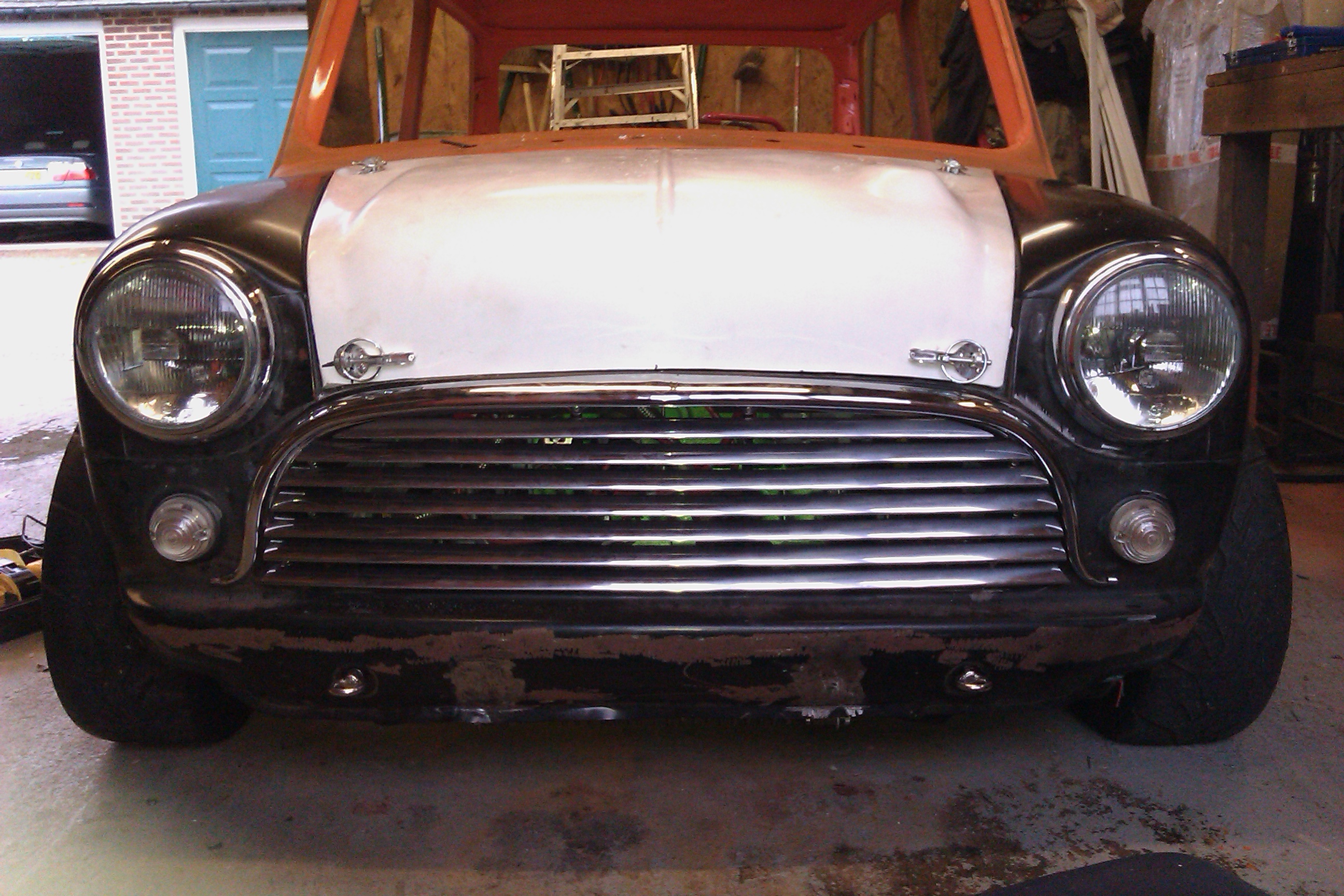

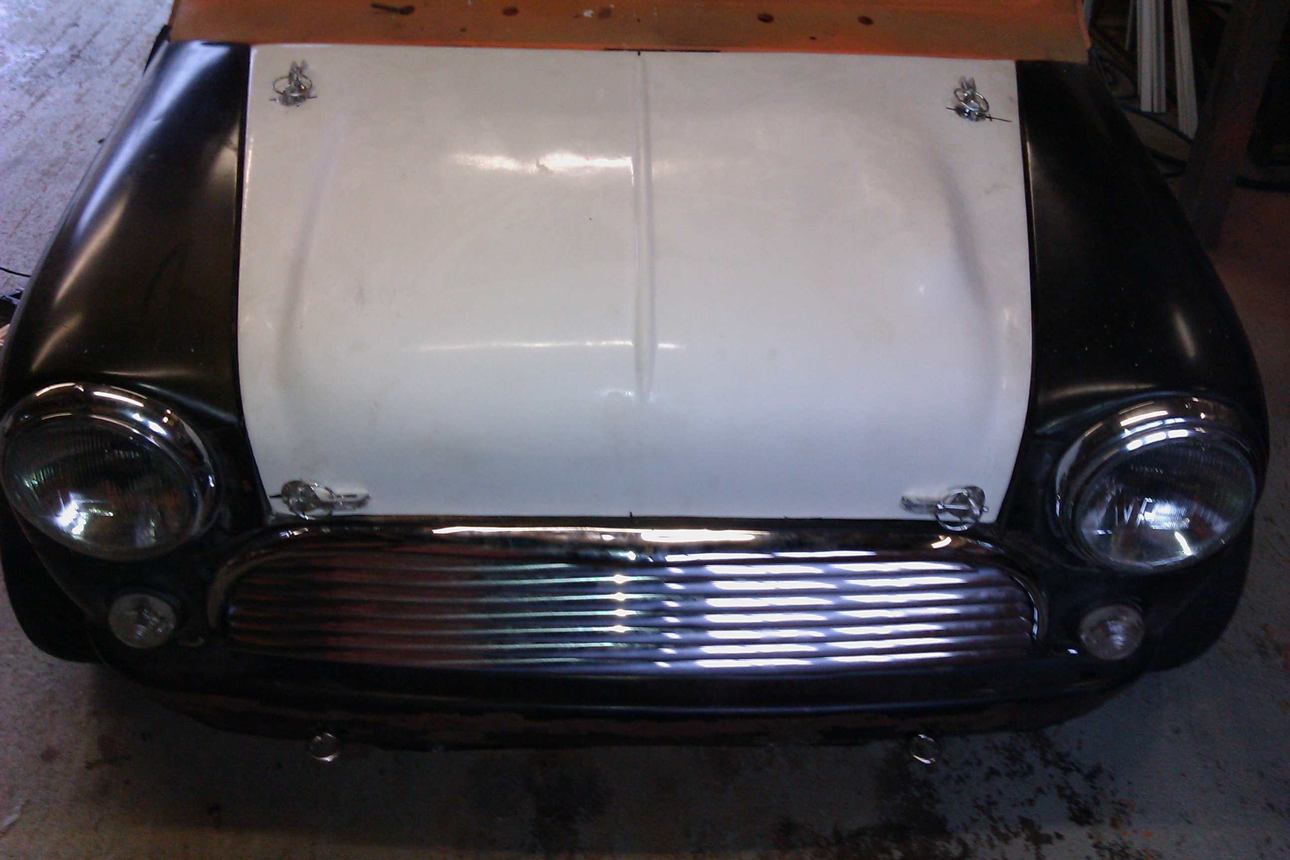

Havnt had a chance to do much due to work but have managed to get front end almost there.
Bonnet fitted just some fine tuning to do, grill fitted, towing eyes in, zeus fastner fixings all sorted and working well.

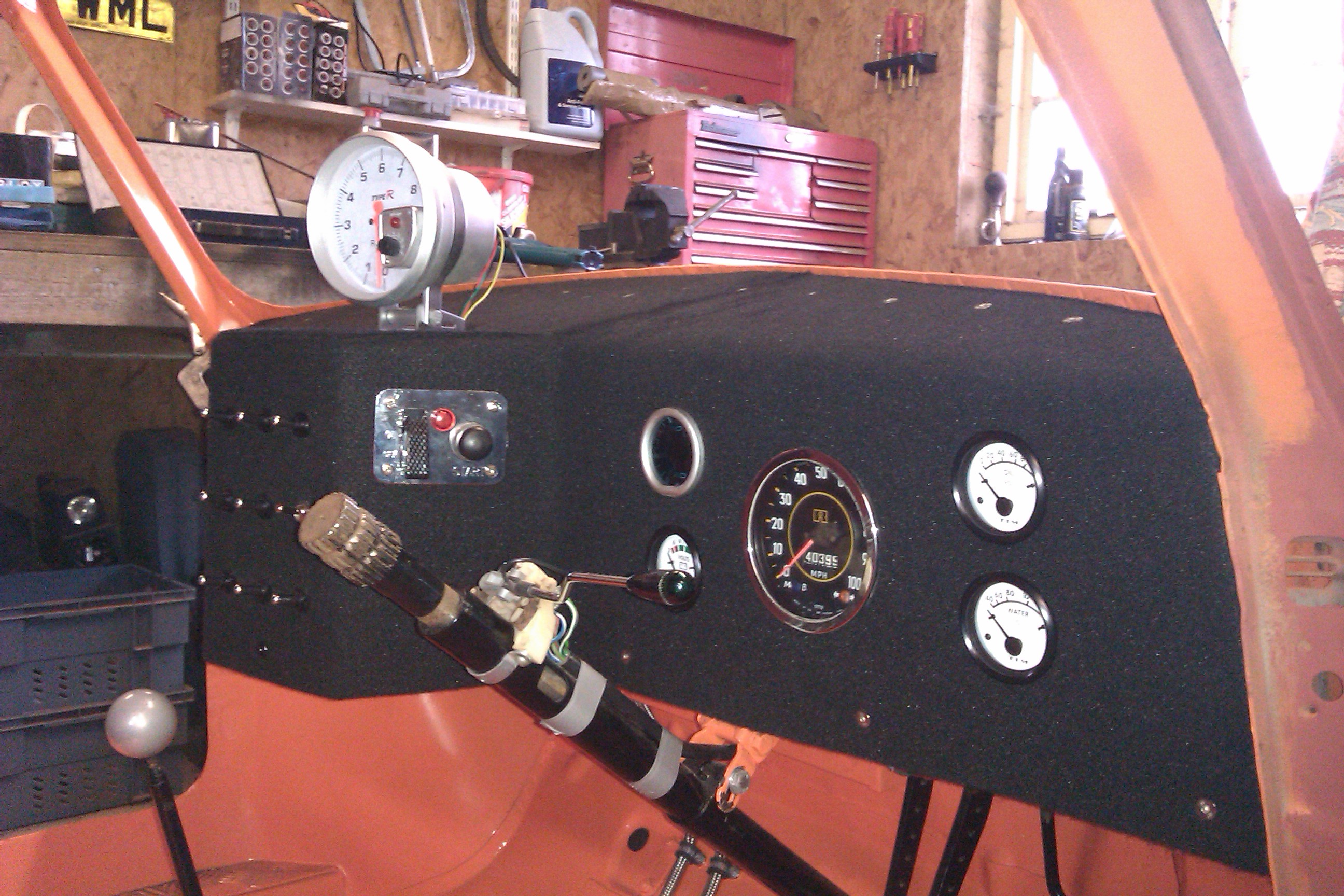

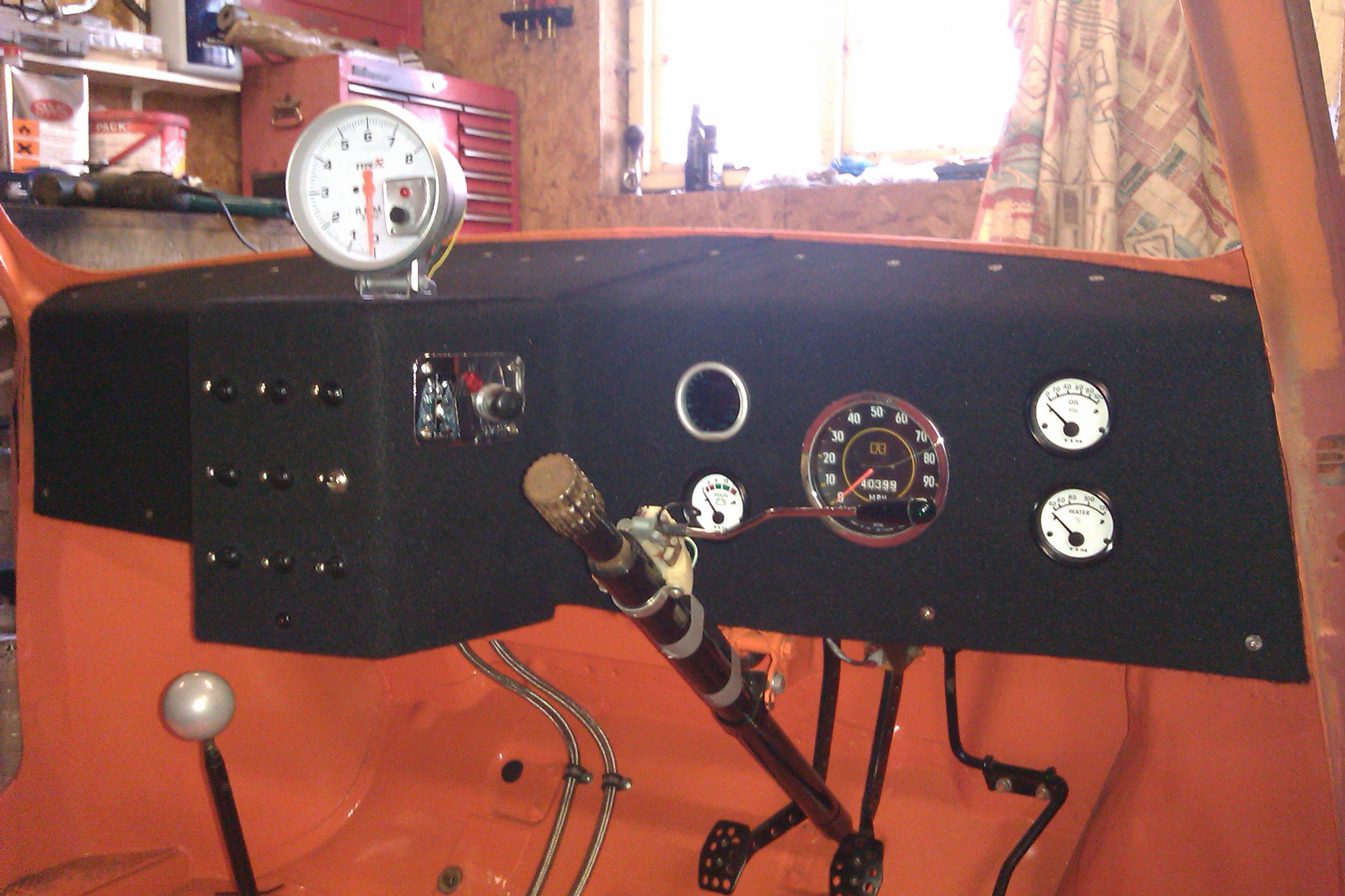

Dash and dials in and all working showing a good oil presure and water temp, not sure on boost guage though will it only show readings under load?.

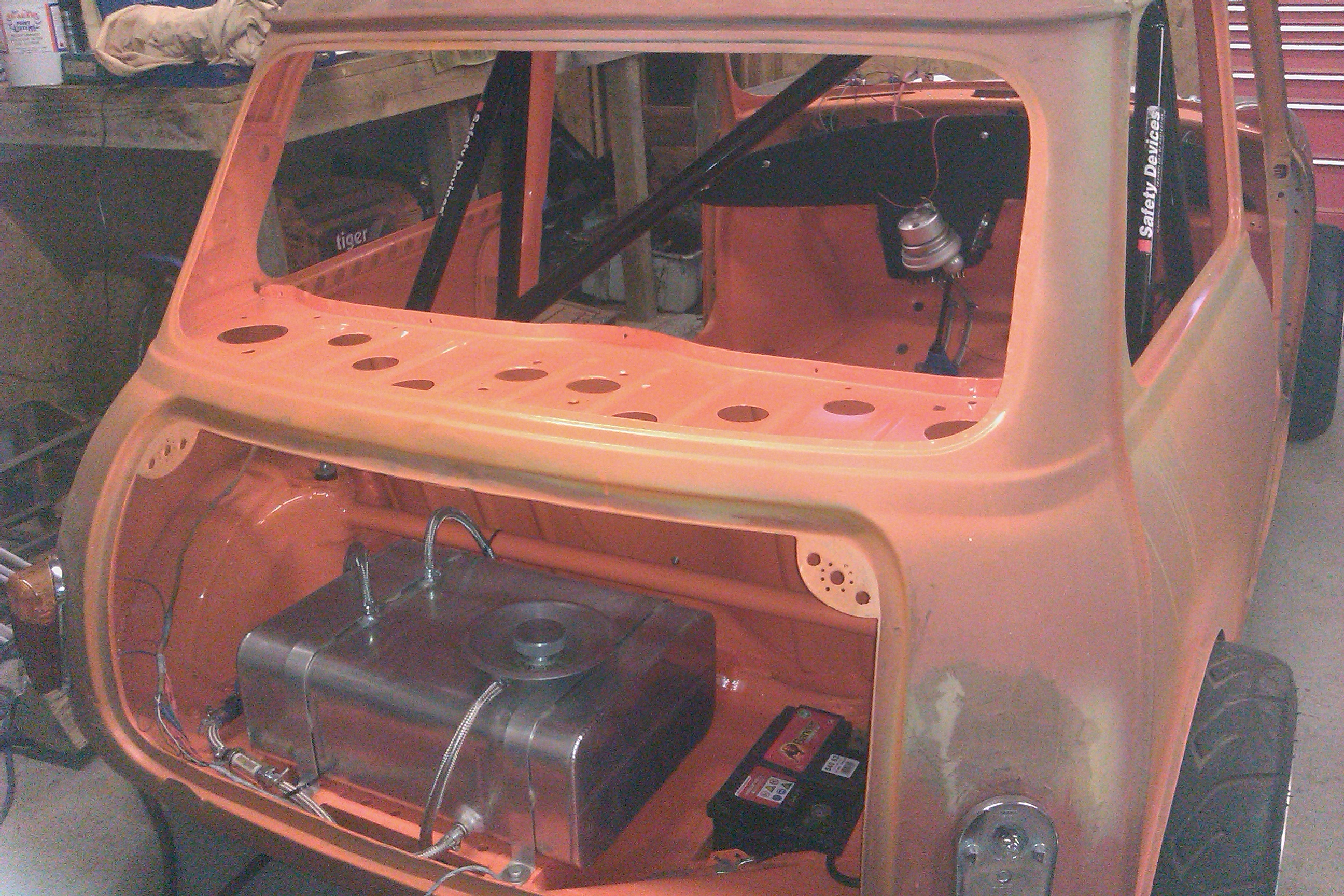

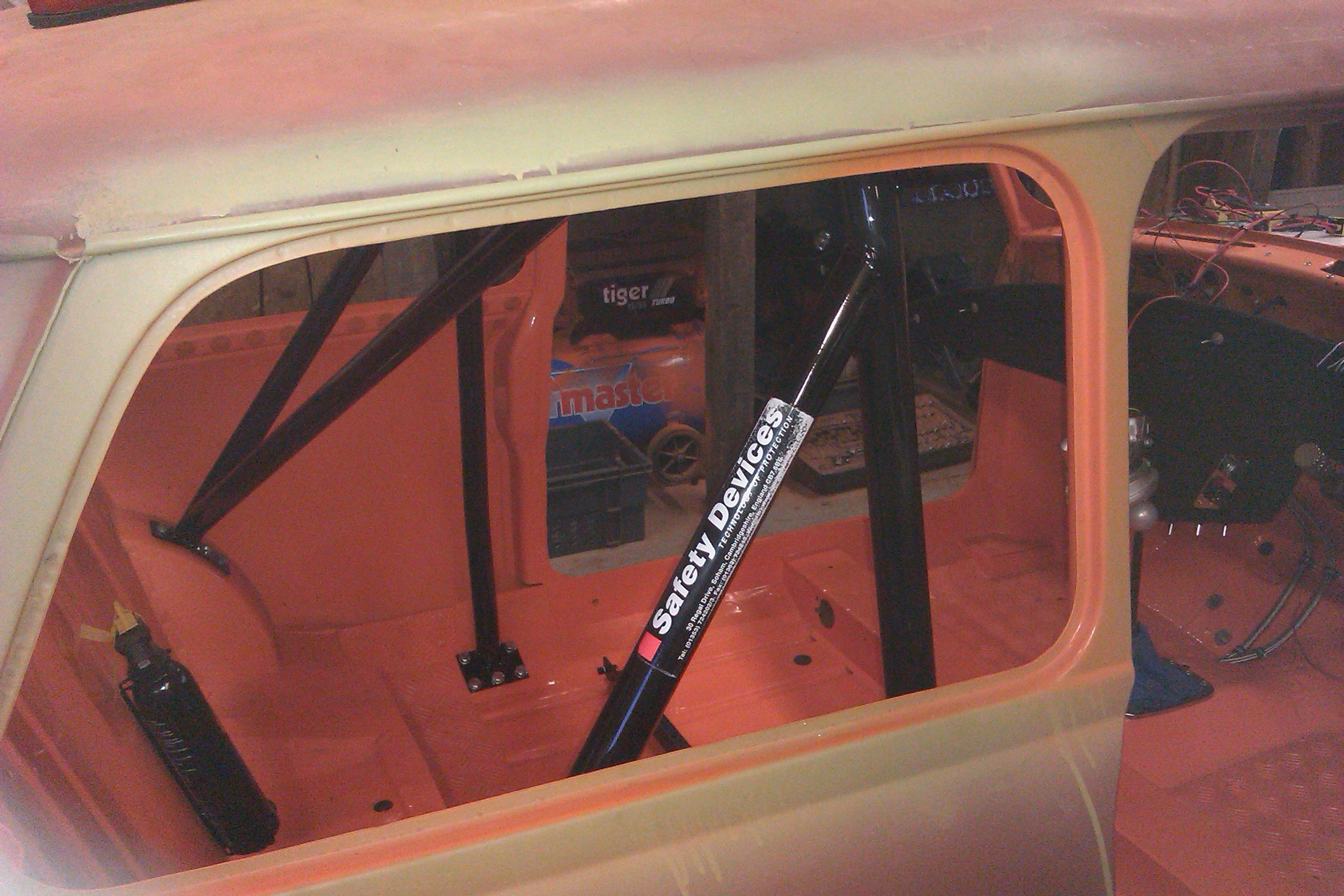

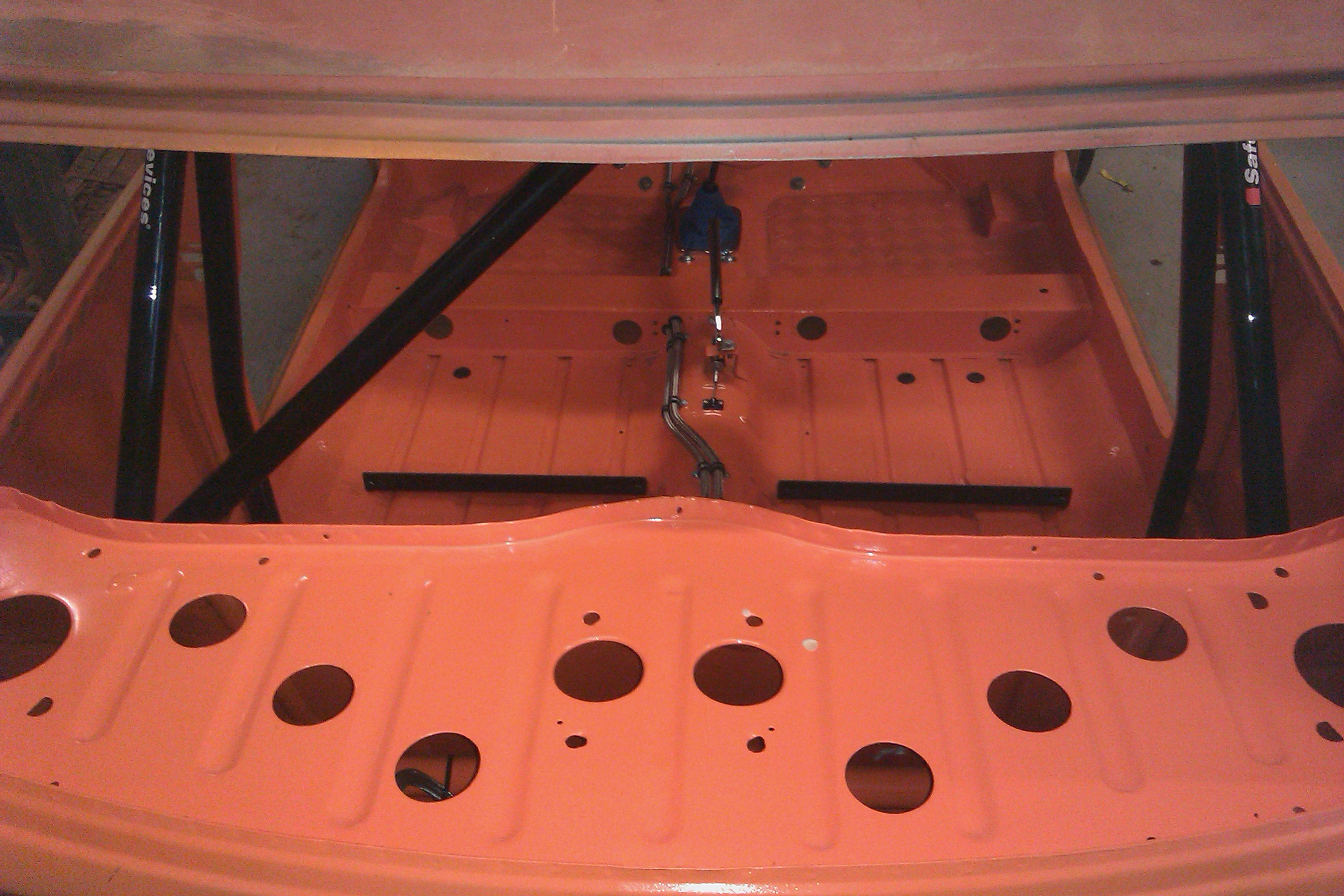

Managed to source a nearly new safty devices rear cage with diag for only £50 so have fitted and removed and at present it is being re-sprayed.
A few pics ill get more up when i get the cage in this week.

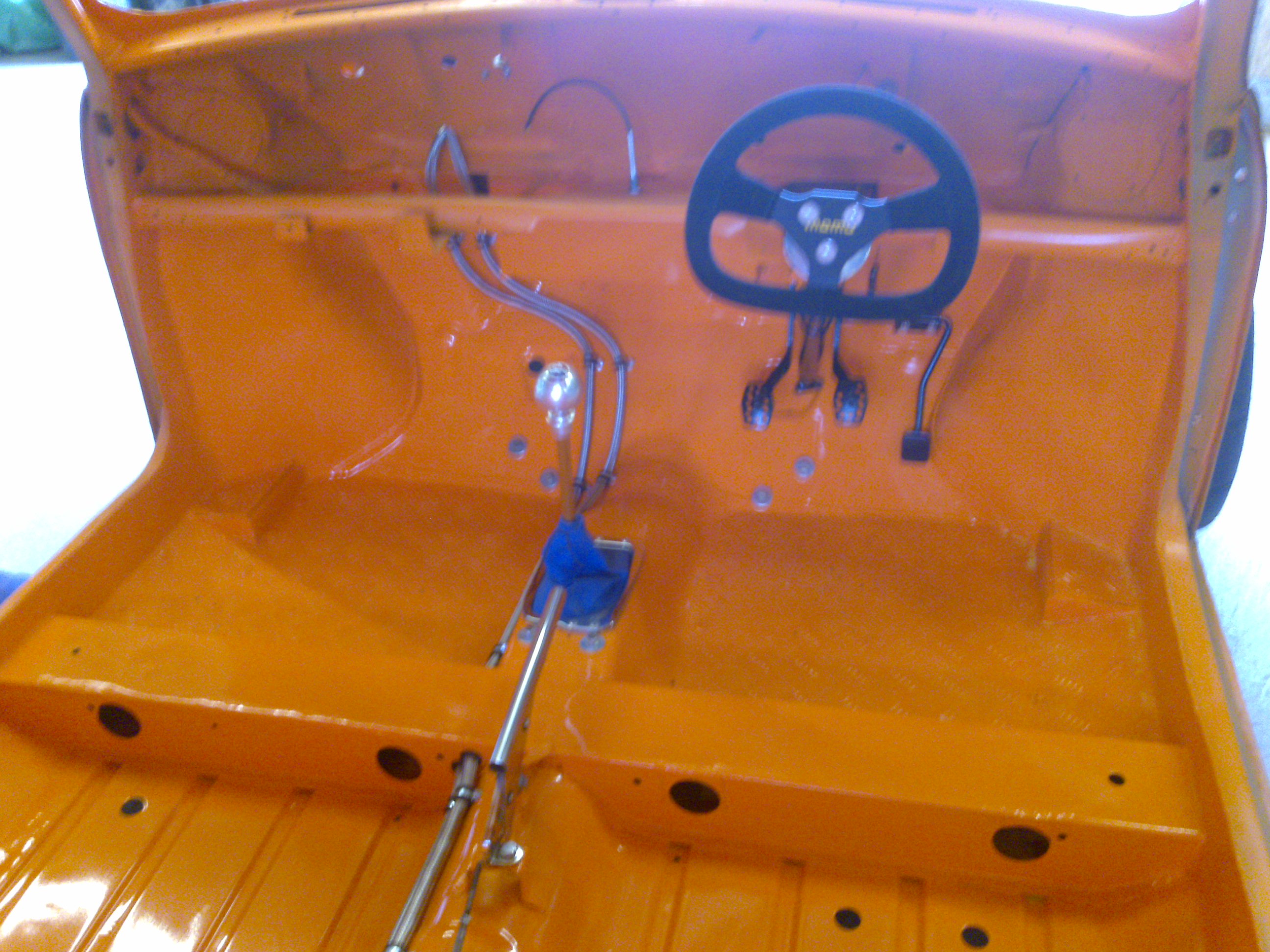

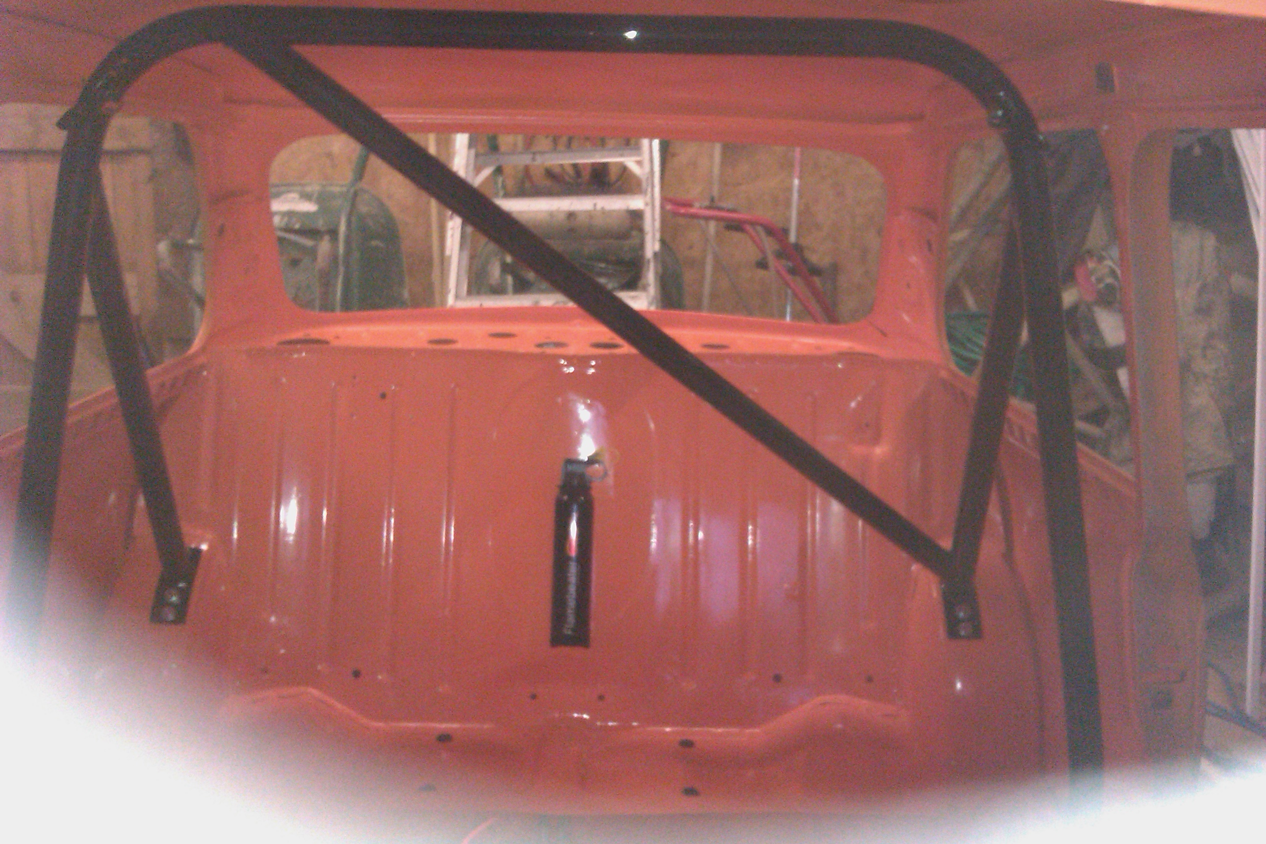

cage painted and in.

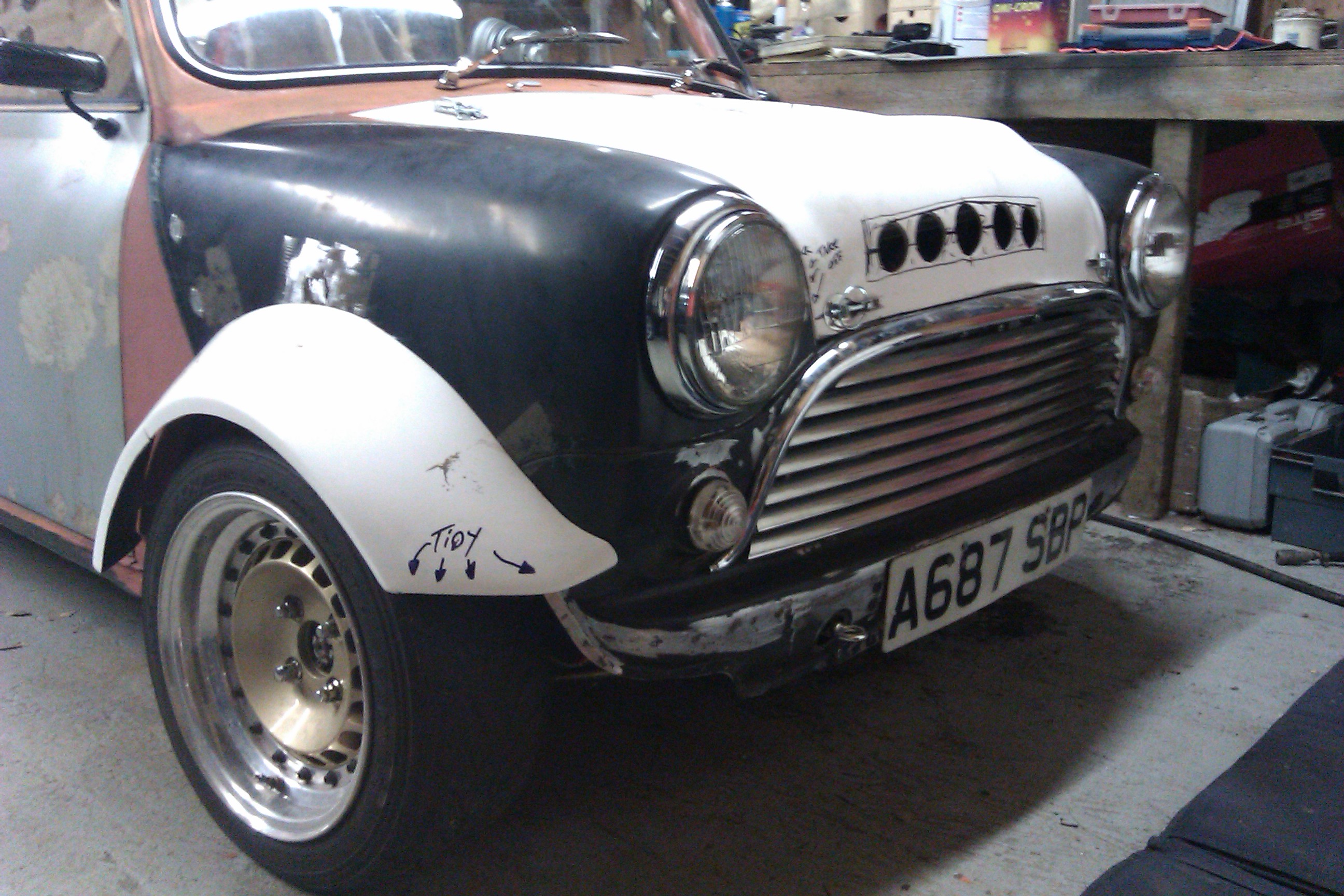

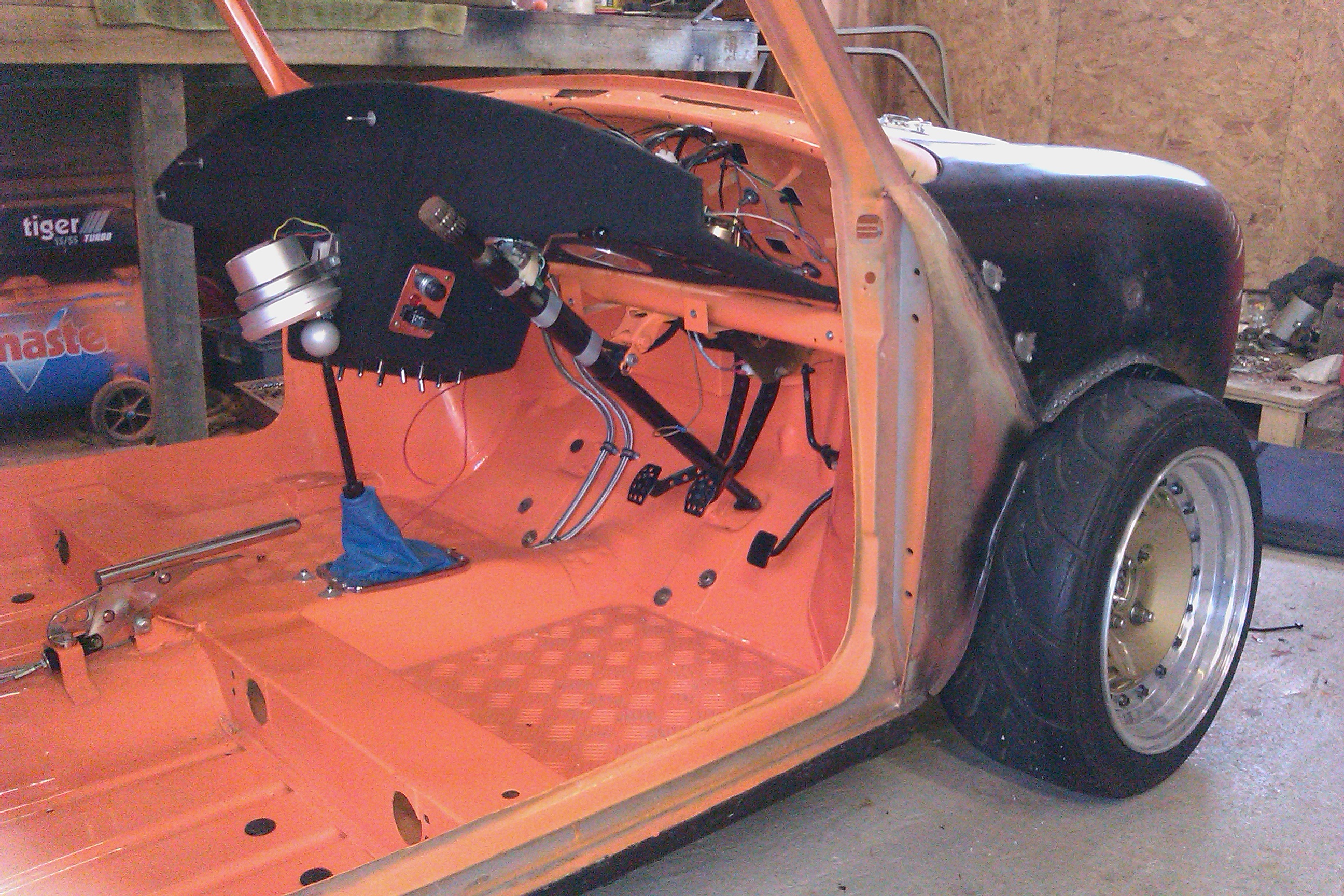

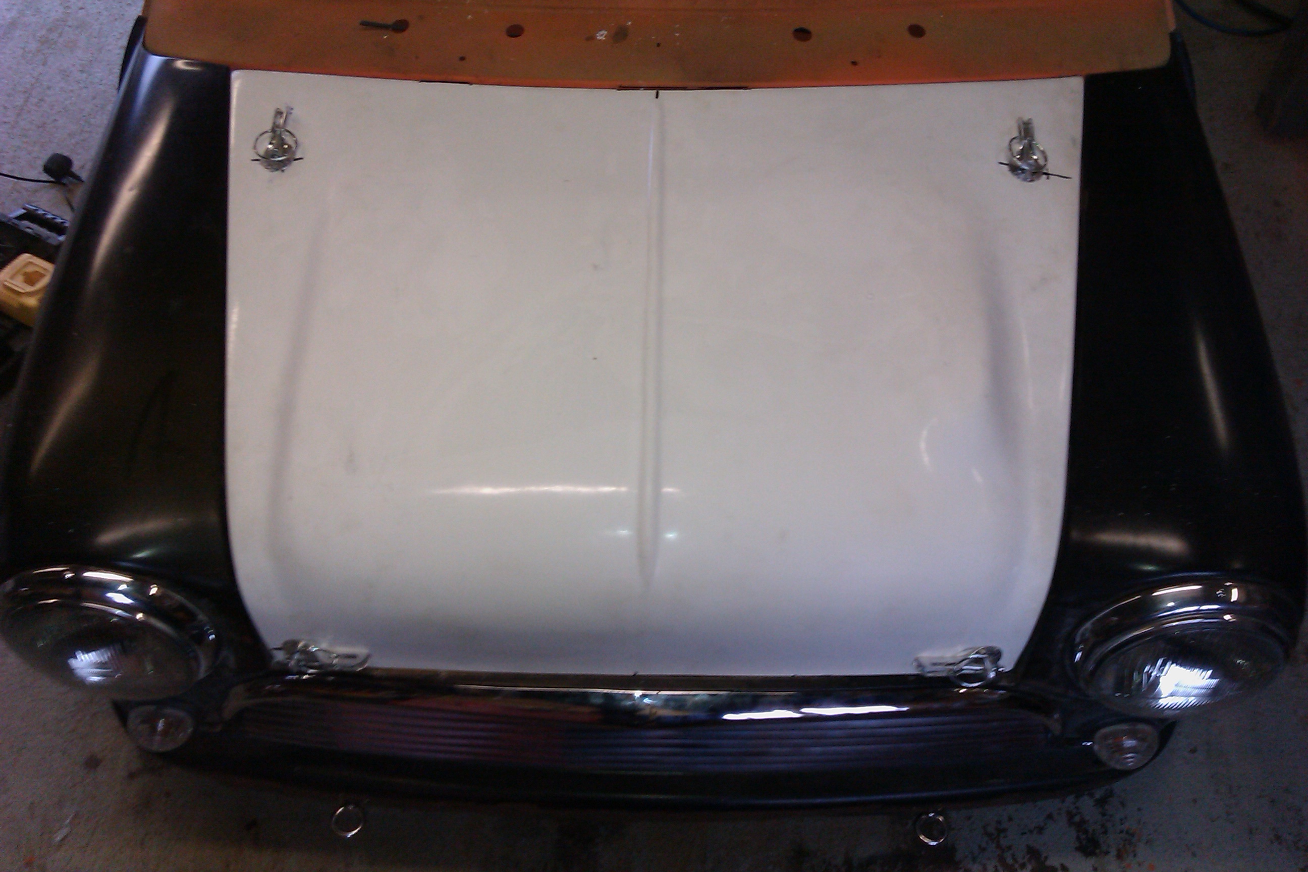

Small update.

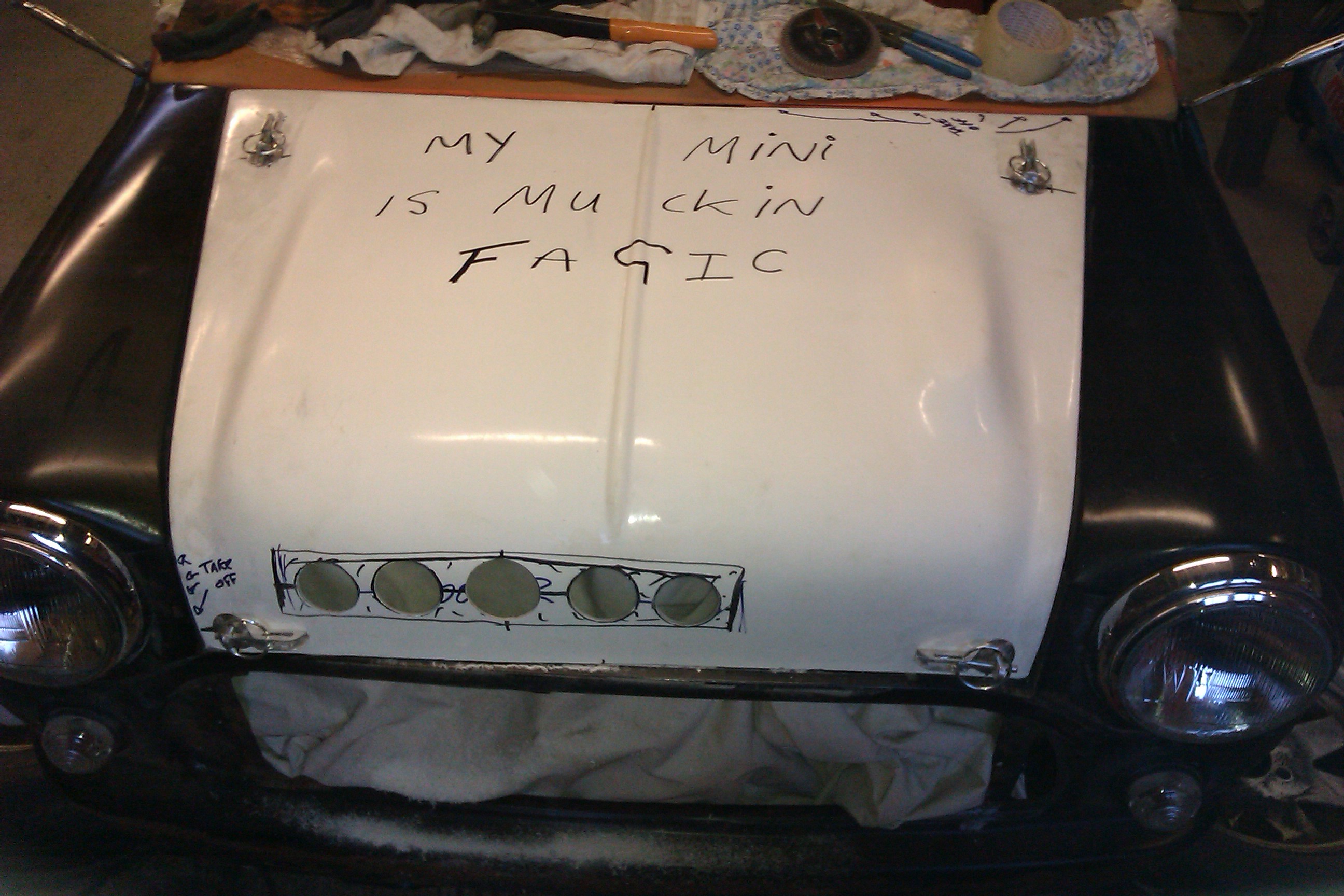

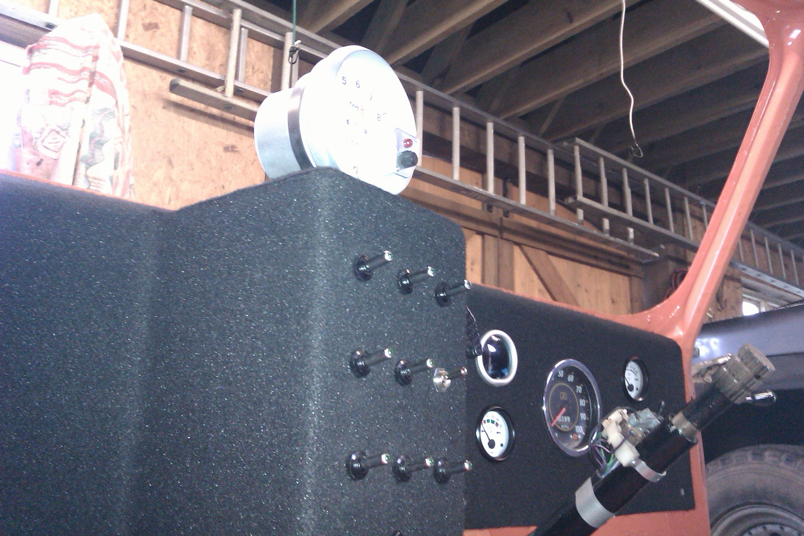

Got a little more done dash in and all wiring finished also put some vent holes in the bonnet for the intercooler.

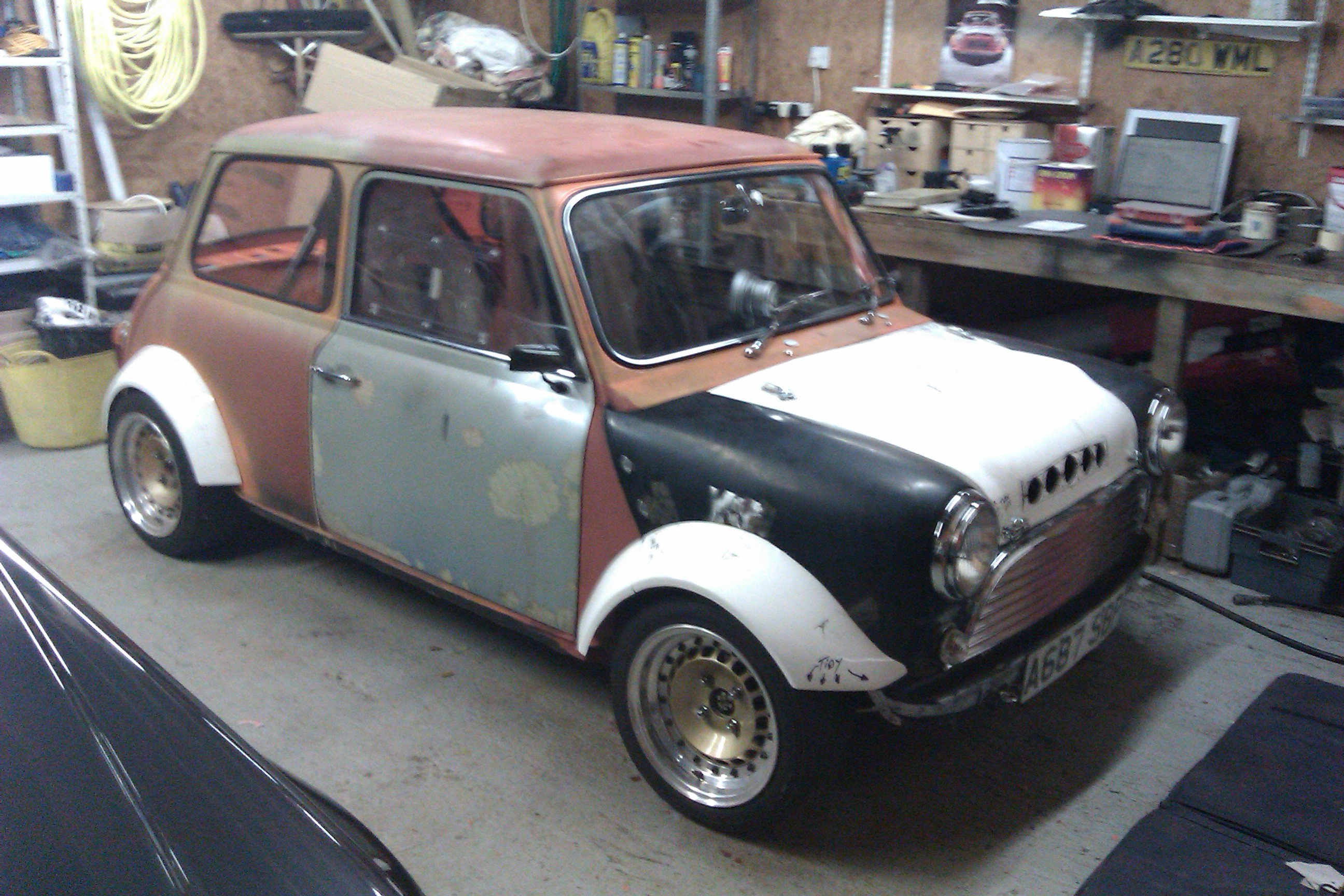

I seem to have missed this one somehow.It looks great especially the wheels,as a wheel nerd I would go out on a limb and say they are schmidt th lines not compomotive turbos but they look great whichever way and really suit the car.
Cheers Ross.
Th lines have a smoother rim than thoes do
Oli
1733 Posts
Member #: 1910
Wilts
yeah i wouldnt say theyre th's either.
You into euro look paul?
rosco454
611 Posts
Member #: 5222
Northumberland
Your both quite right,I had meant to write centre sections.The th have a large smooth are on the dish where the valve mounts.
Cheers Ross.
turbo22
492 Posts
Member #: 3684
wisborough green west sussex
Just ahd a look at the TH lines and they indeed do look similar so maybe they are a mix of both?. Not bad for a fleebay find though! just need to get them re-furbed now.

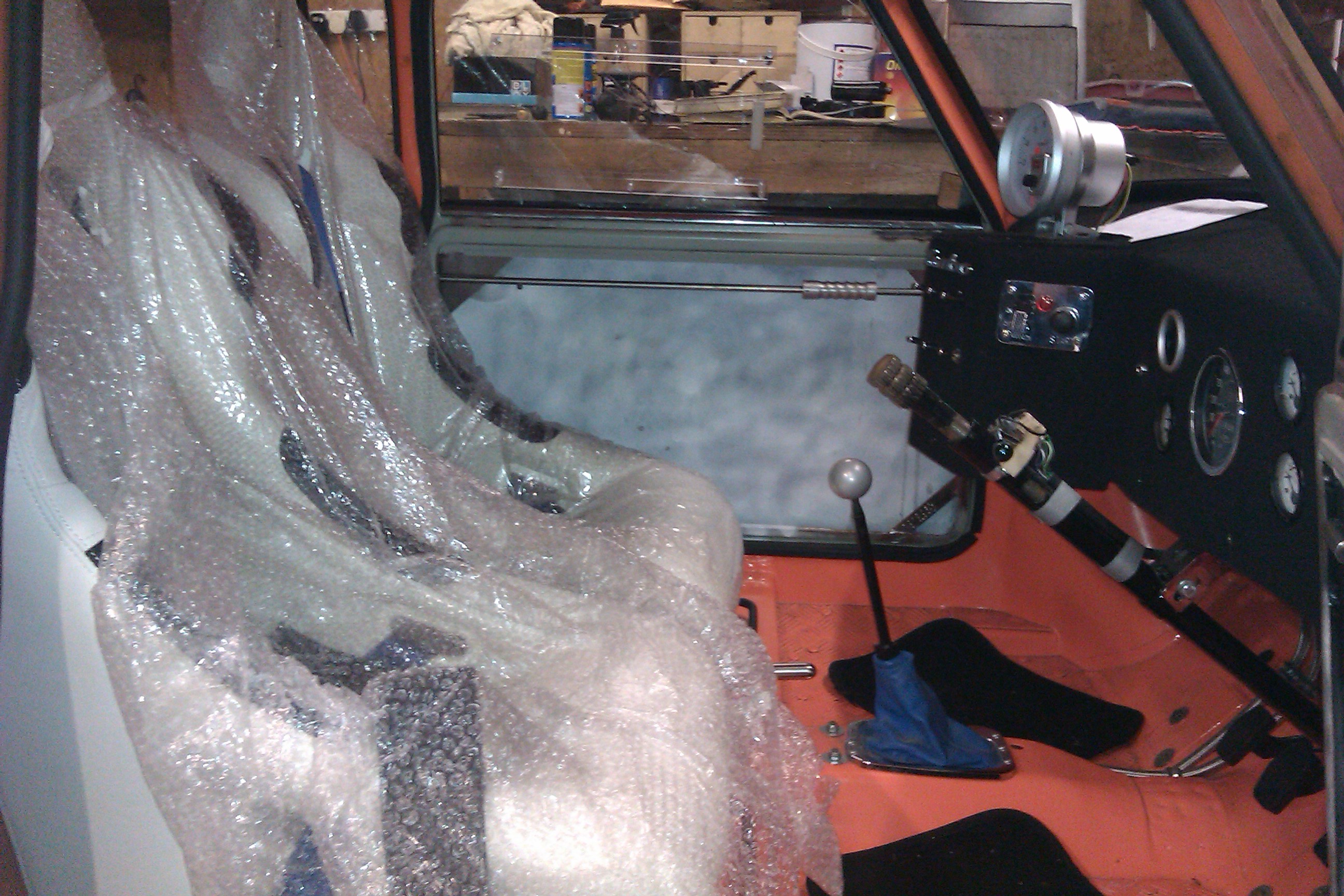

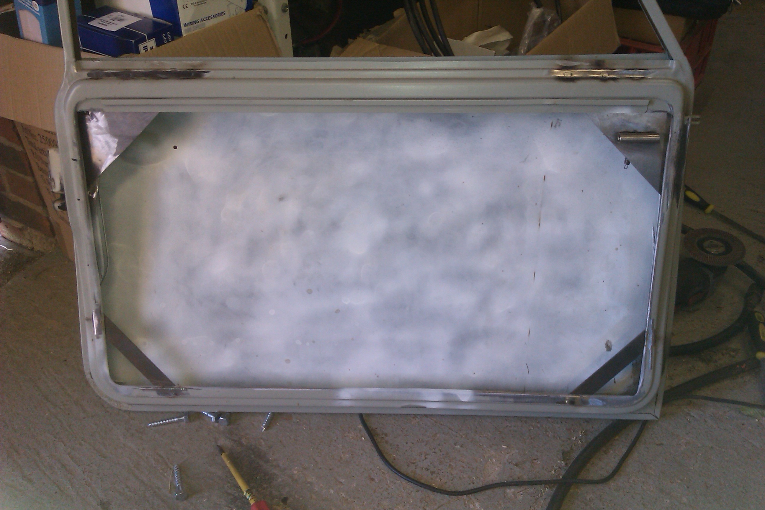

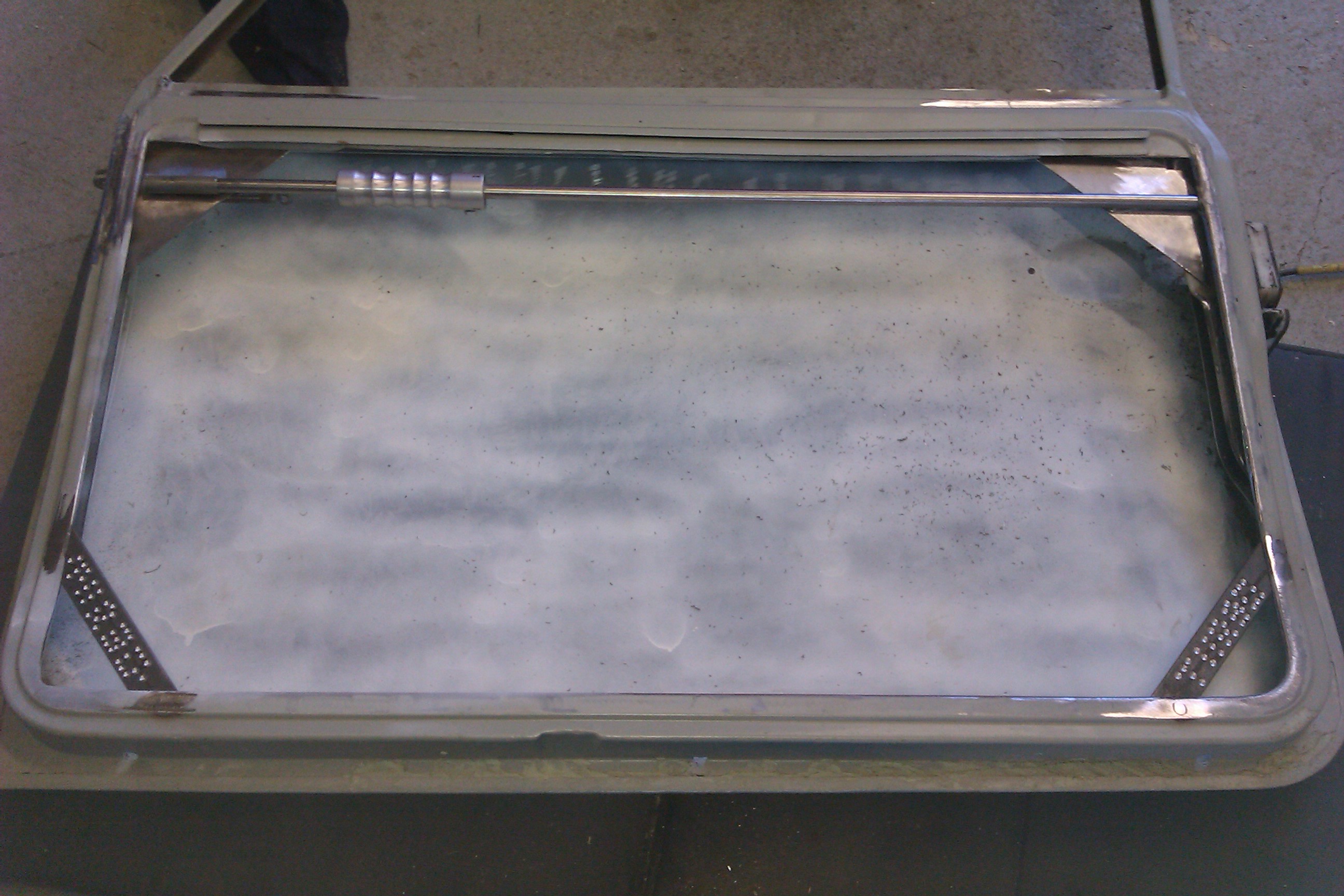

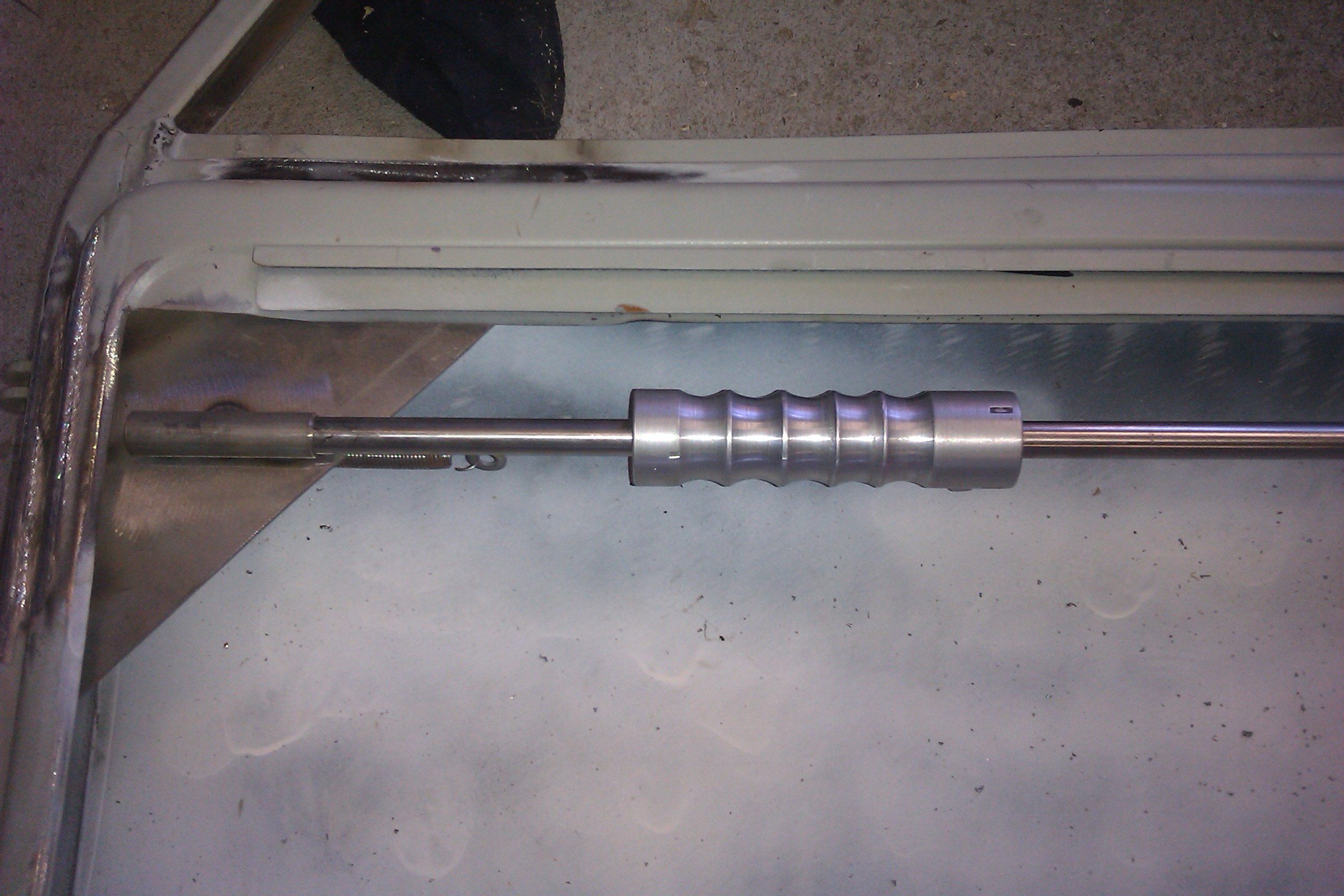

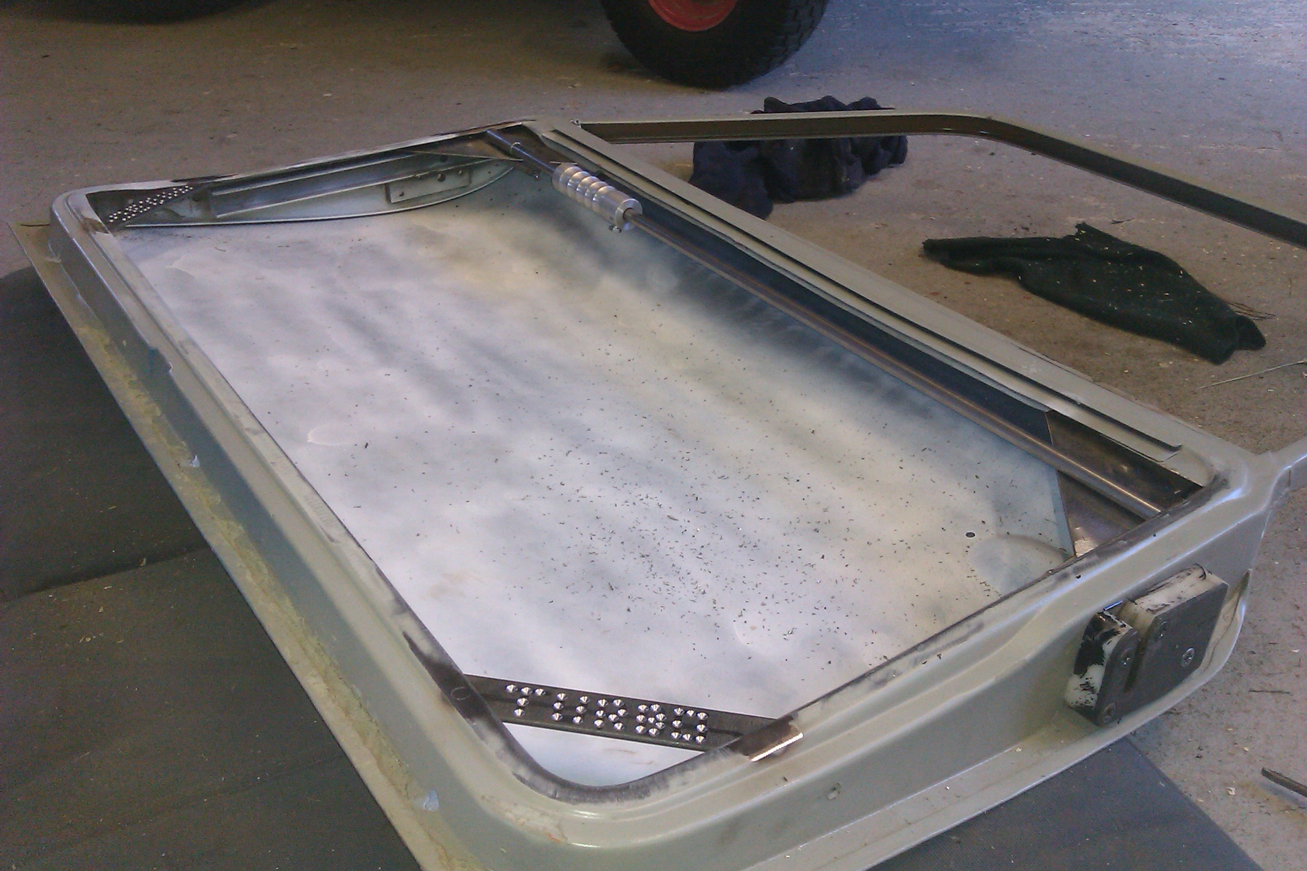

Small update, chopped the doors about to loose some weight, then machined up so bits and came up with this design, all in one opener and handle. Hand grip is fixxed with a grub screw so it can be moved up and down the rod as to suit to person.

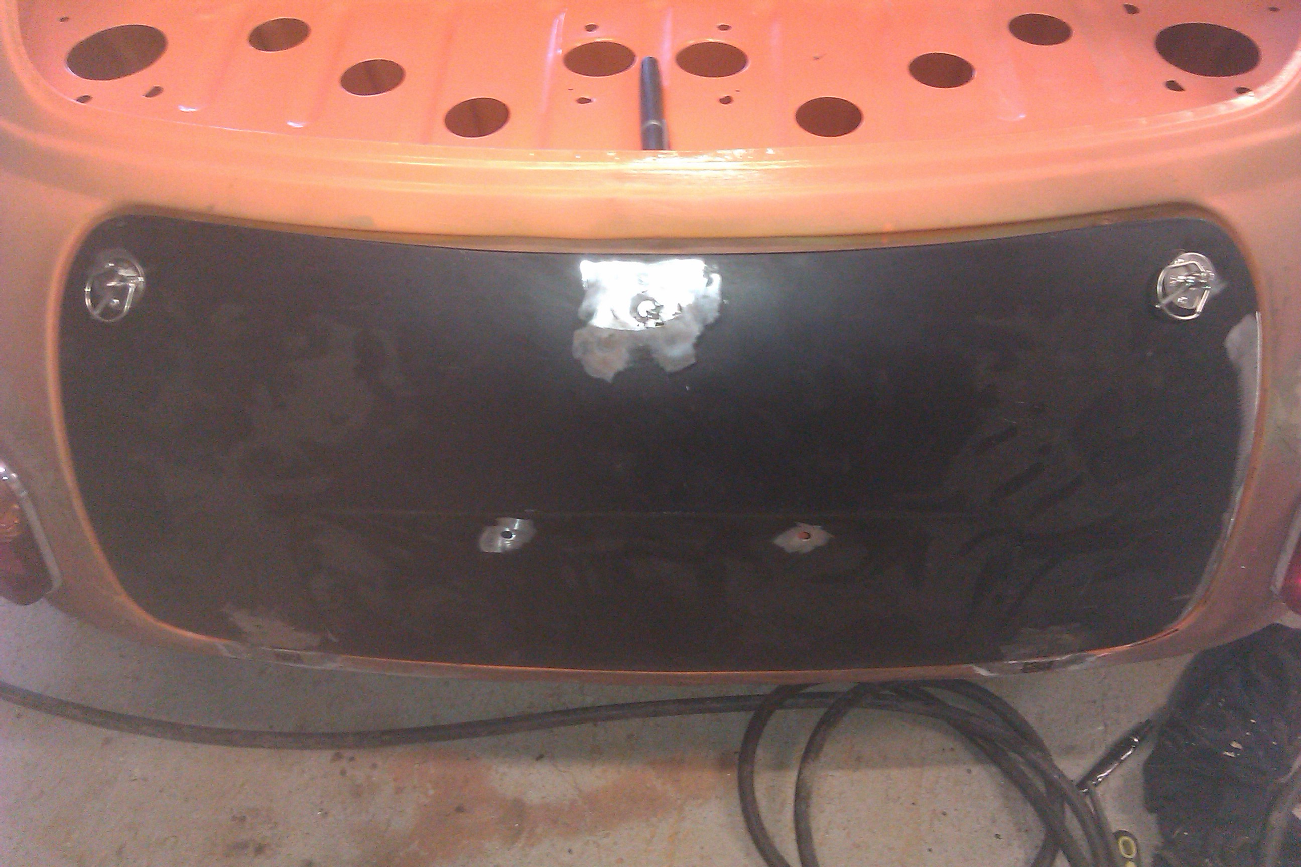

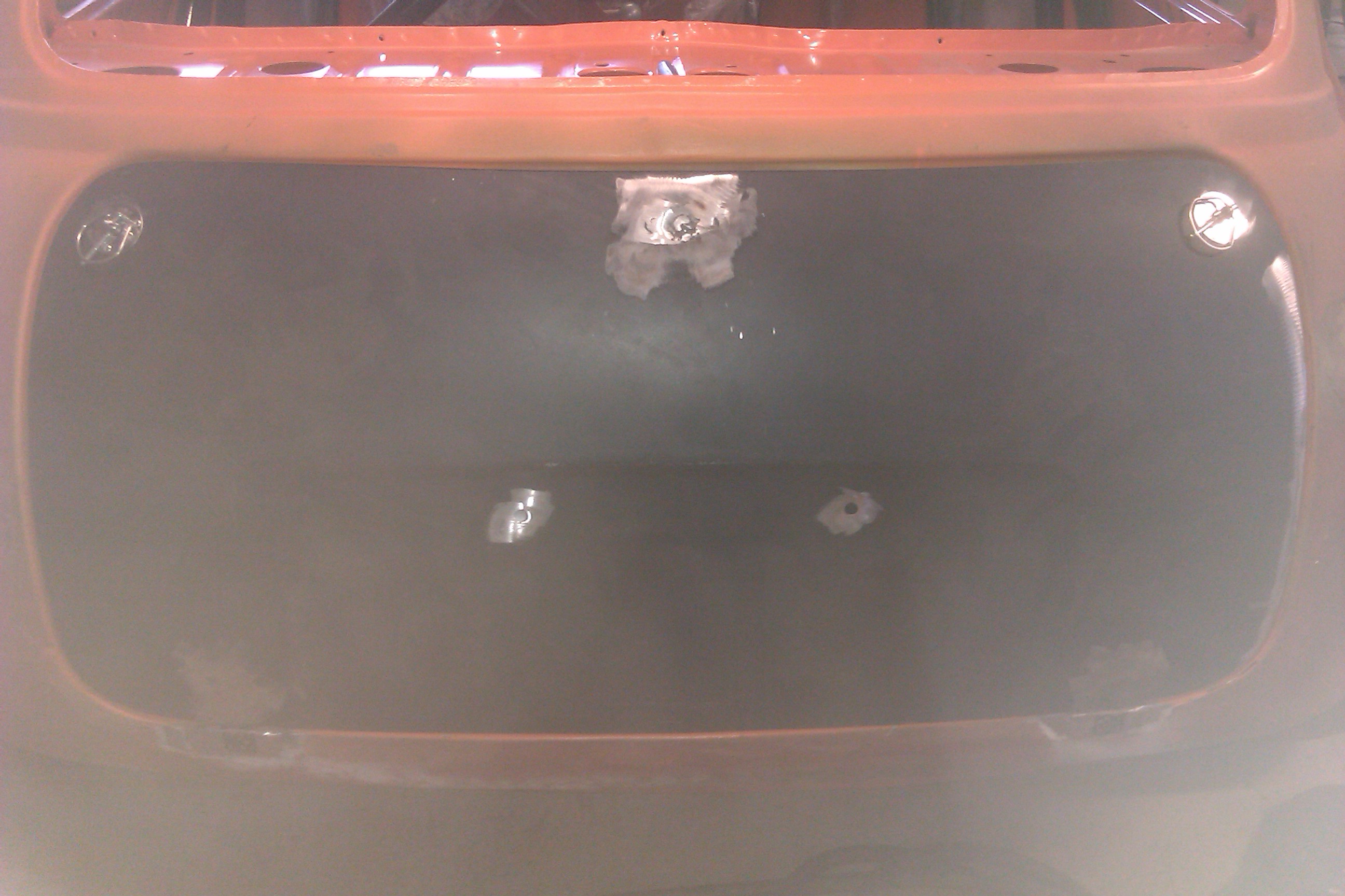

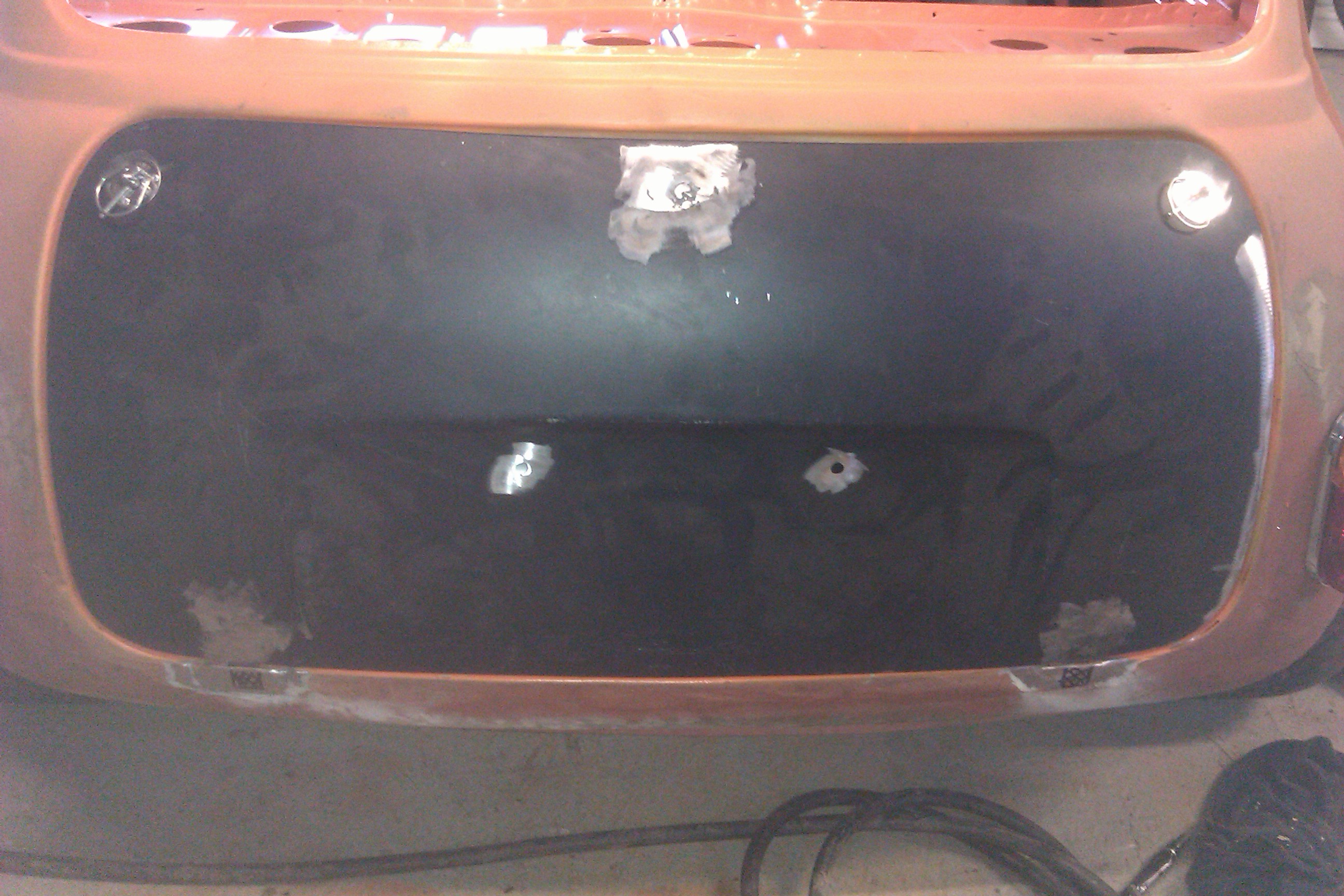

bootlid also finished, welded in some plate strips to drop into small slits cut out of boot surround then fasten with pins in corners.
I like the door opener. Still plenty of space for swaged holes in the sides of the door frames though.
turbo22
492 Posts
Member #: 3684
might look into that now, didnt realize this was dooable.
It's mainly flat steel, so swaged holes will make it stronger *smiley*. I plan to do that to my doors
turbo22
492 Posts
Member #: 3684
nice one just looked at some on here, looks the part. A job for next week i think.
