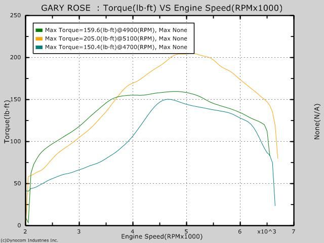

Interesting, and you are correct Robert. GT17 and Ph2.
Go on put yours on. It'd be good to see the difference.
What boost what Nick running there? I think the most I used on the day was 16psi the first two runs were on 9-10psi. I whimped out because I'd blown the head gasket 2 days before when setting it up at uncle rays.
yup looks like nick was running about 1 psi less than you gary so that figures ,with your line being a little higher than his .
with equivalent boost , id expect his to be a bit higher than yours on that rpm with the bigger turbo .

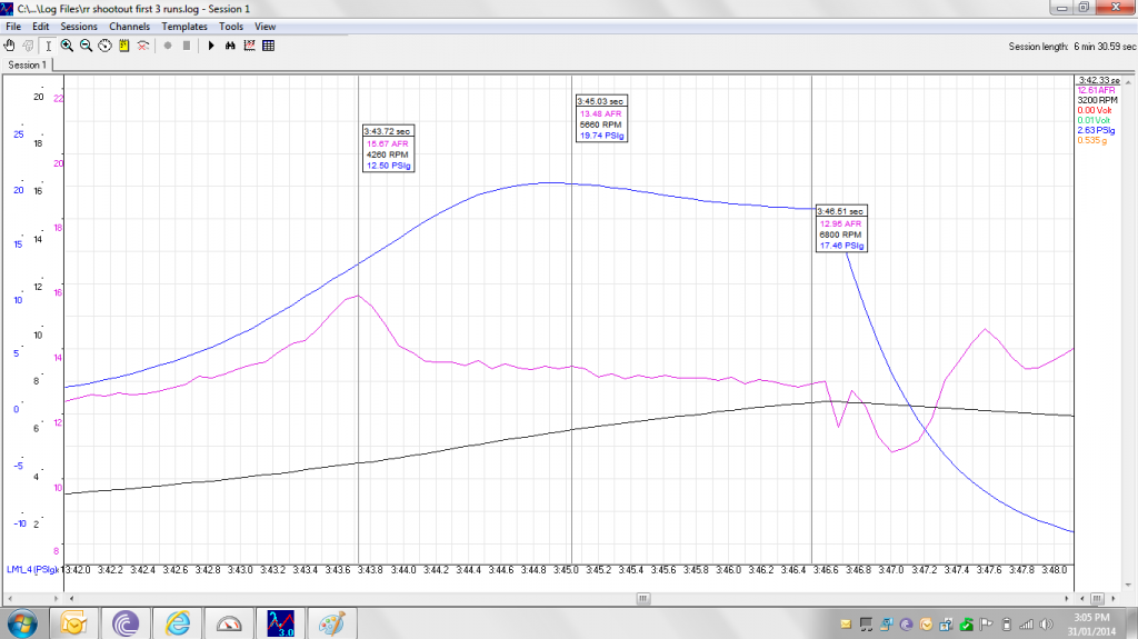

my run overlaid...
but ,as you can see , im running up to 19 psi in the middle then down to 17 ish at the end , so not a direct comparison .

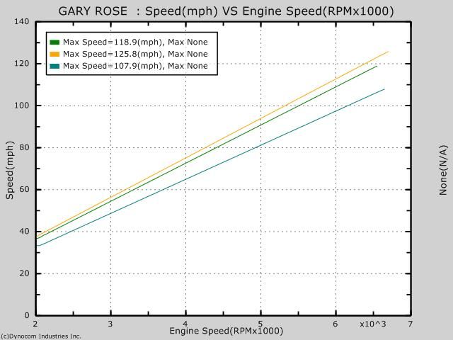

these are the rd speeds measured on the runs , im using a 3.1 diff , I think gary is in a 3.2 ,so that means nick must be on a 3.44 or small wheels ?
anyrdup , these trq graphs are with no losses added , so rd speed will affect the comparison a bit , the higher the speed the greater the losses , roughly 100 mph is 15 bhp losses ,and 125mph is 25 bhp losses .
Edited by robert on 31st Jan, 2014.
1340cc. It was freshly built and only just run in at Smart.
Probably wasn't in the best tune here though as I'd backed off the timing to help ensure I had a ride home. Tamworth is quite a journey for us Essex boys.

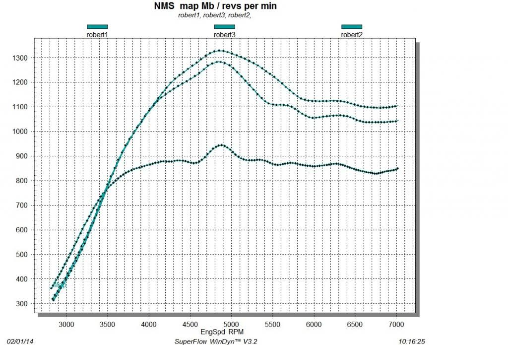

hi paul , just to confuse things more ..
boost rise at nms ..
the dynocom run took 7 seconds . .the nms run took 15 seconds .this meant there was time for the turbo to respond and build boost ,a longer run ,say 25 seconds would have made more boost low down and achieved terminal velocity sooner .
oh EDIT to add , the difference in boost rise between the different boost levels was due to me having the choke out on the 2nd and 3rd runs . this uber richness cooled the exhaust and made less turbine rpm.
