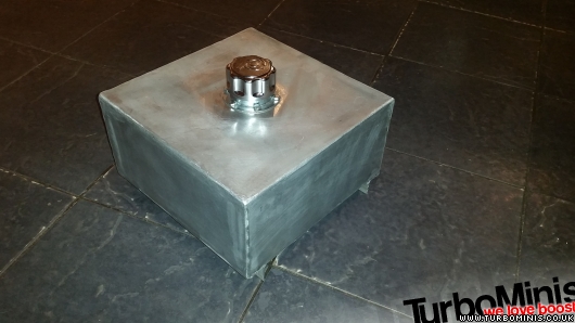

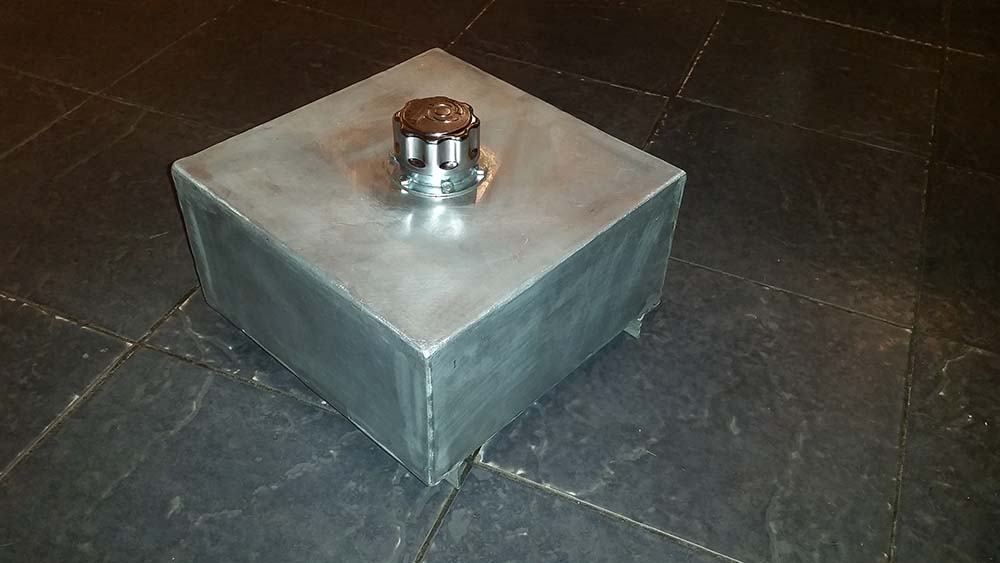

Forgot to add picked my fuel tank up today its 11l with no inputs or outputs except filler nozzel
I was going to make my own but this saves 90% of the hassle and fits beautifully
Edited by Brett on 8th Sep, 2014.

here we are 11l apparently
will be getting a few mods and either a half internal swerl pot / anti surge tank or an external separate one
1 run per tank then?
