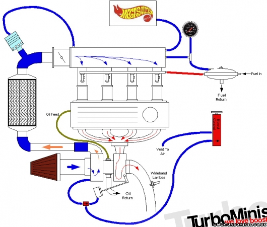

I have recently been helping a chum build a Imp Turbo engine and he asked me if I could sketch out the basics of the turbo plumbing, so I did and I liked them so much I though I would share them.
I am happy to make changes if there are improvements to be made, but no crappy comments on the fact that it has 4 exhaust ports, or the oil feed is from the wrong side. They are generic pictures intended for guidance.
There are 3 different versions.
Plumbing with a Carburettor
Plumbing with Multiple TBs
And Plumbing with Single TB

Good diagrams.
However, the fuel regulator works differently on the injection setups.
Fuel goes in one end of the fuel rail and then the regulator sits the other end, controlling pressure by returning what is not used.

That was one area I was debating if I should have the regulator or not. There are various different ways of doing it, and I doubt that a rising rate regulator is used often. The fact that I have shown the fuel rail as a dead end should give you a clue of how it is working there. Your description is perhaps more conventional though.

Informative.You show,on the last diagram,the dump valve between the I/C and the plenum,which is the way I have done it, purely as a matter of convenience -space considerations. In a recent thread Rod S suggested I should put it before the intercooler and,whilst I respect his opinion and greater experience, I dont see what difference its likely to make.
Any comment, please?.

Dump valve will last longer on the "cold side" of the I/C and possibly reduce lag a little on gear shifts. Oem always seem to fit them hot side?

As Gavin says, OEM seem to fit them "hot side" (it certainly is on my daily and is still the original at 120k miles so the materials must generally be OK for the temperatures), but remember, I made my suggestion when you were changing to a recirculating valve - Ben's diagrams are for atmospheric valves.
I suspect the fact that OEMs use the hot side for a recirculating valve is mainly down to simpler (ie, shorter) plumbing.
In turn, that "might" mean they can get away with a slightly smaller valve.... the recirculation path is certainly much shorter that way.

Obliged again for the explanation. As I said, I used the cold side merely because it was convenient and happily it is also the shortest recirculating path. Looks like I might have got one thing right this time ! Onward and upward.
Nice drawings.
I'm not a fan of all the Tee Pieces for the boost gauge, regulator and ECU, personally I'd use individual pipe for each of them but that's me.

I do agree with you there, but for convenience I have done it like that on the drawing. It just depends on how many holes you want to make.

one thing for the individual throttle bodies one, shouldn't the vacuum line be linked over all 4 bodies?
sort of 4 into one jobbie to give a decen vacuum reading rather than just the weak one from one cylinder?

I tend to agree with Paul about the FPR setup on an EFI engine. *oh well*

Yes and no. On an NA car with a wild cam it is difficult to get MAP signals so it helps to link them. On a turbo car with a mild cam it is not so bad. Again no hard and fast rules her, just a quick reference to new people.

on the throttle bodied diagrams the boost gauge is T'd into the line from plenumn to regulator but on the carb it's taken from the inlet manifold. is it like that for a reason or can i just T it in? thanks

i have couple questions, sorry if they are silly *happy*
looking on first pic.
pipe coming from boost controller and written vent to air, so i need just leave it open?
and pipe which goes from boost gauge to picture (Megaso..) what does it mean? where i need to connect that pipe?
Thank you for help!

The reason the boost is taken from the plenum and not the manifold on the throttle bodies is that the MAP signal from just on throttle body is not very good. You can link all throttle bodies together with small pipes to overcome this if you like.
Chominsh,
Yes, just vent to air the same as a bleed valve. Some other MBCs connect up differently though so read their install instructions.
The megasquirt is the ignition control so it needs a MAP signal which in this case is the same as the boost gauge.
http://www.twin-turbo.co.uk
In your case rather than the megasquirt you will probably be running to the distributor.

so if i don't have that megasquirt, i do not need that pipe? just pipe goes to gauge and connection wire to connection?

there is a vacum advance (boost retard?) can on the side of the distributor, but it is probably connected to the manifold already.

yea it is! so i do not need that pipe? or need to make there t-pice?
