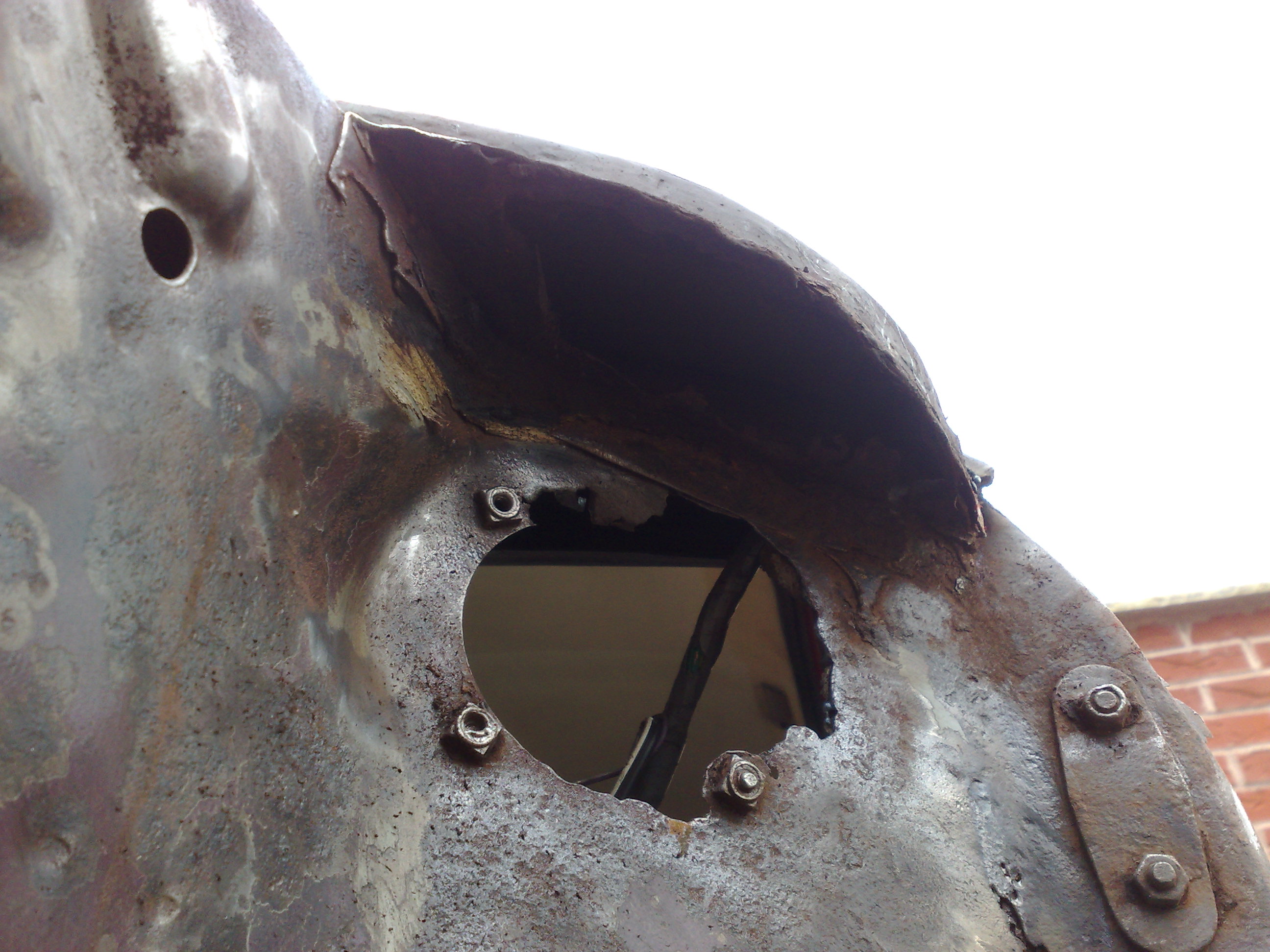

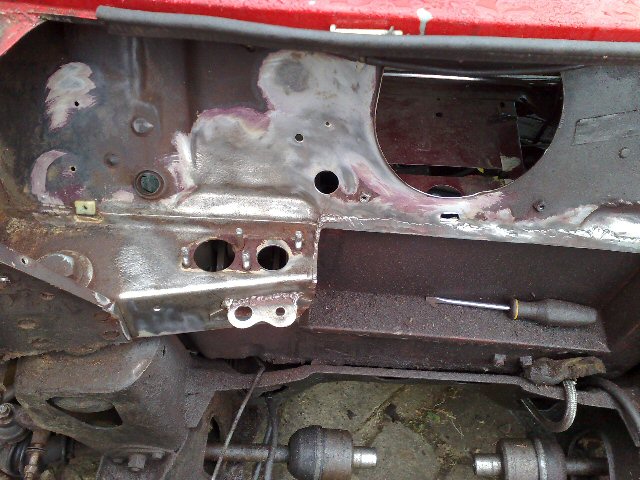

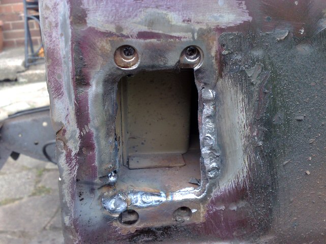

behind the front shock mounts, i ground it out with a little grinding wheel, painted it with hamerite then plated over now its painted you can barely tell

i have not really taken any other decent pics been too cold to do much but so far i have:
*removed the inner bins both sides,
*cut back the rear seat,
*trimmed up around the door mountings seam welded down the 2 panels that join there i will be having removable a panels so i have also strengthened the door mounts,
*fresh air vent gone as they just chucked in water*happy*

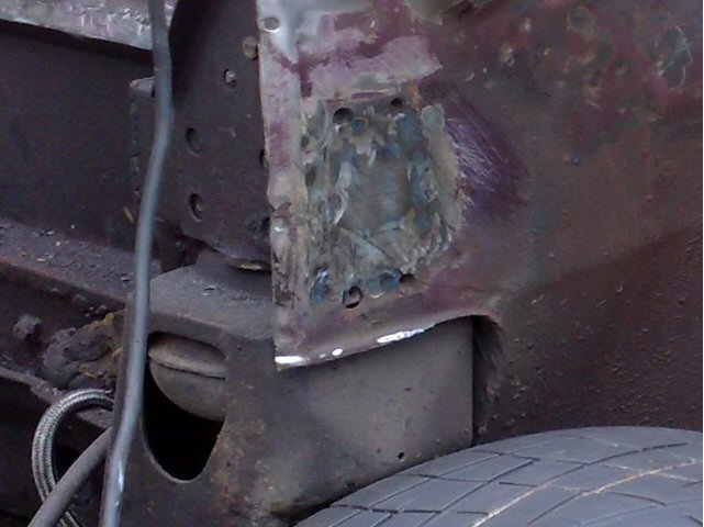

*front shock mounts plated up,

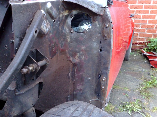

*tidied up the old inner wings or rather where they was attached to,
*ground down the seem welds i did a couple of years ago under the car (floor pans, sills) i am going to try dig out the pics i took when i did the sills, but i replaced with over sills "to stop the water getting in" however now i know why the vents was there and wish i had used genuine sills
*the front, rear subframe mounts was strengthened last time round aswell ready for the beam conversion but im not taking that route now..

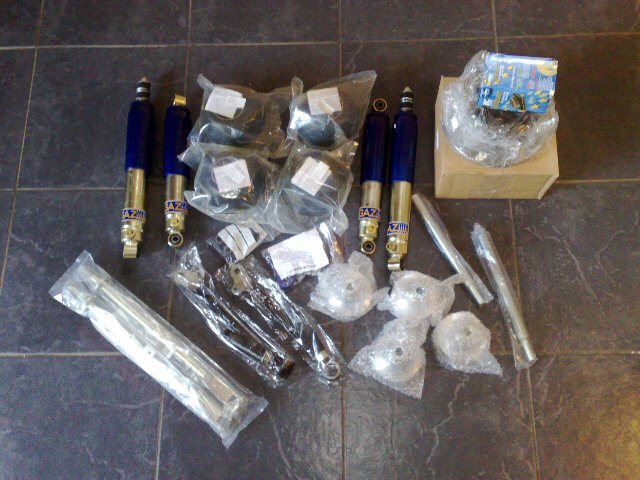

i placed an order friday last week half at mini spares and half at mini sport,
any way the mini spares lot has turned up:)
There is gaz adjustable dampers
hight adjusters (cheap hilo)
mini spares red det cones
fully adjustable tie bars
fully adjustable bottom arms and bushes for both
and a set of 7.5 inch disks and pads for the clubby
cant wait to get them on the car, at the minute i have just dropped the rear subby, to do a little plating around the boot and to tub the arches, the subby itself was new 3 months before it came off the road so it will be cleaned up lightened abit (i feel left out lol) then painted and rebuilt with new every thing, whilst its out the rear bar will be raised right up to the boot floor to make some space up back and to hide it as i have no rear valance

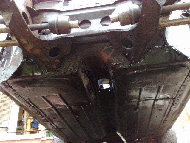

What's going on with the floor pan?
Own the day
Where's the cross member gone?
Looking good Brett.
Are you going to fit the SPi motor that we dragged through you're back field?
that just had to go... lol i could not get my seat in the position i felt comfortable with so it went, another corner cut when i was younger, the plan was to build a "floor cage" around the floor tie-ing into the front/rear and rear/front subframe mounts then to build a cage up from that, but i decided the cage should be removeable,

The reason I ask about the floor pan is it loks tha the entire front end has been cut out and replaced*surprised*
Own the day
On 14th Jan, 2009 Richie said:
you may want to re think how you have mounted the lines, the bit where it rolls over the seat pan edge will cause issues with rubbing, and you will have further problems at the gearstick end too. i would recomend putting h pipes through the heel board (under the seat) but make sure you use rubber grommets. this will also look much tidy'er too. then the same at the bulkhead end. just an opinion, but you are risking it with the current setup IMHO.
Richie
yes you are quite right Richie the fuel lines rubbed groves into the seat pan and also shows signs of rubbing on the fuel lines this time round im liking the solid copper lines approach, the over braided stuff was ptfe lined plastic tubes made it a twat to work with, wont be used again lol
yes both the foot well pans was replaces when i did the sills last time round, mr mot man put the jack under the drivers side and it bent up bad making it undrivable and the passengers side was badly rusted so they both dot changed, its quite common is it not? the seam is usualy hiden by the crosmember
