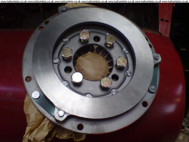

Stevie,
I'm hoping to stick with the verto for my mild 998 turbo.
Where did you find this strong cover?
Could you find it again?
Was it one of these with 0.090" fingers and a ring around the studs:

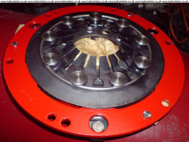

Hey Axel,
This would probably do you for the milder tune 998,
http://cgi.ebay.co.uk/ws/eBayISAPI.dll?Vie...300&ssPageName=
I managed to get mine for 55 quid !
At that price I think its cheaper than a new standard one,
Its supposed to be 30% uprated for the 1275
*happy*

Brocky,
Did you ever manage to take some pictures of it and measure the fingers?
The one pictured is not a Verto for the A Series.

Axel,
http://www.turbominis.co.uk/_photos/random...os/425/2761.jpg
http://www.turbominis.co.uk/_photos/random...os/425/2762.jpg
Finger thickness = 2.38 ave.
Matty, couldn't agree more.

Cover was a fluke. It was a re-con Balco unit for a 1000cc Mini.
I had tried 2 genuine Rover turbo covers, as well as the original one that came with the base engine I used. None would take any boost at all. One was even out of balance !!!
I tried a couple of other used 1000cc covers I had from other engines, one wasnt bad, the other no better than the turbo covers.
Then I hunted through a local motor factors, basically jumping/pushing my weight on the fingers ( via the cup ) of all the covers they had in stock.
I picked the one that took the most effort to operate.
Some would literally operate under my own weight.
The one I ended up with needed me to jump on it to operate it.
As its still in the car, its been a while since I seen it.
But Im pretty sure it had the rivets with the steel ring around them as you picture.

Well, that's the thickest yet at 0.094", but according to some old thread I read some time ago will still only handle around 90 ftlbs.
Looks the same as the Sachs one above but with some red paint.

Sounds like its all down to the luck of the draw as to the torque capability by the sound of things, may be a factor tolerance ting
perhaps these guys test them to see that they do what they say ?
Red paint does it for me*smiley*
Its supposed to be 30% uprated for the 1275 turbo. I notice it has different springs in the plate also ??
I'll report the results if I ever get round to fitting it....
Edited by Brocky on 11th Oct, 2006.
6753 Posts
i think a lot of it comes down to the installed hieght, the same as the pre verto type , the supports on the flywheel may need to be machined to get the spring flat. i definately found this with the dual spring verto i made.
