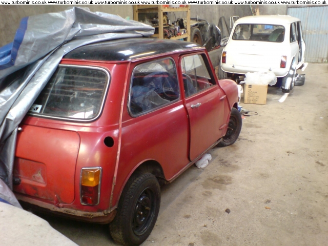

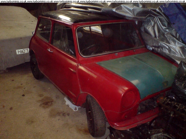

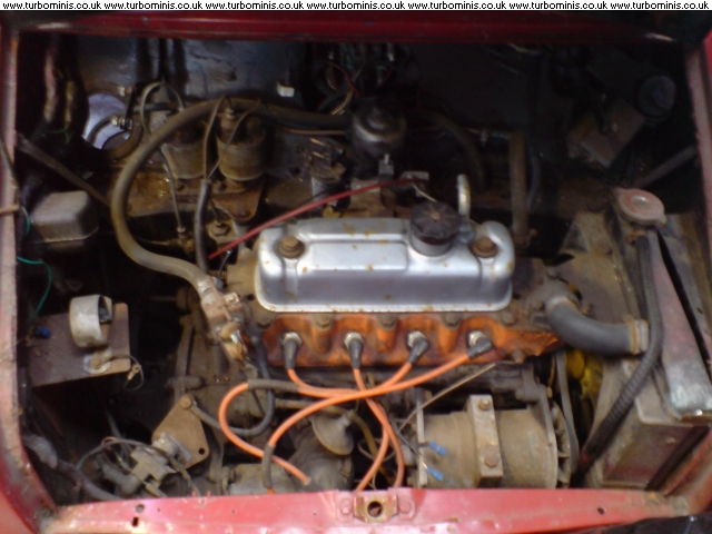

The shell seems to have been converted from an 850 to a 1275 with a 3 syncro alloy remote, and has an 11 stud head.
I am thinking of restoring it / modding it to an 's' spec, ie 7.5 inch discs, 10" rims, twin carbs + tanks,
Will put in a cage, fit lcb and sports exhaust.
Any suggestion on colour scheme guys ?

Thanks Ben,

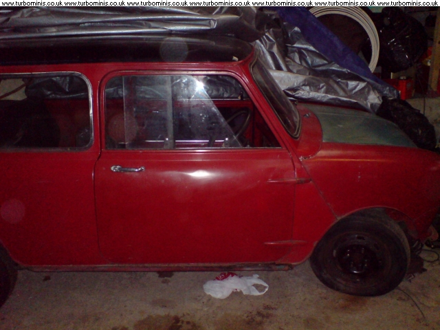

Yes there are definately lots of panels to replace to do it properly,
Not sure if I like the red, but my daugther wants a red one

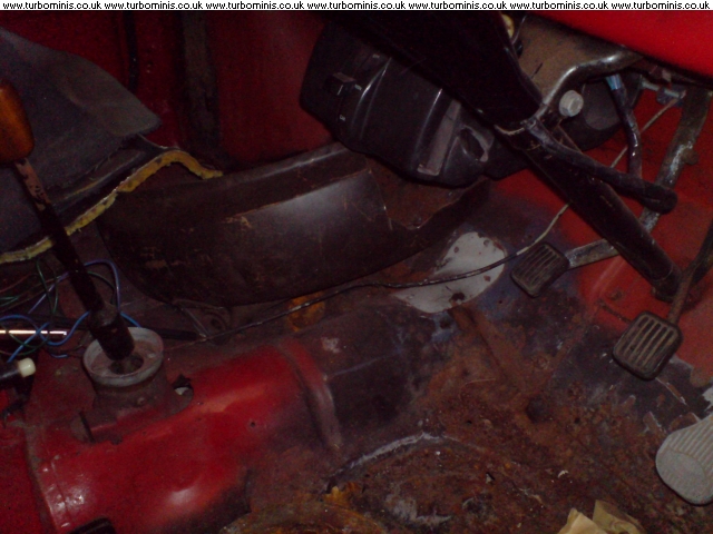

The outer sill and step is completely missing below the o/s door / apanel.
Will have to brace this one up before getting the grinder out lol.

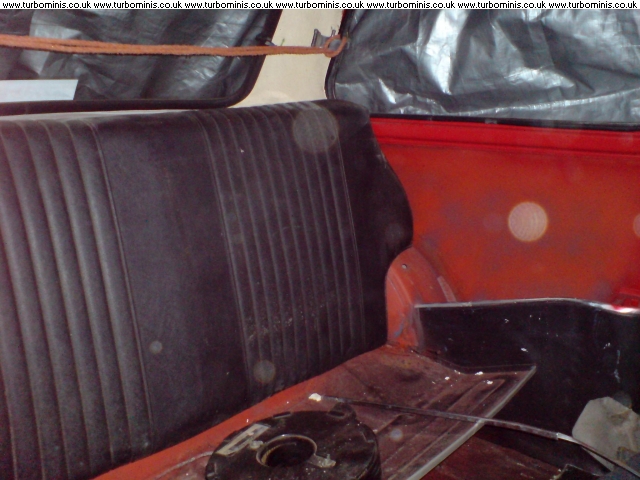

Interestingly it has a removable panel in the back seat bulkhead so I might look at getting one of these rotiseries or at least maybe fabing something up.
I understand what you are saying about keeping it standard, but I think I will upgrade the brakes to disc at the front as the old drums are liablity in todays traffic conditions imo. (the guy in front can stop but you can't lol)
