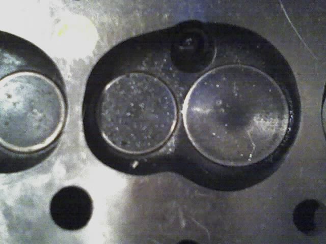

Looks like you could do with some metal out of the head. What size chambers are they?

not sure what size chambers, but the valves are 36 - 29
its ported to the max as well, was wondering about taking metal out. wil be runing just standard boost, with a 286 as well, hoping the turbo wil give jus a little edge over an na engine. its all built on a v tight budget with bits i already have. if it doesnt work its only a few hours to change the cam, or just build up my na 1400 engine *wink* have also got a minisport stage 5 head tucked away for the 1400 if the turbo all goes wrong...

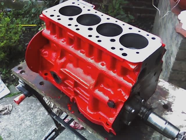

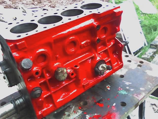

the block is an early leyland metro one with 20 k on it. the dish on the pistons is deeper than on an original mg metro turbo engine.... so think im going to stick with the leyland block

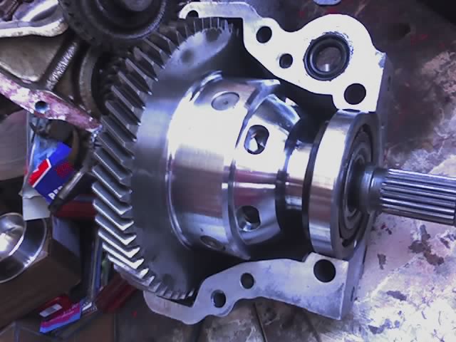

using that block, centre strapped, the head in the pic which i think is stage 3 spec, turbo oil pump, recon t2 on custom adaptor
tranx sccr gearbox with tranx sc drops, tranx 4 pin diff in the pic, race/rally clutch
