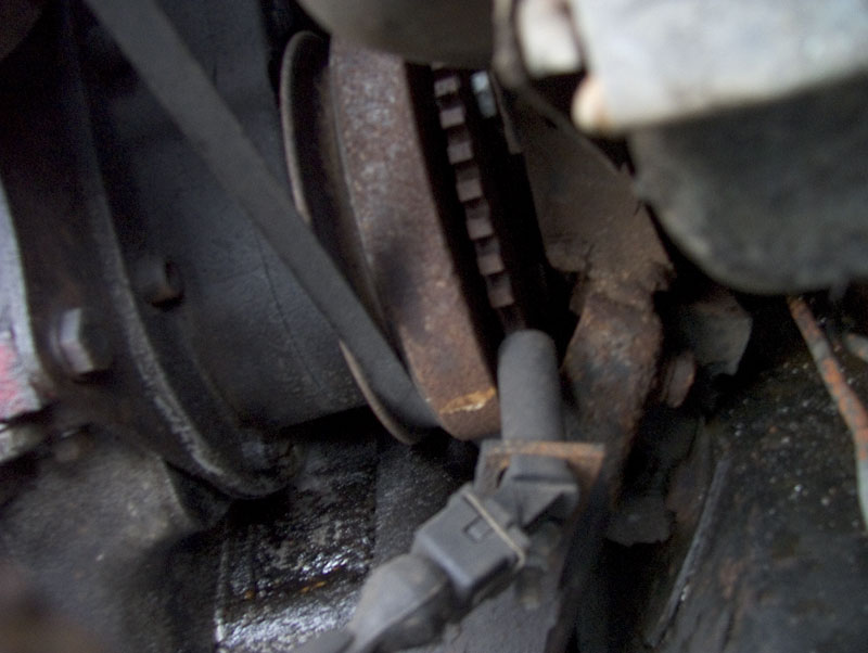

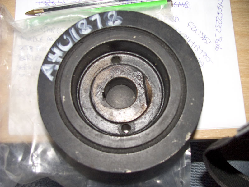

I bolted an Omex generic wheel to the standard pulley.
I used the two bolt holes already in the crank pulley with two spacers I knocked up. MPC in Walsall usually have the wheel in stock....

Please don't ask for dimensions as I've not got any, due to the use of make it up as you go engineering.
Basically Make up spacers and bolt wheel to the two holes as shown in the pulley photo.
Weld bracket to the steel bracket the engine mount bolts to. You may also need to modify the lower rad braket to give a little extra clearance. *wink*
I'd recommend drilling some large holes in the wheel to reduce it's weight / inertia.
Gavin :)
