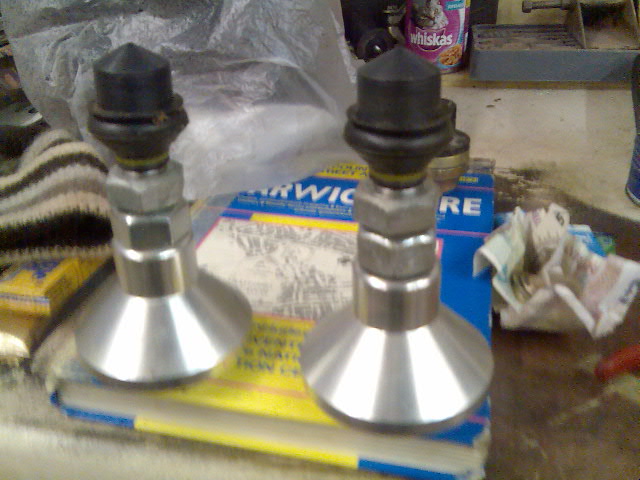

a pic of my hi-lo's & knuckle joints, they seem decent quality,
on there low-est setting as in the pic they were 3/4 of a millimeter shorter than the standard cones & knuckles i took off!!!
i've took it for a run over speed bumps etc etc made some violent turns to bed the new parts in, if it doe'snt settle lower i'll have to machine material from the thin end of the hi-lo & the threaded bar that goes into it wont i, correct me if wrong or there is a better method
Edited by clubminiflip on 7th Jan, 2007.
Your new shining hi-los are the problem.
The proper "Ripspeed" hi-los are the ones to use. They are much shorter.
Those pistured are probably longer than the standard trumpet when fully wound down. Cheap copies.
The locking nuts look rather chunky, if you're on a tight budget you may be able to get some smaller nuts from a hardware store.

is there suppossed to be 2 nuts? I would of thought the cones were tapped and then you lock off with just one nut?
My hi-lo's aren't locked off. i have drilled tower bolts and then adjust them from above on the front.
Iain i agree, to achieve lower ride heights i took off my lock nuts all together and they never adjusted on their own.
You only need one lock nut!!

I think one of those is the 'bolt head' and the other is the lock nut.
Some slim series nuts or turn down the current ones to about half their thickness.
'Bolt heads' could have the same machining done and you'd now be able to get the car on the deck.
I agree with Iain in that the originals with the loooooooooooooong allen key to adjust are by far the best for if you are adjusting them regularly, such as a competition car. For the road buying copies is fine so long as they are good copies. I normally use the ones Min-Its supply and have never had any trouble.

i've had these in my garage for just over 5 yrs & i did buy them from min-its haha *surprised*P the knuclkes i've just bought last week from minispares though, i'm not going to be adjusting the height much to be honest, i just want to get the car 1-1.5 inches lower than standard, i'd drop them another 1/2 inch again if i was going up the drag strip or going on a trackday, the locking nuts do look quite a beefy affair i thought, partly why i chose the min-its copys above others really,
rogerm!!! u are right one is the bolthead the other is the locknut, i could take the locknut off, i dout it would move due to the pressure on the hi-lo from the rubber donut, if ppl here are running there hi-lo's without the locknut with not probs i may go with that idea, seems an easy fix at the moment
i agree the ripspeed type are really nice, i have some but the cones are stuck to the donuts arrrrhhhh! they have grease nipples on too! they are'nt for my car tho really
