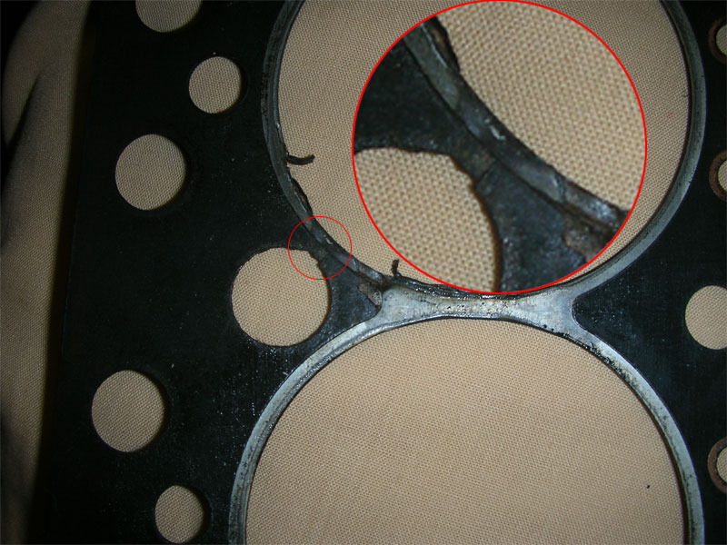

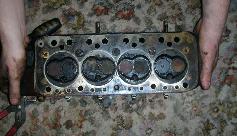

Thank fook! it was the gasket.
It's gone between one of the waterways and no. 3.

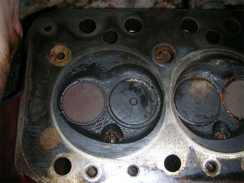

The head looks to be in good shape (to me, but i'm no expert) what do you think? should I get it skimmed? valves checked etc while it's off?

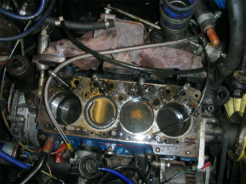

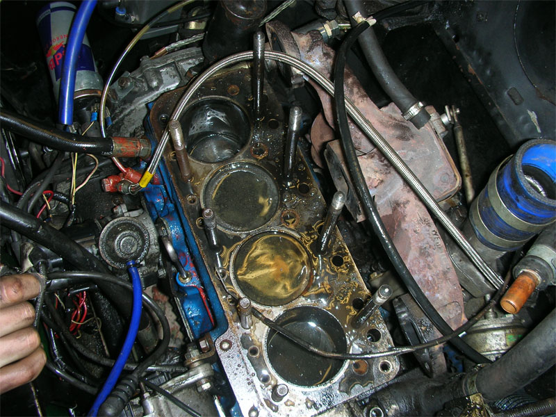

more pics

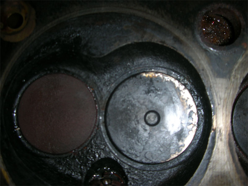

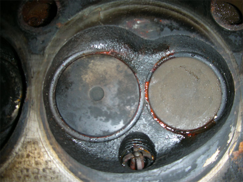

MMM, Ive seen that before. What was the coolant like, were you using any antifreeze and how old was the gasket?
I'd seen that on the 92 Cooper SPi that jackman and me pulled apart, the gasket had rusted almost through and the fire ring was starting to crumble in that area too. Still got it some where.
That's it.

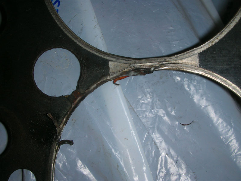

Let me know what you think

Looks to be another issue other than an old gasket rusting because of lack of antifreeze(inhibitor)
Though VERY similar in apearance, this gasket here, sufferd more damage to the fire ring.
A fire ring is the bit thats exposed to the combustion chamber.
Baisicaly its the silver metal rings around the cylinders

I'd strip it, get it chemically cleaned and the surface checked for true. Then rebuild it, lap in valves etc. Could save you more work later on....

do you think that I should get the surface of the block checked as well?

Not really, from the look of the gasket I don't think you've got much to worry about.

personally id just clean up both surfaces with some petrol until theyre spotless, pop a new gasket in, change the oil and water, set tappets and off you trundle

IMHO detanation has caused this tired gasket to fail!

running tooooo lean with the extra air the cam is giving it needs a rr setup! prob also has too much advance in the ignition timing .

defiantly looks like det caused the failure
