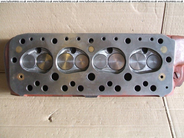

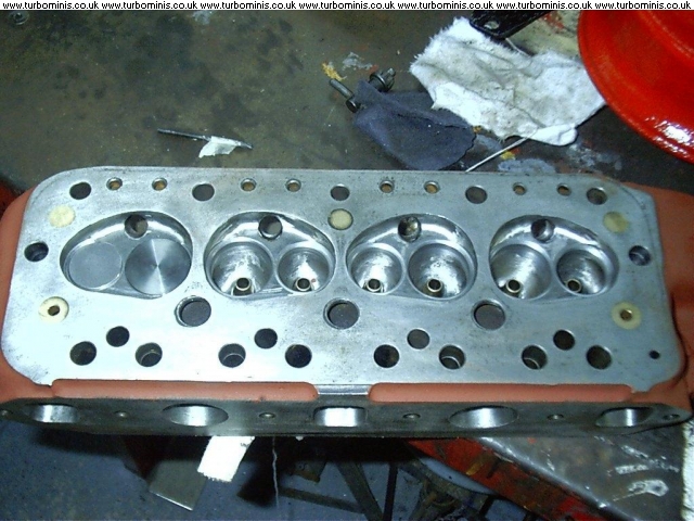

Just wanted to say a big thank you to Steve and here are a few pics
The head spec is
Benross Racing Porting Matched to mainifold.

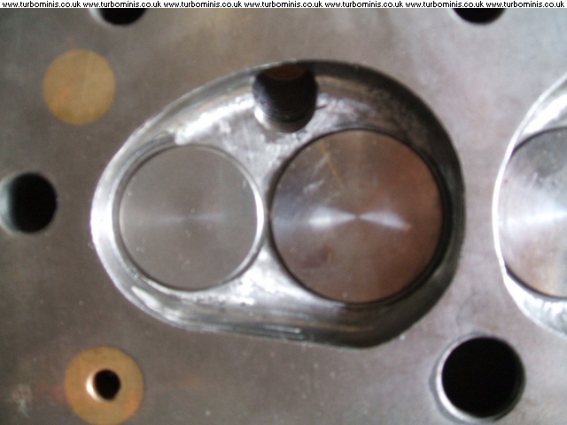

Chamber shape similar to avonbar hi boost de beaked, but with valve seats sunken 2mm more into head and roof of chamber milled out to give increased combustion chamber size whilst retaining good squish band. (Hand grinding by Benross Racing).
Chamber volume 28cc.

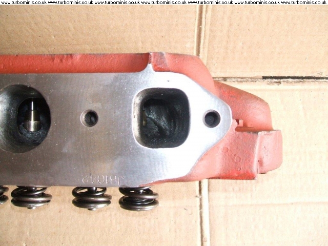

Minispares stainless steel race valves 36.5mm x 29.5mm
New bronnze valve guides, centralisers, minispares 185 lb springs and spring shimmed 2mm due to sunken seats.
11 Stud conversion.
Leaded.
Repainted
Valve seats recut and ground in.
Its a fantastic job and really was well worth the money, Steve did the manifold and elbow too
All in all an excellent level of work man ship, and finishing. Standard as good as you would expect from all the big tuners.
I'm really happy with it. *smiley* Many thanks Steve and thanks for all the advice and edis bits. *smiley*

Great work Steve, looks just as good if not better than mine from a main tuner.
Top work
Dangerous
2521 Posts
Member #: 417
Looking good,must get the BENROSS elbow to go with it !
good job steve!

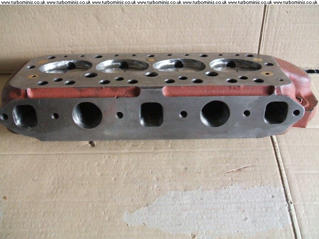

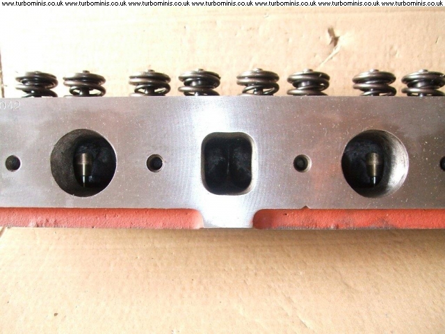

Looks like a damn fine job, reall nice.
Are the ports out all the way to the seat of just blended at the manifold face?

Yep its certainly is a cracking job, Steve did the manifold and elbow at the same time, ports were taken out to the turbo gasket.
You'd have to ask steve about how much was done inside, but it looks like a lot...to make up for the 36.5mm inlet
