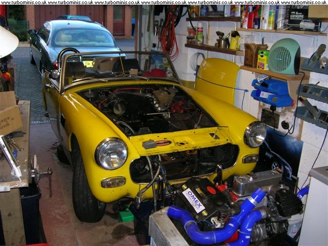

So how do I get all this in there?!!
Sorry guys cant seem to attach pictures,you'll have to look in 'midget' file in photographs.
'Where does the engine go?'
here you go:

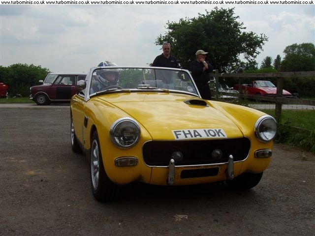

I see you've been to curborough, doing a double lapper too by the looks of it.
Nice car

Thanks,yes we do a mad day there once a year.3 laps of the top bit,timed on the hot one.About 20 cars,so 6 goes each.Everything from aTR7 with T16 turbo to Peerless (what?) to Elise to (MGB GT also T16 turbo).
Great picture of the shorty.
First time I saw it, I spent 10 minutes trying to work out where you had put the engine! DOH!

Looks like it will be a very neat install !
Keep up the good work *smiley*

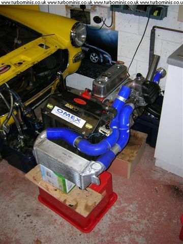

Where will you put your aircleaner?
steve1275
864 Posts
Member #: 951
Bromsgrove
Hi Arno,
I have a green cotton filter which will go alongside the charge cooler pipes.I have already cut away a lot of the left front bodywork,but the nibbler may be needed again!

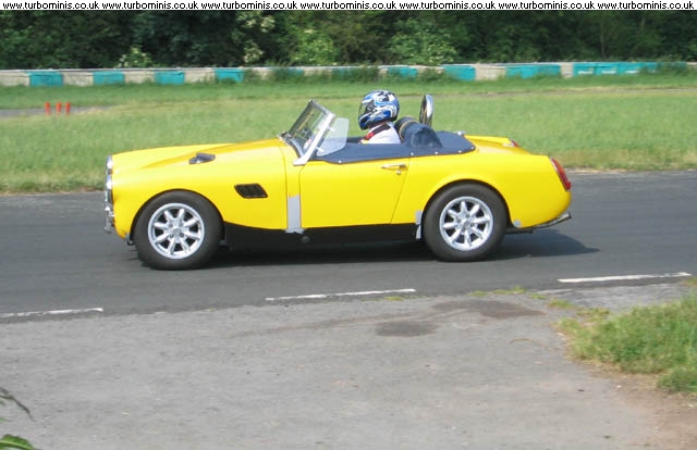

Stupid q: are these fwd or rwd?
iain
8506 Posts
Member #: 16
Near Lincoln
RWD mate *smiley*

i like your side vents, I have some subaru bonnet vents, mind copying your side solution?8)
steve1275
864 Posts
Member #: 951
Bromsgrove
Sorry been away,only just got back.the side vents are plastic from Halfords,but not too strong.I'm making new bigger cobra style ones now.
