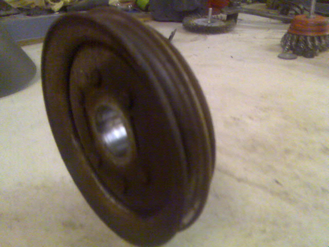

i'm unsure what route to take with the leads as i have another lil concern
as in
does my 998 not have the rubber damper in the bottom pulley
what type of pulley is correct for my 998 running megajolt, timing scatter is going to be better for sure anyway so thats not a concern really, i'm unsure whether to get a bolt-on/machined trigger wheel?

right i've been having a squizz, looking at my options & i think a bolt-on/weld-on trigger wheel that fits to mine is my option with the standard 998 pulley wheel, what you reckon chaps? i dont have a damper type & dont really want to buy one, is this route ok to take? cheers chaps

Got me all confused now ... post up a pic of your pulley and i'll try to tell you what will work for you.
The std 998 pulley is a solid pressed steel thing with no form of damping and nothing to machine a trigger into.

Ok, been a very long time since I have had a 998, at least 15 years!

this is the pully on my 998, what method of trigger wheel should i take?

I have had those come apart as they are only riveted together and not the strongest things in the world. It would be a shame to set everything up with one of those and have it fail (I'm not saying it will). I know Minispares sells new 1275 ones that are what most use for MJ etc.

I think you'll be better off with a 1275 type pulley to. Second hand one maybe???
998 Metros use a pulley with a damper that can be machined. I'm using one on mine.

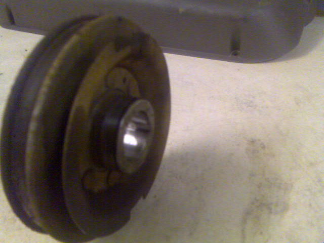

now i know this does'nt seem to be the done thing but i think i'm gonna take the option of a bolt on/tack weld on trigger wheel like the pic below, plz advise, what are the benefits of the dampered pulley?

Can you get a socket on the crank bolt?
