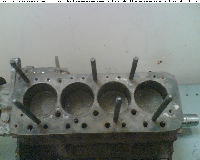

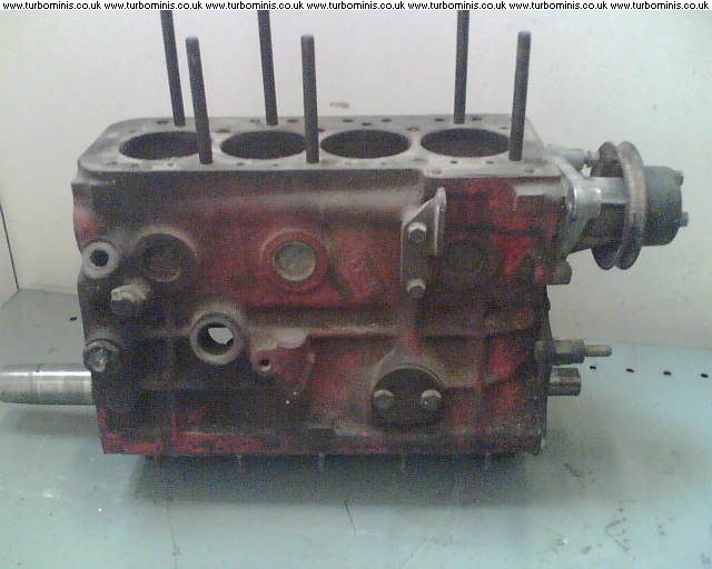

Haha collected my block yesterday. :)
Bores look really good, shouldn't make to much difference as it will be going 1293 anyway!
One thing I noticed was there is no oil filter just a blanking plate, did rover do a standard remote filter arrangement at some point?
Ive got various sized cast plugs with quare lugs on the top, so planning to countersink head, wind these in, then braze them up!
Edited by matty on 13th Feb, 2007.
What the fudge is with the oil filter blanking plate?
Wierd
how does oil get to the main gallery?
pass!!!! It looks like a standard part which is strange, or its just really well made, whatever can't see its use apart from for storage?
the hole centres on that plate don't just happen to be the same as the fuel pump do they?
I like your thinking but...
Oil filter centres 38mm approx
fuel pump 44mm centres approx?
