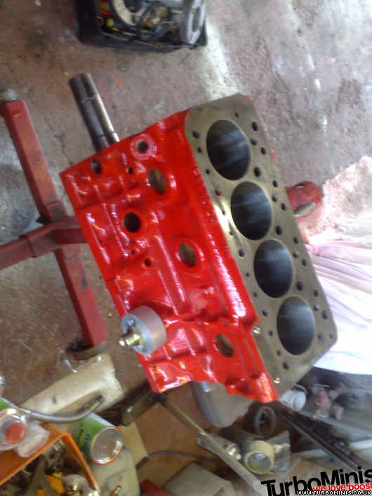

What have you used for the block take off Mike?
This mate.
