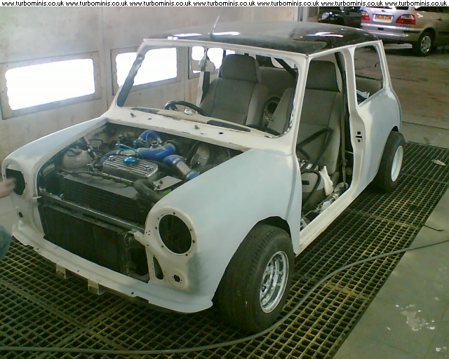

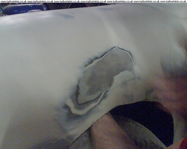

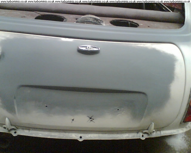

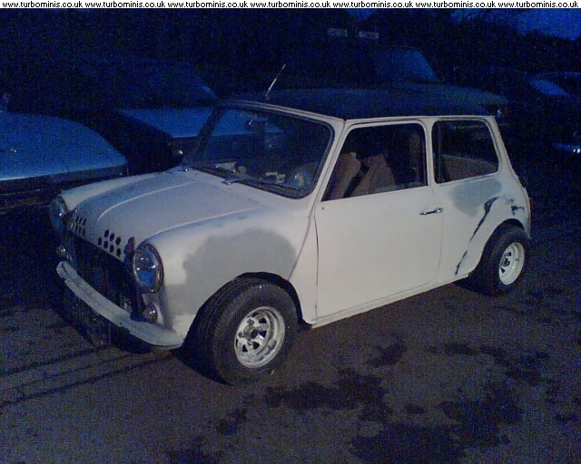

Most of the work done on this was to sort out the arch holes, as they were all over the place from where different arches have been fitted, some of the holes were limiting where they could be placed as the un-used holes would show, so I decided to get them welded up.....
Decided to fit a Mk1 number plate light instead of the normal jobby!
This is as far as ive got with seven days to go...LOl...I can sense some real late nights.

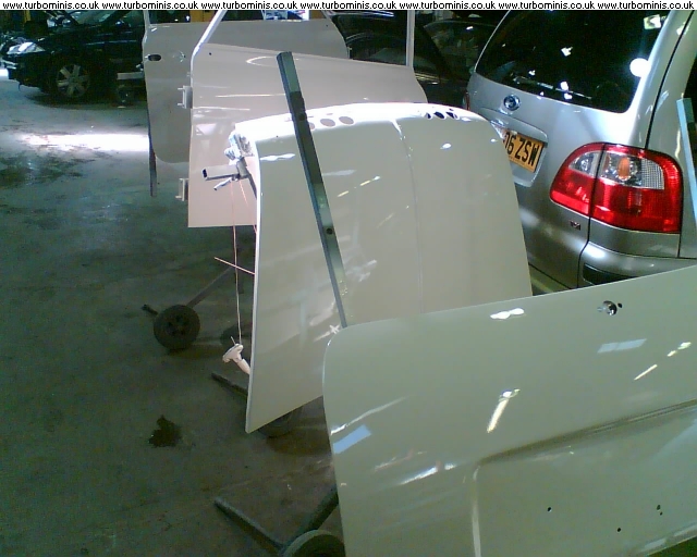

The parts being sprayed are,
External surfaces (NOT roof)
Bonnet both sides
Door shuts
doors all over
NOT doing arches or rest of inside as its not needed!

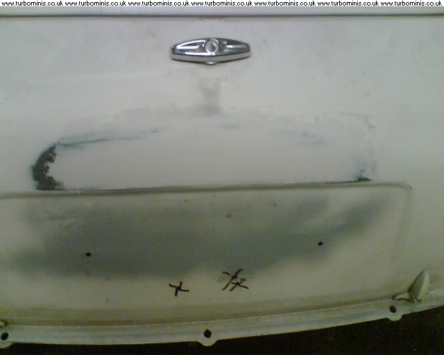

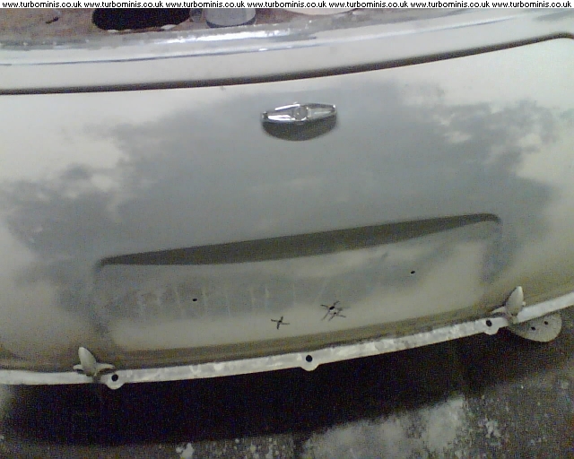

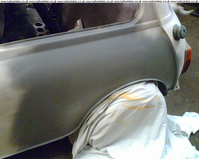

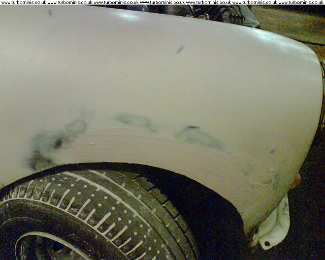

Did a bit more work to it Saturday, managed to get the boot and rear quarter finished and flatted ready for paint!

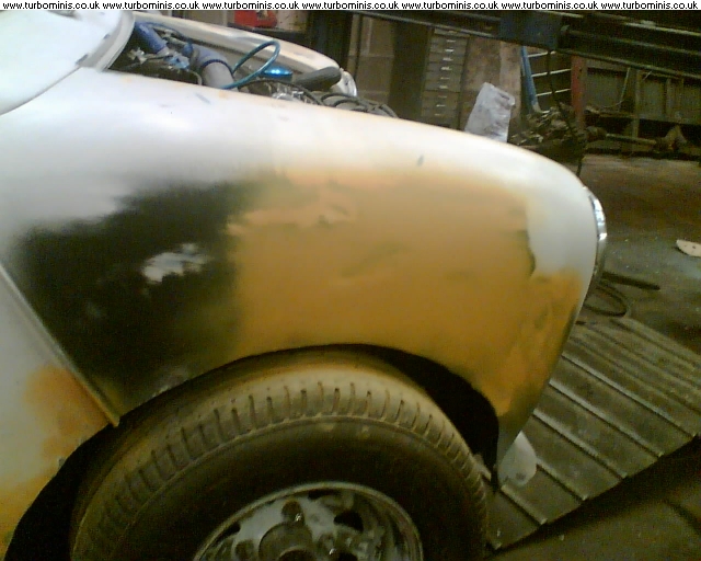

After spraying the front wing in matt black and flatting it, a few high spots appeared, but an introduction to my panel hammer seemed to see them off pretty sharpish, will have a look at it agian tonight to check!

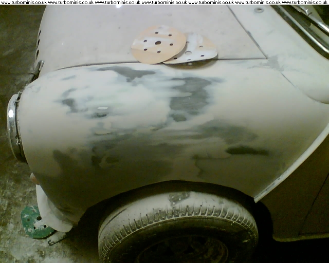

Ive come to the conlusion I had no feeling in my hands what so ever!
The panels I thought were straight, weren't!
A bit of thin lint free cloth helps loads to pick out any imperfections, seem to be getting somewhere with it now, thank god!

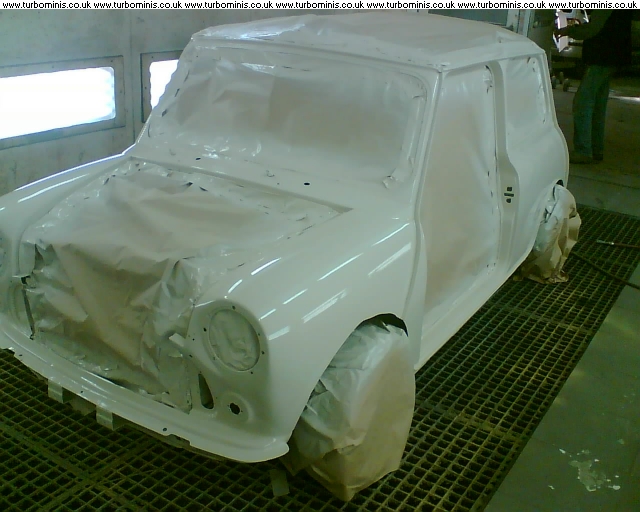

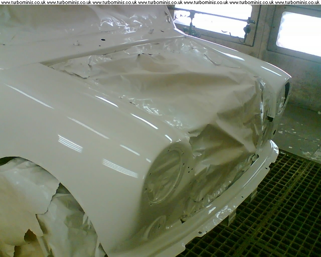

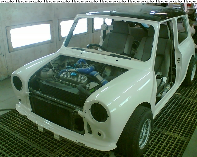

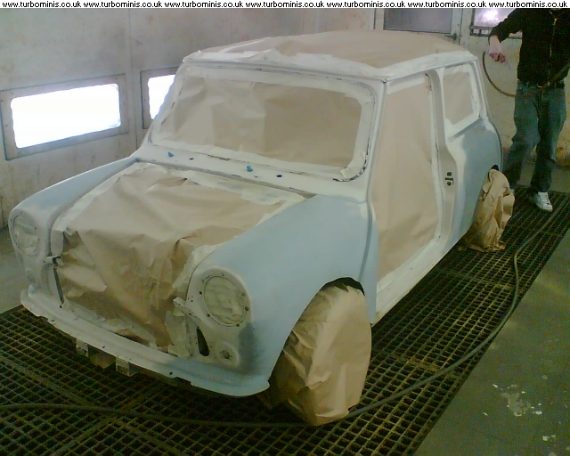

Here's the results of my weeks of sanding! Lol
All went to plan on the day, apart from me having food poisoning and spending the majority of my time toilet dashing! LOl

Looks fantastic.*smiley*
Rememeber to give your self plenty of time to reassemble, one scratch and you will kick your self
Looking forward to the finished pics
