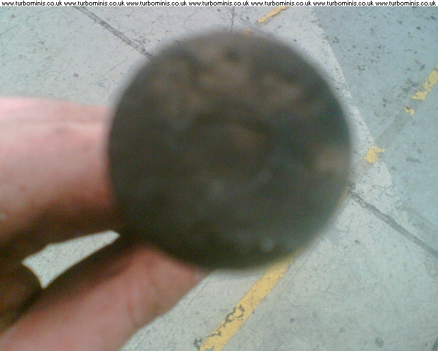

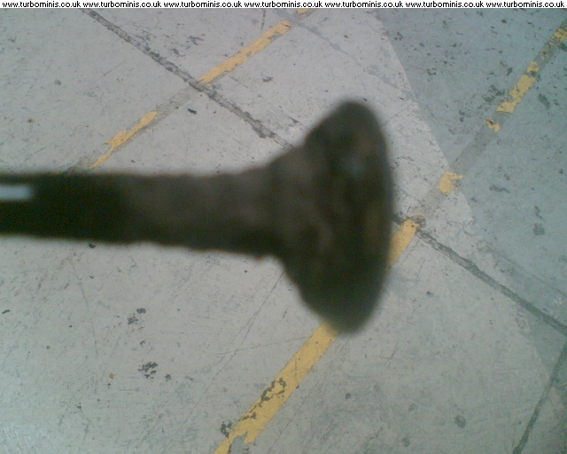

Ive never seen any valves as carbonised as this and even with some gentle scraping it still won't budge?
The inlets clean up no problem, only light carbon on them, but the exhaust valves seem to be a mix of carbon and calcium build up?
Sorry about the pics, wanky camera phone wouldn't focus.
Any tips, or if you could recommend some good cleaning jollop. Would be much appreciated.
Oh yeah the head is aluminium and coated the same around the exhaust valves aswell, as there a but more difficult to reach a suitable cleaner would probably best rather than relying on elbow grease, any recommendations for this aswell Lol!

stick the valves in a drill then touch em with some wet and dry. thats hows i've done em in the past anyway.
I know what your saying but TBH mate, not sure if that will touch them, the carbon is really hard and will pobably rip the wet and Dry before cleaning.
Tried a soft wire brush in the chuck and held the valve against it, doesn't budge!

Get an old hack saw blade and cut it square. Use the flat edge to scrap of the worse of it then swap to the wet and dry.
Even if you get the carbon off you'll need to have the valve's seat ground. Have them bead blasted and ground professionally. Just hacking that carbon off, and installing them back in the head is just plain stupid.

soak in oven cleaner i reckon would help soften it up.
Either that or get them fooking hot and it will all fall off.

I cheated and dumped the wholw head in a vat of carbon dissolving liquid at my local engine builders *wink*
Mind you it still took a 24 hour soak to get it off!

try the swarfega degreaser you can get in halfords in 5-litre bottles. i left some valves to soak in it over a few nights and it chewed the carbon right off, had same problem as you!

angle grinder with a wire wheel will remove any carbon no problem.
and be shiny to boot
