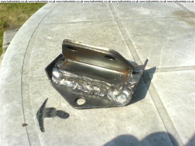

I managed to make some (rear) front solid mounts using the original rubber mounts. See photo/link below
To seperate/remove the rubber I just used a knotted wire brush on my angle grinder, after being covered in rubber particles and the odd bit of smoke I was left with the mount in two pieces and no rubber.
I then just welded in between the two enough steel to the equivallent thickness of the rubber.
I've never heard of this being done before, can anyone see any problems with it?

looks good,
I've done similar with metro subdrame mounts,
I Put a big dab on at each end with a mig to keep the thing in alignment (by this time the thing is well smoking!!)
Then give it a good squirt with the mig on full, the rubber catches alight and coninues to burn until its all powder. Then its a simple case to weld the rest up.*happy*

You might want to add a couple of gussets to the mounts, whilst they'll probably be more than up to the job as they are a gusset or two can't hurt.
