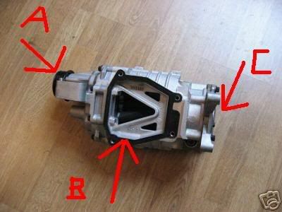

ok i been searchin a little, correct me if im wrong but i worked out
you would use an LCB
A goes to a carb
B is for an inlet
C somehow goes to a pulley
how far from right am i?!

A is the pulley
B to inlet manifold
C intake (from carb if suck through)

sorry to vear back on track to the subject, but im still a bit (haha) confused. if the carb goes on the bit marked in red, what goes on the bit marked in yellow??
or due to the fact you can see mateys shirt whose holding it, is the yellow bit just a mounting plate....
I believe that is for the water pump inn the Bini S. You could pull it apart, and remove the gears if you wanted I guess.

blanking plate. thats my plan. don't need it but you don't want dirt getting in so blank it off. Well my plan is to make a plate that covers most of the end of the charger with a pipe welded on for the carb to feed to. if that makes sense.

yes it does *happy* cheers
